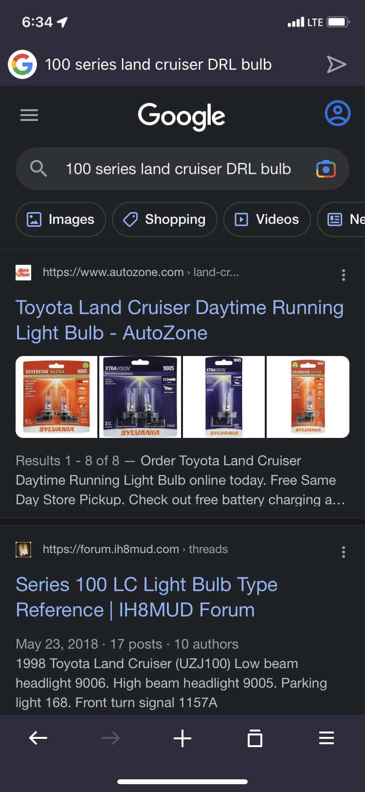

The model number on the DRL light bulbs are worn and auto parts web store isn't giving me an accurate model for DRL. What is the correct model number for the DRL lights?
9005

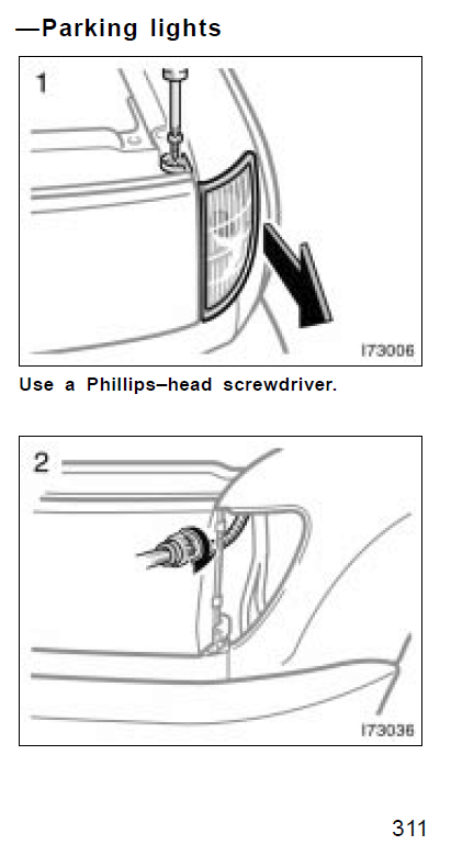

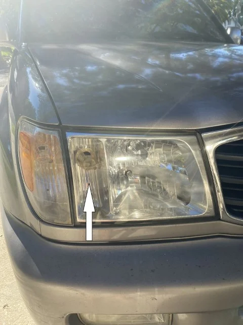

I must be mistaken then...i always thought this was the DRL. If not what is it called? I could not find it in the owners manual. What is the bulb model?
It is parking light but incased in the headlight assembly. Bulb 168. The turn signal in above diagram is adjacent to parking light.
