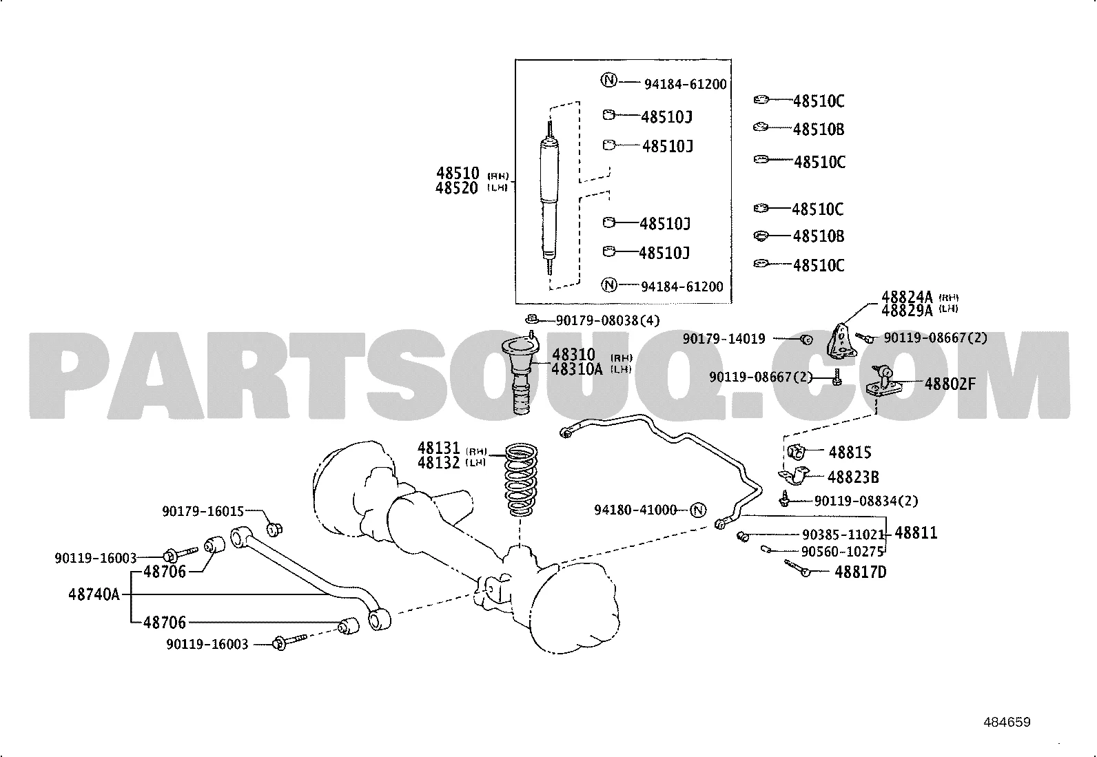

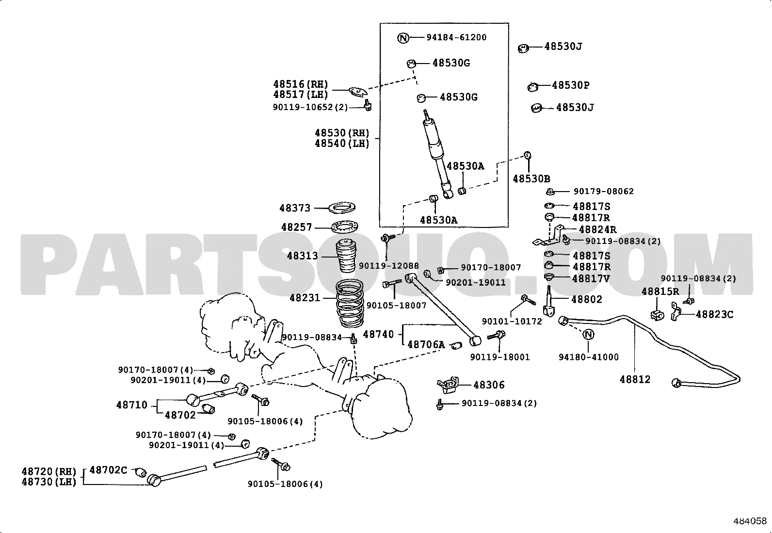

I have a 1995 FZJ80 and I can't seem to find the numbers for the front and rear lateral control arm hardware. Bolts and nuts, mine are rough as hell and need to be replaced with the bushings. Any help would be great.
Front:
Rear:
