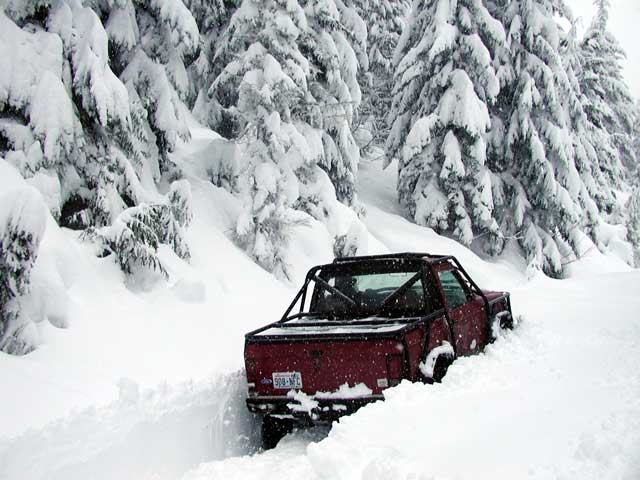

Nope just what I said:
If you look at the Icelandic trucks - they can wheel in the snow.
If you look at the Icelandic trucks - they are heavily modified.
Here is a linked pic - not from my run, but one in the same conditions:
http://www.broncoii4x4.com/jackspass/jackspass-59.jpg
