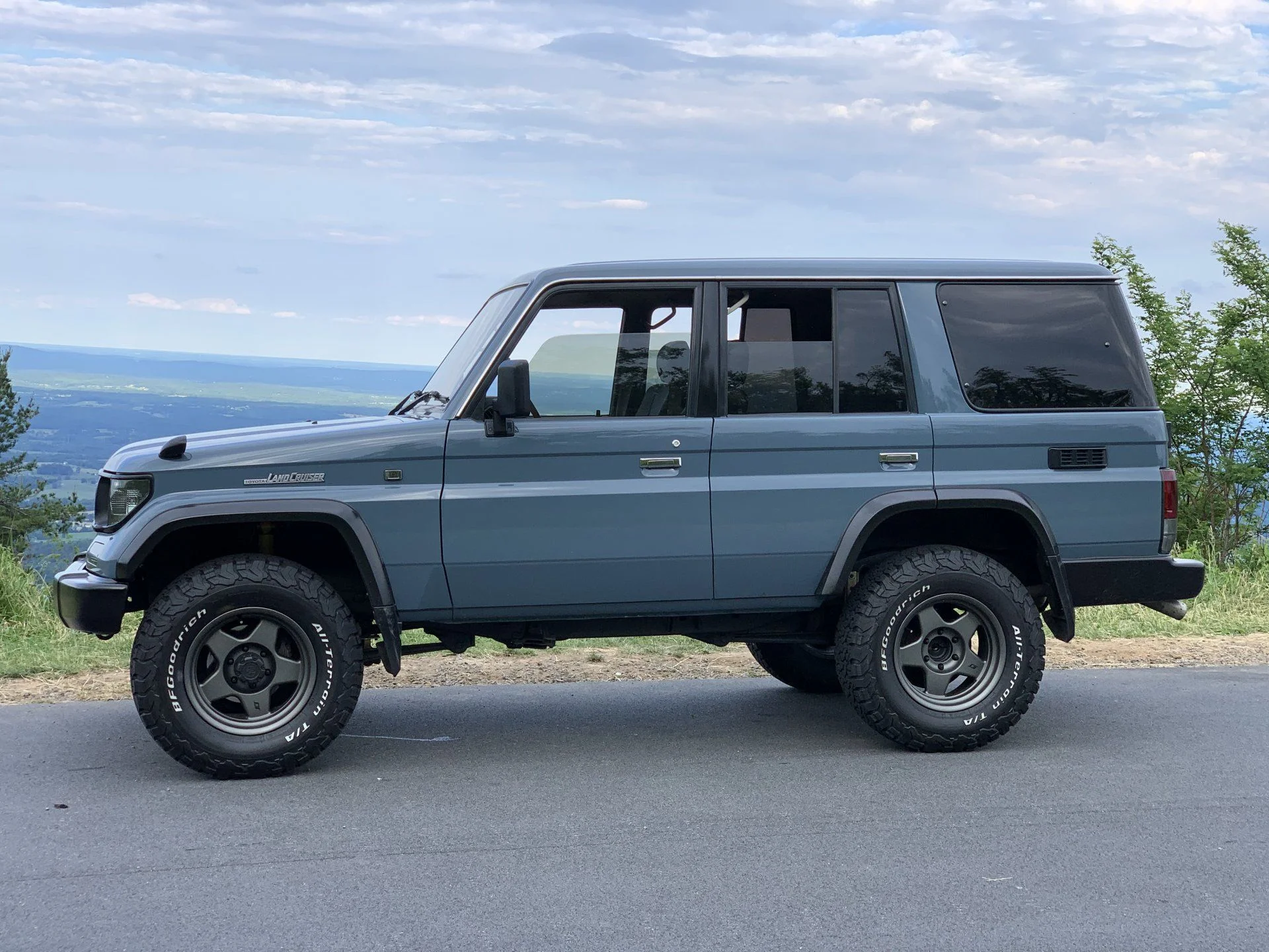

In addition to a modest lift, these rigs really look good with 33-inch tires and 1 1/2” wheel spacers to help fill out the wheel wells.
I think Dobinsons do make a standard height kit. But with a 2 inch lift, it slowly sages towards it original height, rather than below it
For 6 people, a 2inch lift would work well.
60 mm Dobinson lift. Add some 33 x 10.5's

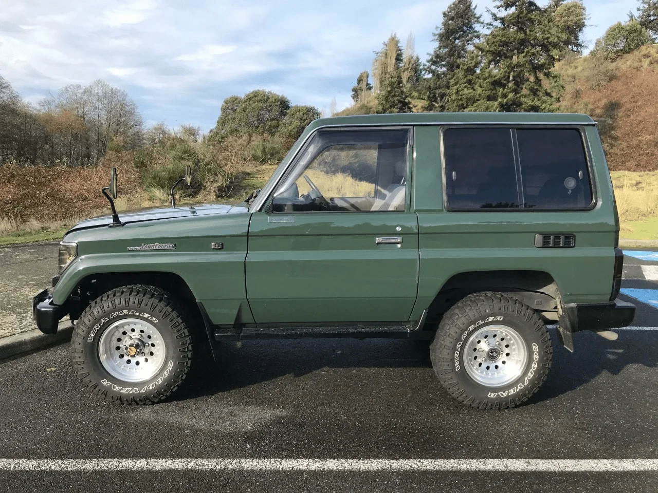

I have a SWB kzj71, so I'm wondering how the smaller wheelbase will affect the ride height after the lift.
I think good quality shock absorbers will be the key. The SWB landcruisers. or any SWB can bounce around and although the springs will play a role, it will be the shock absorbers that stop it bouncing.
