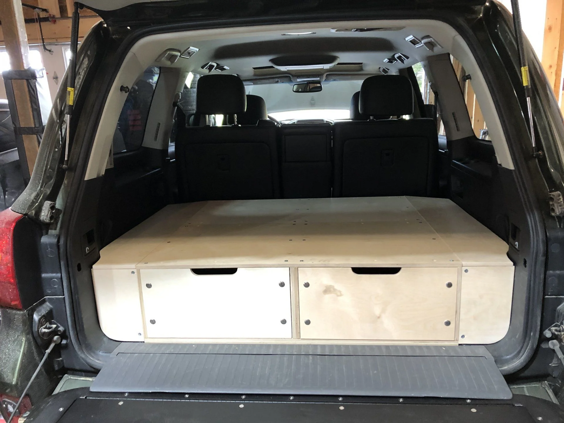

I have a Landshark Reef dual cargo box system that comes in unfinished baltic birch. I threw some vinyl wrap material I had kicking around he shop on the drawer fronts as a temporary covering, but want to do something more permanent.
Has anyone here tried laminating a sheet goods to the surface? Kind of like how I imagine you might laminate wood for a counter top - maybe contact cement the drawer and the sheet stock, once it sets up attach the sheet stock, use a hard roller to press it down, and then, once it cures, use a router with a guide bit/laminate bit to clean up the edges?

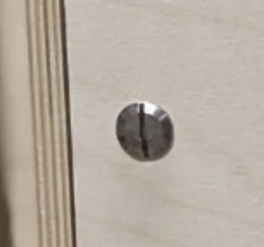

Ok. I took a look at the Landshark website with the Reef 40's. Does it have 4 flat large washers that protrude a bit on the DW face? Or is the DW face completely flush?
They have four large head screws that (if I recall correctly) go into regular drilled holes. And you are correct, they protrude. I would imagine the laminate going under the screw heads.
:popcorn: I haven't made my drawers yet but was thinking of using a spray on bed liner paint of some kind. I never thought about laminating like a cabinet or kitchen counter. Eager to see how this turns out.
So just the DW faces? Or do you want to do the the entire face? Here is where I'm going with this. Your going to need something about a 3/16" - 1/4" to cover those caps protruding on the DW face. Your going to have to go a little thicker with the laminate so those caps don't telegraph. What that means is once you put the laminate on the DW face only the DW will no longer be co-planer to the face. But if you have a small router you can put a 45 degree bevel on the DW face. Or do The entire face so all the material is the same thickness. That is a lot more work. Or if you can adjust the stop depth on the drawer its a mute point....

I would think about your use a little. If you laminate something on, you may eventually have to deal with broken or peeling corners and edges unless you round over the edge a little This is a a reality of the kind of use that drawers tend to get in our trucks. Even with a round over, you may get edge breakage over time.

If possible, I'd like to do the whole vertical surface. I do have a router. I was thinking that I could also potentially countersink the screws into the ply of the drawer face (with a forstner bit), so the laminate sits flush across the face.
It might be a bad idea, who knows... might be worth a try though...
I don’t think it is a bad idea at all, but beware that if you use something like titebond (which you should), there will be no going back and it will not just come off like it would with contact cement. Titebond will be stronger than the original wood fibers and it will be permanent.
Any reason why you would prefer a separate surface rather than a paint on type finish?
Yep your on the right track. Counter sinking those posts are exactly what I was talking about. I'll poke my head around the shop tomorrow for something that will work. Right now my thought is industrial flooring like they use in a hospital. It is very hard, durable, stain proof and self healing for cuts. Can be polished as well.
