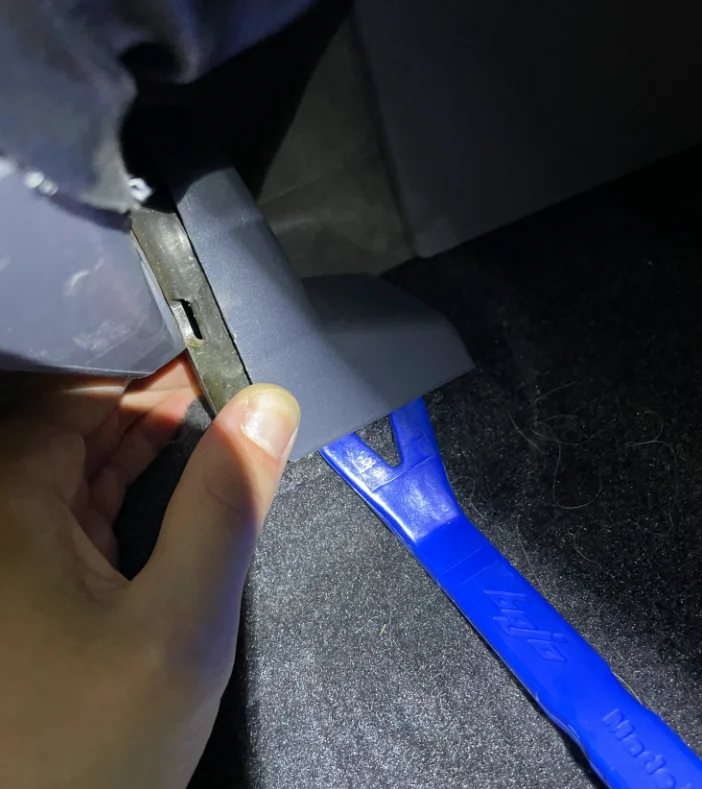

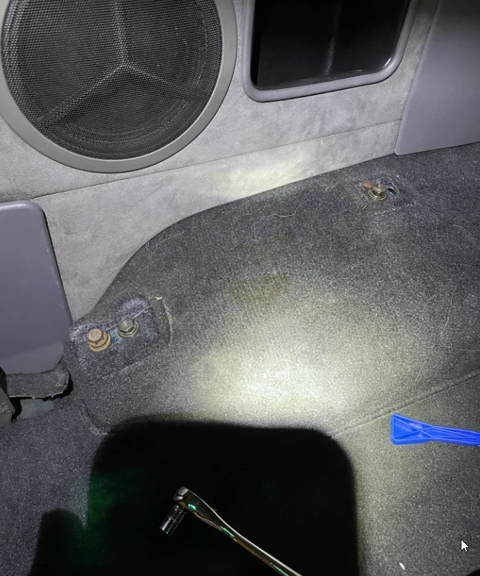

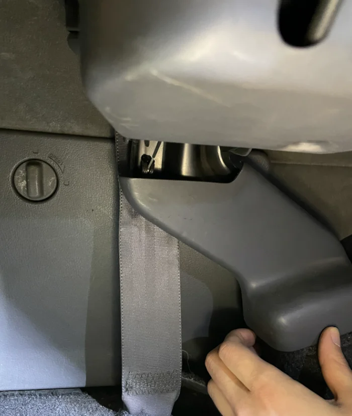

Since you found it helpful I'll just share the content here for future people in case i move the link:
  1. Pull off the plastic cover of the rear piece. Should be easy w/out tools
  2. With a tool, remove the front cover. Come at it from the body
  3. Now they are removed. Remove the back ones first and then the last one being the front. Use a 14mm socket
  4. Cover the holes with the nuts for safe keeping
