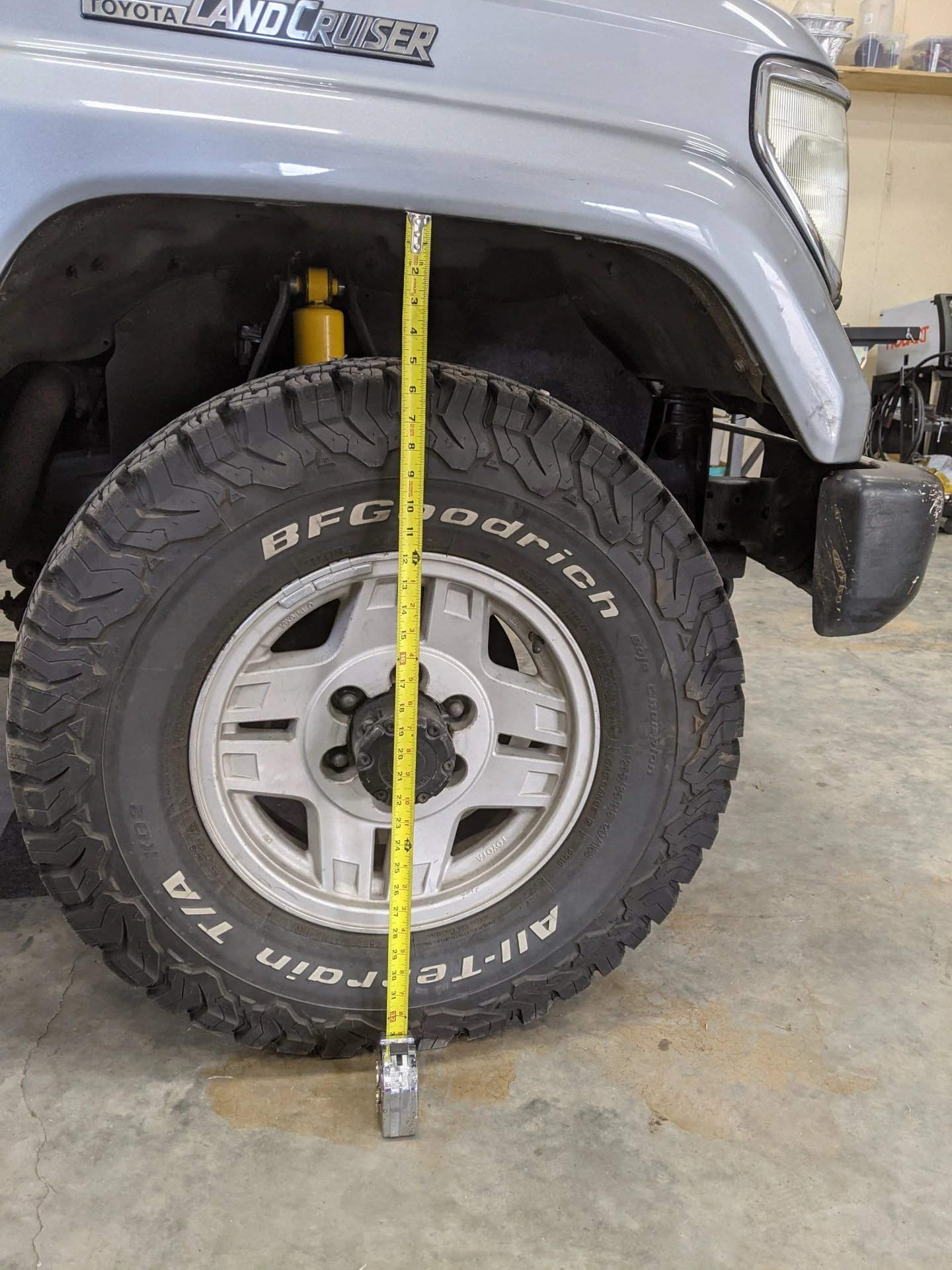

The OME kit was about 30mm front and 60mm back. Dobinsons was 60mm front and back. No, you don't need to extend brake lines for that lift. In fact I have a 100mm lift now with stock brake lines and it's been ok, but I should probably get to it sooner than later.
