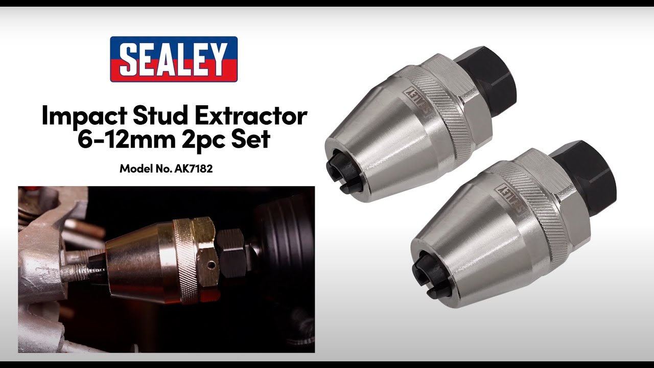

Search for Stud Puller (or Extractor) Tool there are different types, one type often comes in a kit of 4 different sizes, they look like long sockets but have grabbers inside. IME they work well if the stud isn't rusted or Loctited in place.
Another type has teeth that bite into the stud, better for a stuck stud IME.
Multiple companies make essentially the same thing, OEM brand can often be found at an US Autoparts store. I don't recommend the Performance Tool brand, looks exactly the same as the OEM tool but more cheaply made, the jaws/teeth appeared to be cast metal and all fractured removing a few diff carrier studs. You want the tool with hardened steel jaws/teeth.
Easiest if you have a compact cordless impact wrench, you can zip it out in two seconds with the impact and the puller tool.
This video background music/narration sucks, but it shows how they work.
Better video:
Stud Extractor:
