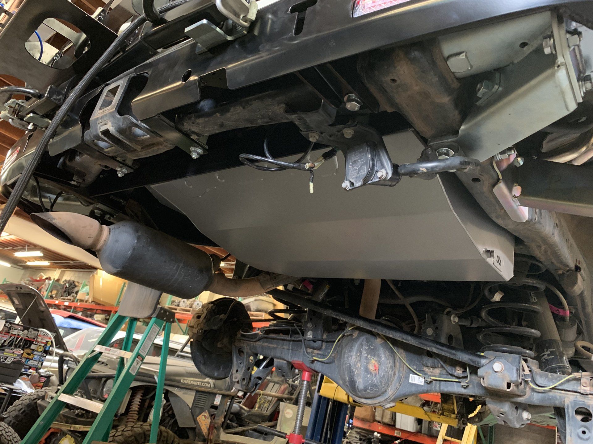

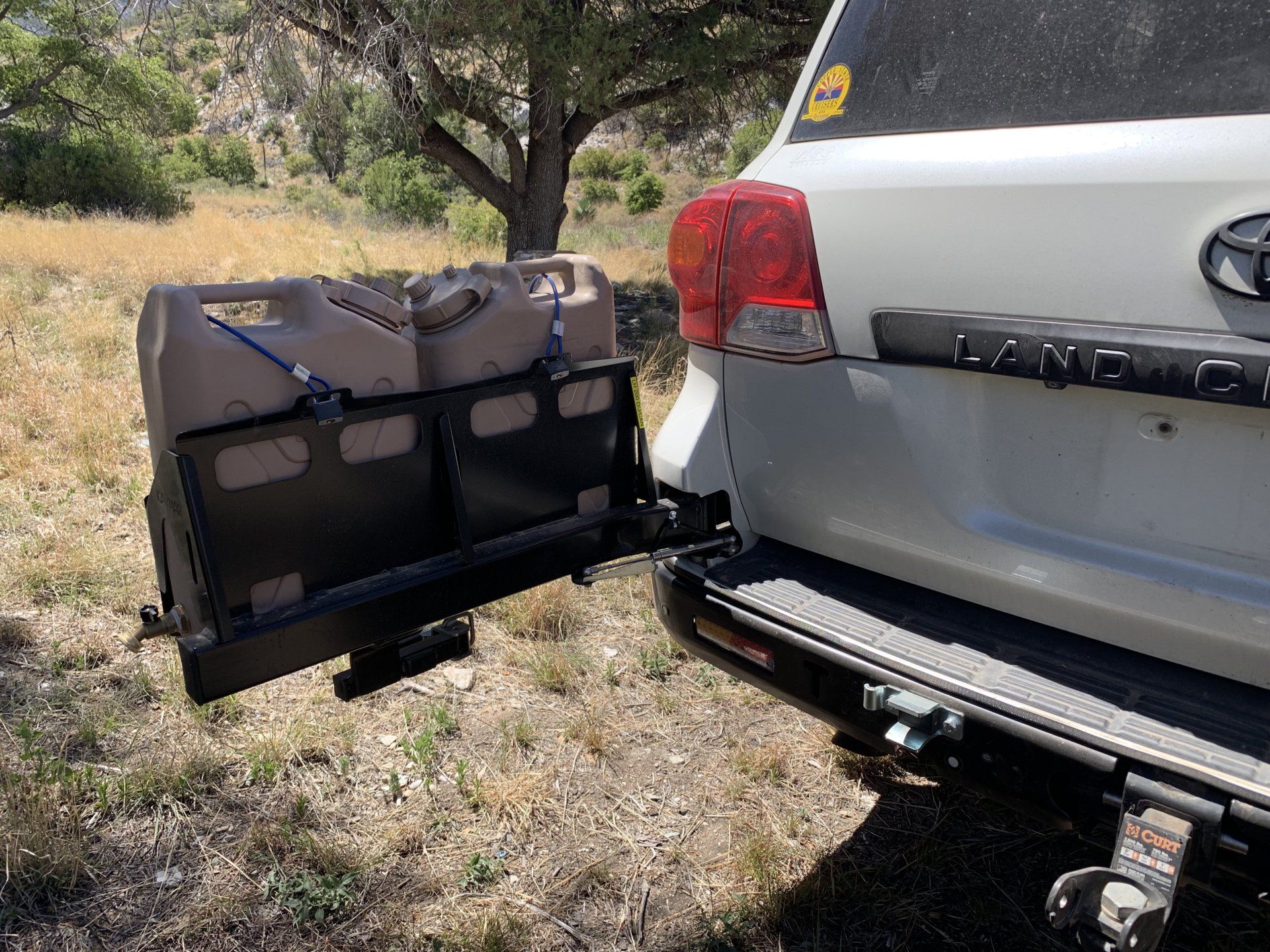

Just wanted to post some pics of my new rear Kaymar bar and Long Range Automotive 24 gallon auxiliary tank. I really want to thank @orangefj45 and @wardharris for making it happen. And to The guys at Valley Hybrid on the excellent install. It was worth the drive. I love the bar and its pretty nice not stopping for fuel.
A few more. Also had Valley Hybrids install Terrain Tamer Brake pads and rotors. Now just need to upgrade the rear springs. Going to try ARB 2723s

Jerry can are better than nothing...but let’s face it...they are a pain, and we’d much rather stop at more stations than fiddle with cans. The LRA changes all that. You actually use your entire main...no mess...and you easily cycle through both rather than eventually feeling compelled to use jerry can fuel.

Ya, I might have done the 40 had I seen how tucked it is. But I did mine pretty early in the release. Wondering if the 40 is armored like my 24...it could even smooth out the scrape path to a rear bumper & help the rock slide on by... :meh:
I think a 34 gallon (or so) tank would be just about perfect as I’d wager it would tuck completely...where the 40 is just a wee bit low.

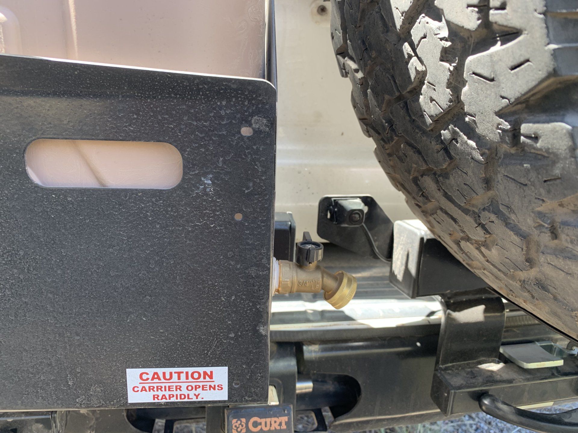

Do you have additional pictures and detail of how the swing arms attach to the vehicle? I am interested in adding two swingouts but don't need the bar. I was told the bar was required for US vehicles to maintain the parking sensors, but I have seen some trucks overseas with just the swingouts.
The swingouts are attached to spindles which are mounted on brackets attached to the frame. You can see the silver brackets above in post #9. I can also get you some more pics. I'm sure @wardharris or @orangefj45 can give you options. Still love this bumper!
