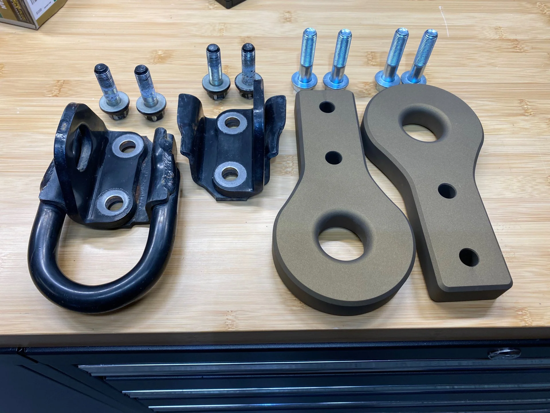

Is anyone running the Kaon recovery hooks instead of the Warn version? Thinking about giving them a go but I wanted to make sure there wasn’t some complaint or reason why I don’t see them.

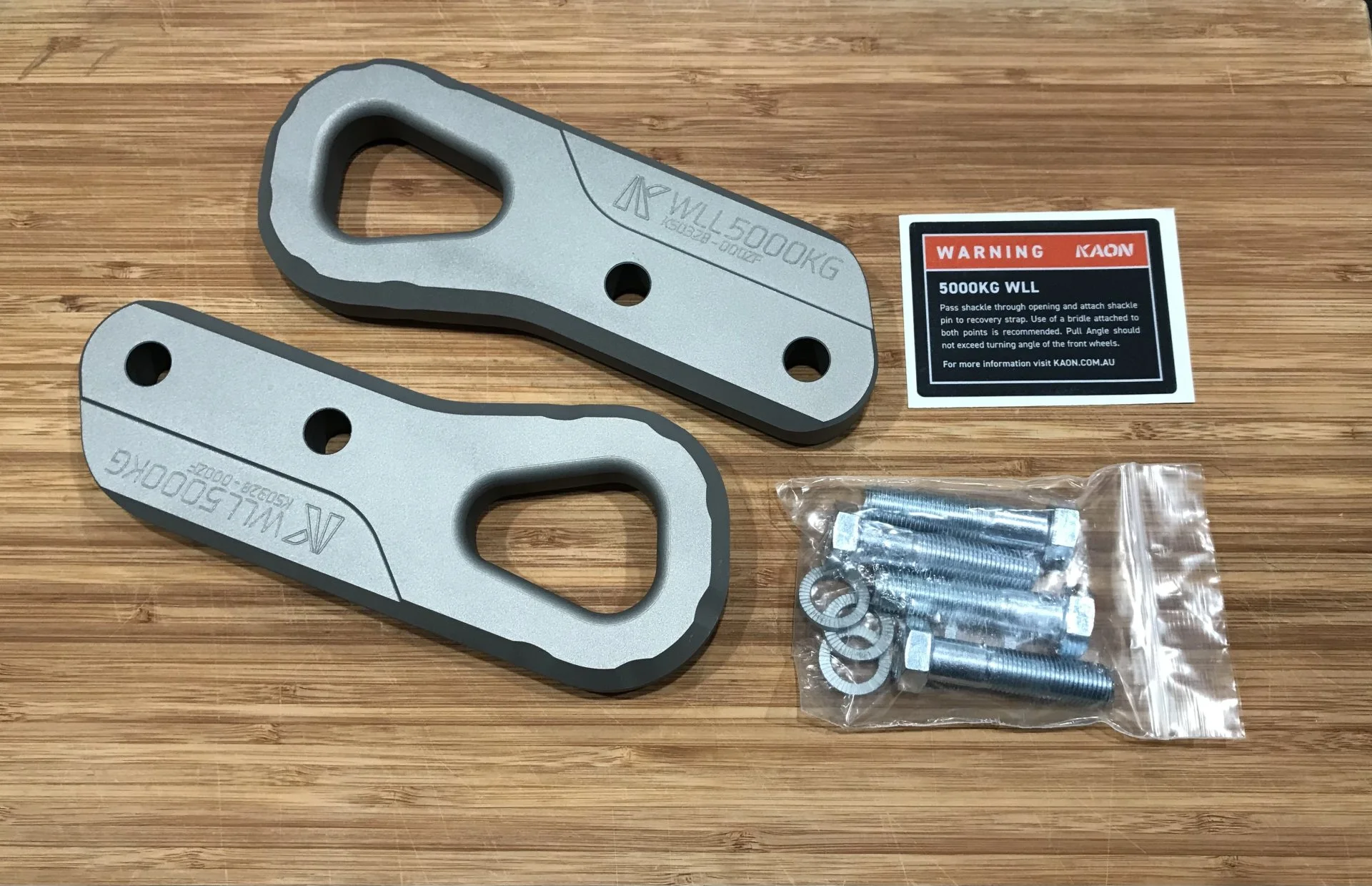

Had Kaon been available years ago, I would have gone with theirs over the ARBs. ARBs are crazy strong, but without my own serious grinding on them to create a rounded inner edge, they’ll cut right through soft shackles. The Kaon comes with rounded edges both inner and outer…and tgey also have a larger hole…allowing standard shackles easier insertion/looping.
Both seem super pricy (remember Kaons show their price in Australian dollors, so not as bad as they appear), but I’d say go for the Kaons.
The larger hole and grey color are really what drew me to them as I hate the idea of the red hooks on ours. I'll order some up here soon.
Same, they have some thought to their shape.

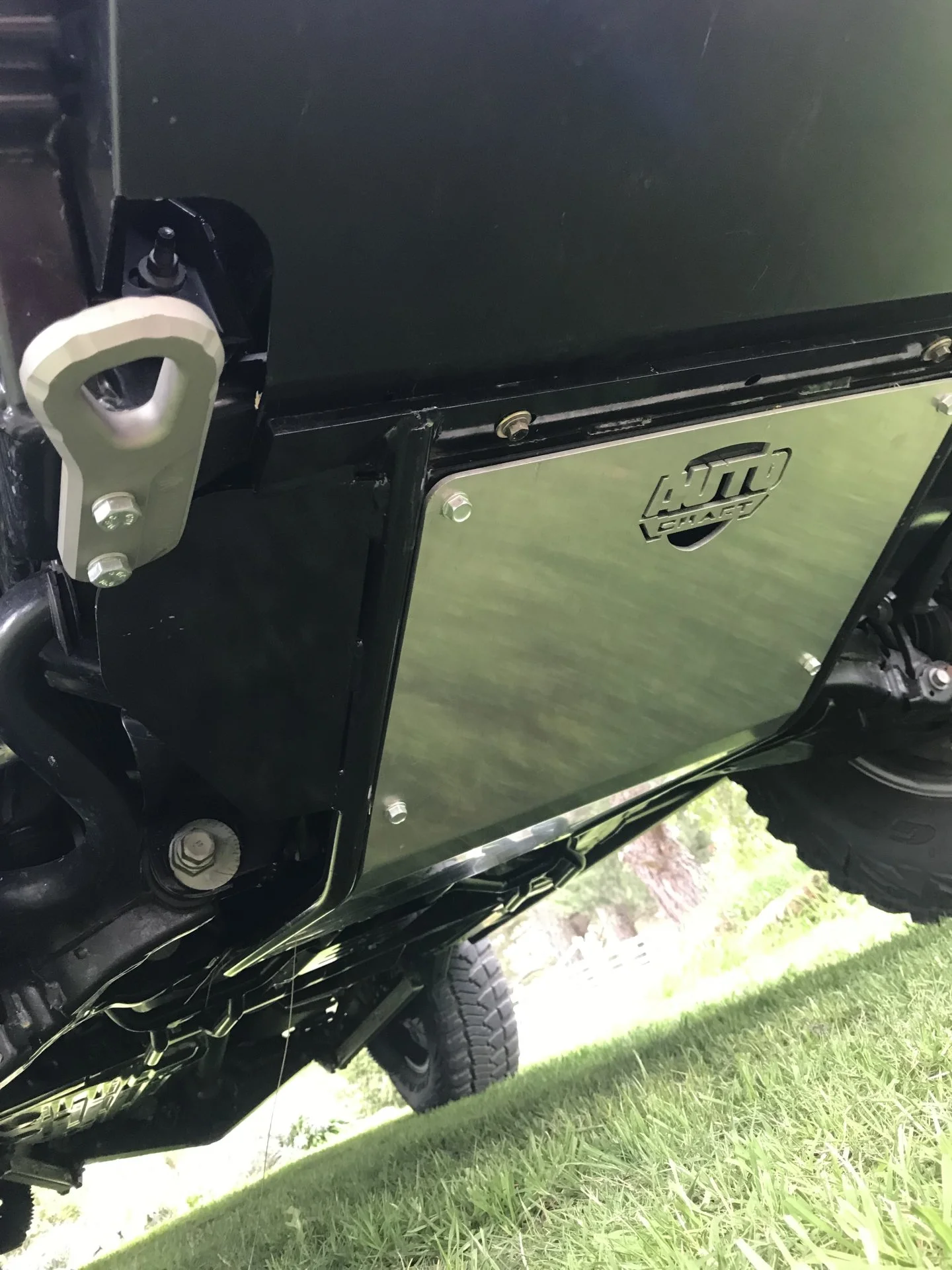

The Kaons were out of stock when I needed some recovery hooks so I went with the ZTactical ones. They're billet 6061 T6. They both met my requirement of not being red, and more importantly having a radiused edge. Worked fine with my F55 soft shackles.
I know the topic has been beaten to death but until I see a finite element analysis of the frame and recovery locations - bolting something stronger than the frame to it just seems counterintuitive to me.
I get that the recovery gear will likely fail first, but bolting a 1/2” solid piece of steel to something that’s not even 1/4” thick to some tack welded threaded connections does not make sense.
I have also yet to read a report of a failed stock recovery point.
Really haven't been any Frame type failures that I have seen... on any truck that I have seen.. I'm sure it has happened though.. but even the $500 XJ's seem to hold together.
But just today was another fatality when doing a "snatch" (i.e. dynamic recovery) using a tow ball...
if anything the failure point on these recovery tow points is the hardware but they are using G10.9 bolts (same or better than OEM).. and that would be really only in a Dynamic recovery situation where someone we bumper to bumper and floored it (possible to get over 75Klbs load..)
For a static recovery (winching or tow strap used correctly) I have no qualms with them..
I really like the fact that they are have the correct radius for soft shackles, AND More importantly state the WLL (working load limit) on them.. which means they have been at least tested to that limit under controlled conditions.
I use soft shackles from F55, safe extract, and a couple of others and Van Beest Green in hard shackles as the case demands. Pretty much has to state the WLL.
Those OEM ones are good for tie downs or level puling out of some stuck situation, but I wouldn't trust them on some 45 degree mountain hill.
I use some beefy metal d-rings when I need to attach to the ARB ones, but like mentioned above they have sharp edges if using a soft shackle.
