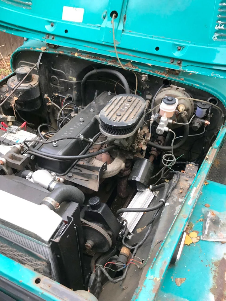

    It had that odd second gas tank opening, but there wasn't an auxiliary tank.

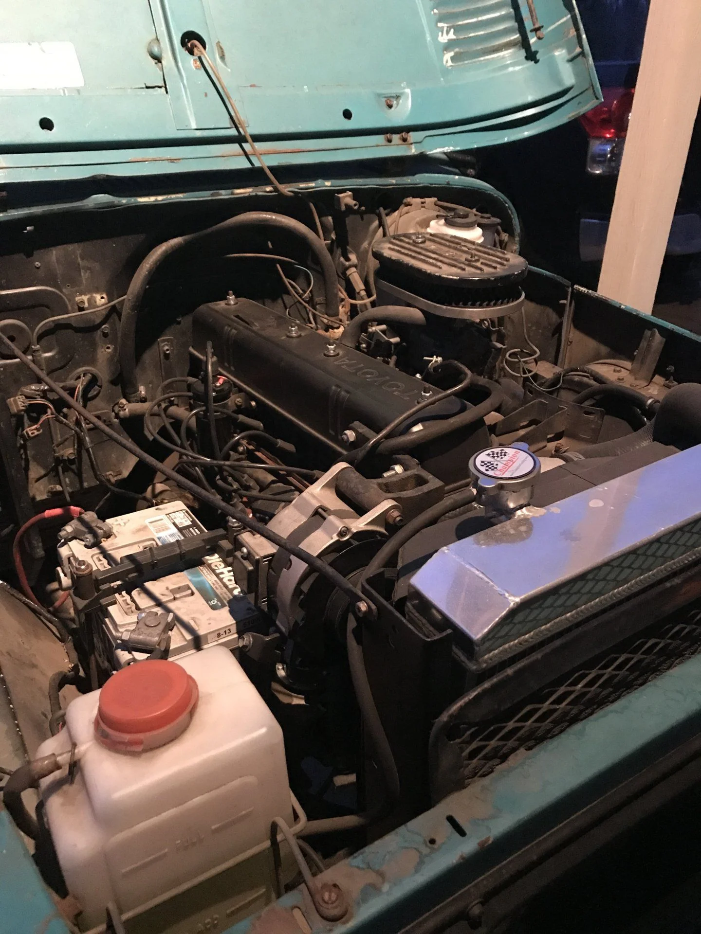

    I don't see a power steering pump. Does it have stock steering?

    There is one hidden in there. It's got a saginaw steering box and a weird power steering cooler on the driver's side.
    I might have to pick your brain when I get it up here. I don't know body work and it doesn't look complicated even to me. I want a driver not a show quality 40 so not looking for perfection, but I also want to take care of the rust properly so it doesn't come back.

    Um...is that a rubber hose splice on your hard fuel line right above the exhaust manifold?
    If your heater is hanging freely, you might want to support it so there is no stress on the heater hoses coming through the firewall.
    My 71 needed also new rockers on both sides, but not much else....all I can say is it was a long, slippery and expensive slope. I was a bit loose with the definition of "need". But the friendships made along the way and the skills (?) learned and knowledge earned can't be bought.

    Good eye Jon. Yeah, a splice in the fuel line above the exhaust manifold is no beuno.

    I didn't even catch that fuel line. I will have to try to source another hard line if they are even possible to find?
    I will try to find a way to get it in a better position. Luckily I have a great radiator guy in Georgia so if the heater core has issues he can build me another one relatively cheap.
