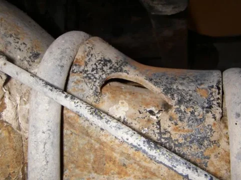

Now I need to read the FAQ to figure out what I need and how to do it. I am leaning toward the FJ60 axle replacement; as I have a tear in my front axle.
That's not a tear. That's sheet metal bracket welded to the top of the axle housing to locate the U-bolts for the spring pack. Because of the offset differential, the u-bolts have to be different sizes on that side. To keep the one closer to the diff. in position, that sheet metal bracket keeps it from sliding down the slope and keeps the distance between the two u-bolts correct. It's supposed to be there and it's supposed to look that way.
The axle from a 60-series is a few inches wider than a 40 series. I think what was intended was that you can use the disk brake parts from a 60-series front axle to convert an older 40-series front axle to disk brakes.

That would be great if I can just swap out the disk parts, I was just reading a post about having to move the hanger to accommodate the wider FJ60 axles and was becoming nervous. If I just swap out the parts, don't I still have an issue with the weaker 1972 axle? Maybe I should take BionicCruiser up on his offer. I am so confused which way to go:
  1. FJ60 axle
  2. BionicCruisers 1976 axle which already has everything.
Perhaps option 2 is best. What can I say, I am a newb with so many options to consider. At least with option 2 I would be able to put money saved toward other mods!
Thanks for identifying that it is not a tear!
