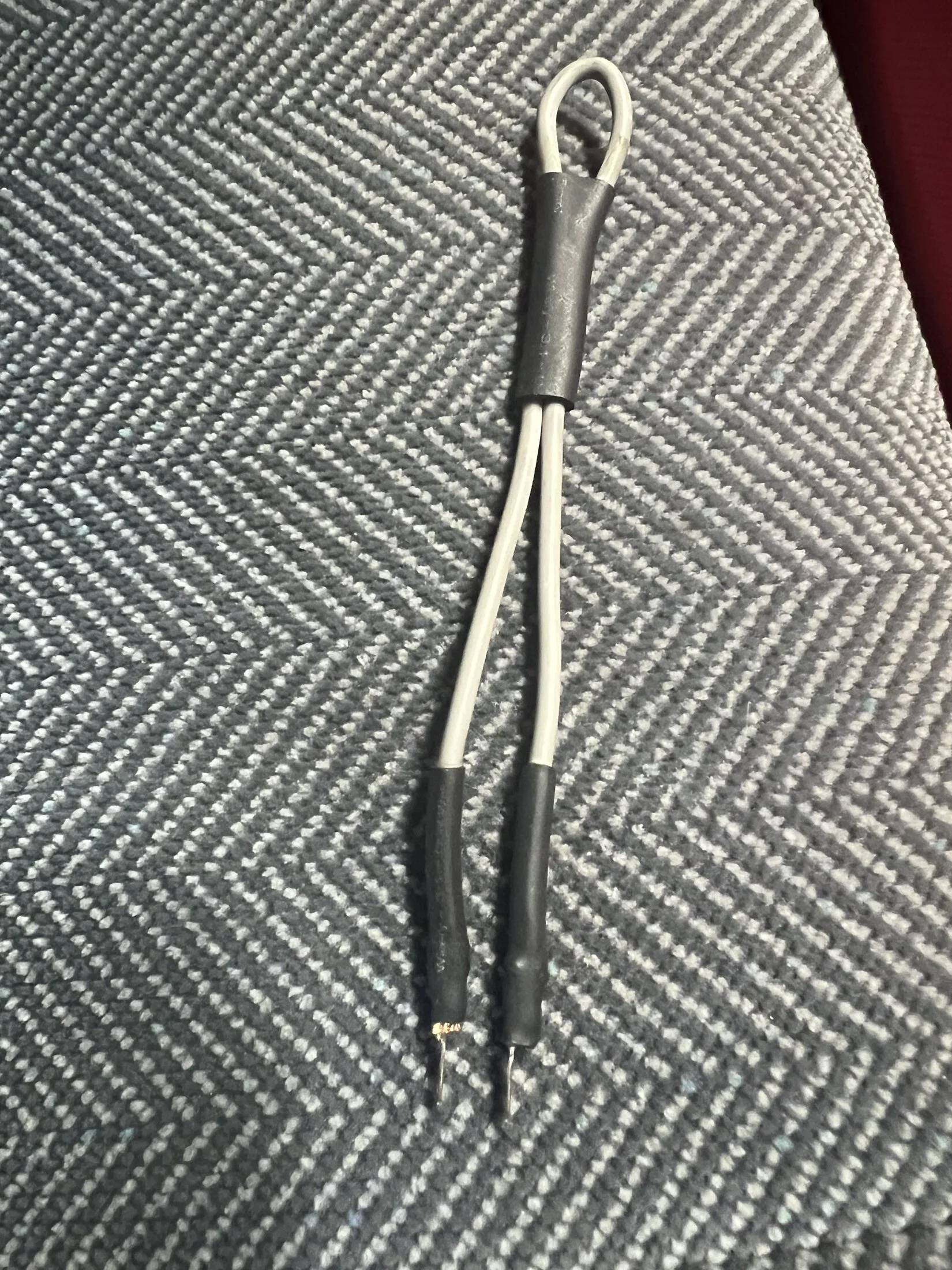

Thanks for the reply! Just to be clear, like basic jumper cables? I’ve never done anything electrical with a car, so I’m fumbling my way through it.
I have a simple jumper wire, like 12 guage wire, with flat pins on the end that I made, but some guys even use a paperclip. Jumping the battery 12v + (+B) and Fuel Pump (Fp) pins in the diagnostic connector on the firewall forces the fuel pump to run on high, bypassing the fuel pump relay.

Thanks much Jon--
So is the electrical connection in doing this good enough to get you home, or is this something that should really only be used for testing purposes?
Thanks much Jon--
It will keep the fuel pump running as long as the key is in the ON position and the EFI relay remains closed.
In the event of a collision, rollover, etc., the fuel pump will continue to run even if the engine stalls. You need to be aware of the potential hazard if you decide to drive in this condition.
