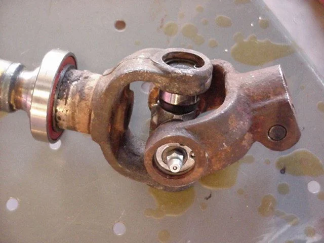

So I was working on my FJ60 PS conversion on the 40 today.
We are making a steering column out of FJ40, 55, and 60 columns.
I was trying to find replacement u-joints for the 55 and 60 columns.
Local Toyota dealer asked if I was looking for the rubber disc (40 rag joint ) After we switch to the 55 he says he does not have them, but the 55 and 60 use the same u-joint. Cool to know!
So I go to an industrial supply, and NAPA. No one lists these by application, they wanted to measure them.
I call down to American Toyota in ABQ. C-Dan is not in, but one of his boys gets on the phone and says they were just talking about these joints, and they are the same as a u-joint in the driveshaft of a early Corrola - 1200 cc model. So I bounce into the next parts store (Carquest) and ask for a u-joint for driveshaft of an early 1200 cc Corolla, and SHAZAM! She has them in stock and they fit!

We just used a hammer and a vice, they went in fine...
i wouldn't call that one a repost, unless i read the other post wrong no one mentioned the 1200 cc Corolla. by the way what year was the corolla?
Yeah this is good info Pablo.THanks.. I heard they were the same as the corollas but ordered Toyota ones. That is cool the ones you got have a zerk fitting in them.
What happen when i broke the first one I did was I was hammer the end through and as it came down it was not lined up perfectly with the end of the spyder joint and broke all the little rollers inside so it wouldn't move.

I ended up using a Toyo u-joint Part Number K5A517 which is also used in a KE701981 Corolla....

Precision U-joint # 395
or
Spicer # 5-1500-1X
1970 Toyota Corolla with a 1200cc
Thanks!
You guys caught me sitting at my desk where I have my Cruiser files...
I found my carquest reciept. It lists p/n U/J 1-0011 "u-joint repair kit"
That looks like a pretty generic p/n to me.
I think I would go with Cali's Spicer p/n
1967 to some early 70's year...
Looking at this thread again - looks like the U Joints are the same as ones used on a driveshaft of a 68 to 74 Corolla with the 1200CC engine.
napaonline.com does not show a 1200 cc option for a '68 & '69 Corolla (shows 1.1 L), but they show PUJ 395 as the u-joint...
1970 shows a 1.2 L, but also pulls PUJ 395 as u-joint.
1971 and up shows a 1.6L and a 1.2L version of Corolla: 1.6L pulls different p/n (PUJ 394)
In 1975 they made the 1.2 and the 1.6L pull the same p/n u-joint: PUJ 394 which is 1.024"
We want PUJ 395 for our steering columns, which is 0.788"
