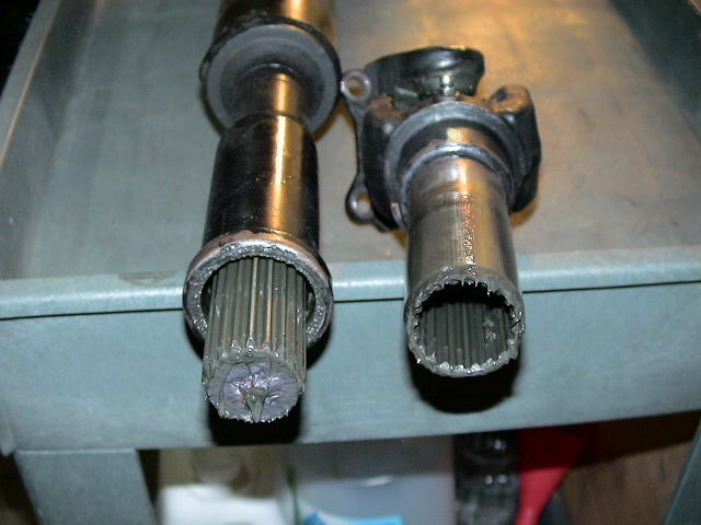

You could remove the grease fittings on the front and rear driveshaft slip yolks (?6mm IIRC) then drive around a day with the fittings removed; that should allow any excess grease to come out. As already mentioned, that mechanic likely overfilled the slip yolks with grease but then it was already jerking occuring before the vehicle was serviced??
This shows the slip yolk removed from the driveshaft, note the small grease fitting point up at 12 O'clock on the slip yolk on the right of the photo:

just a thought based on an issue I had a few years back with mine when it was exhibiting similar symptoms and ended up being rear driveshaft related.
I removed the rear shaft and separated the slip joint and cleaned thoroughly. Then I lubed it with moly grease and installed in the truck bolted to the transfer but before I bolted it to the diff I removed the zirk fitting, compressed the slip joint and whilst compressed put the zirk back in. Then I extended it and bolted to the Diff.
Im sure it was old grease that had hardened within the area near the zirk fitting that caused the binding which in turn caused the jerking / rumbling which shook the car upon acceleration.
Its been perfect ever since
