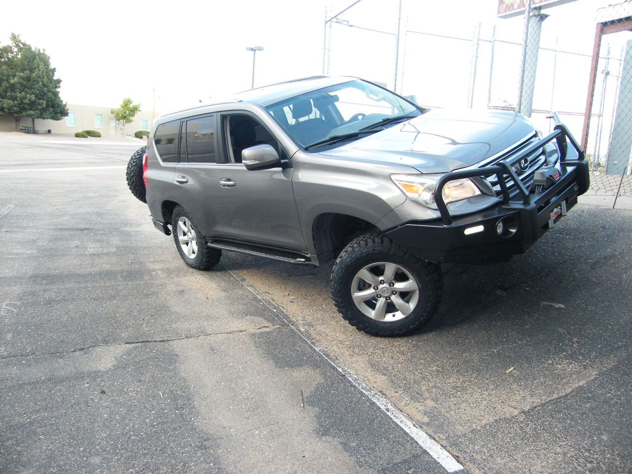

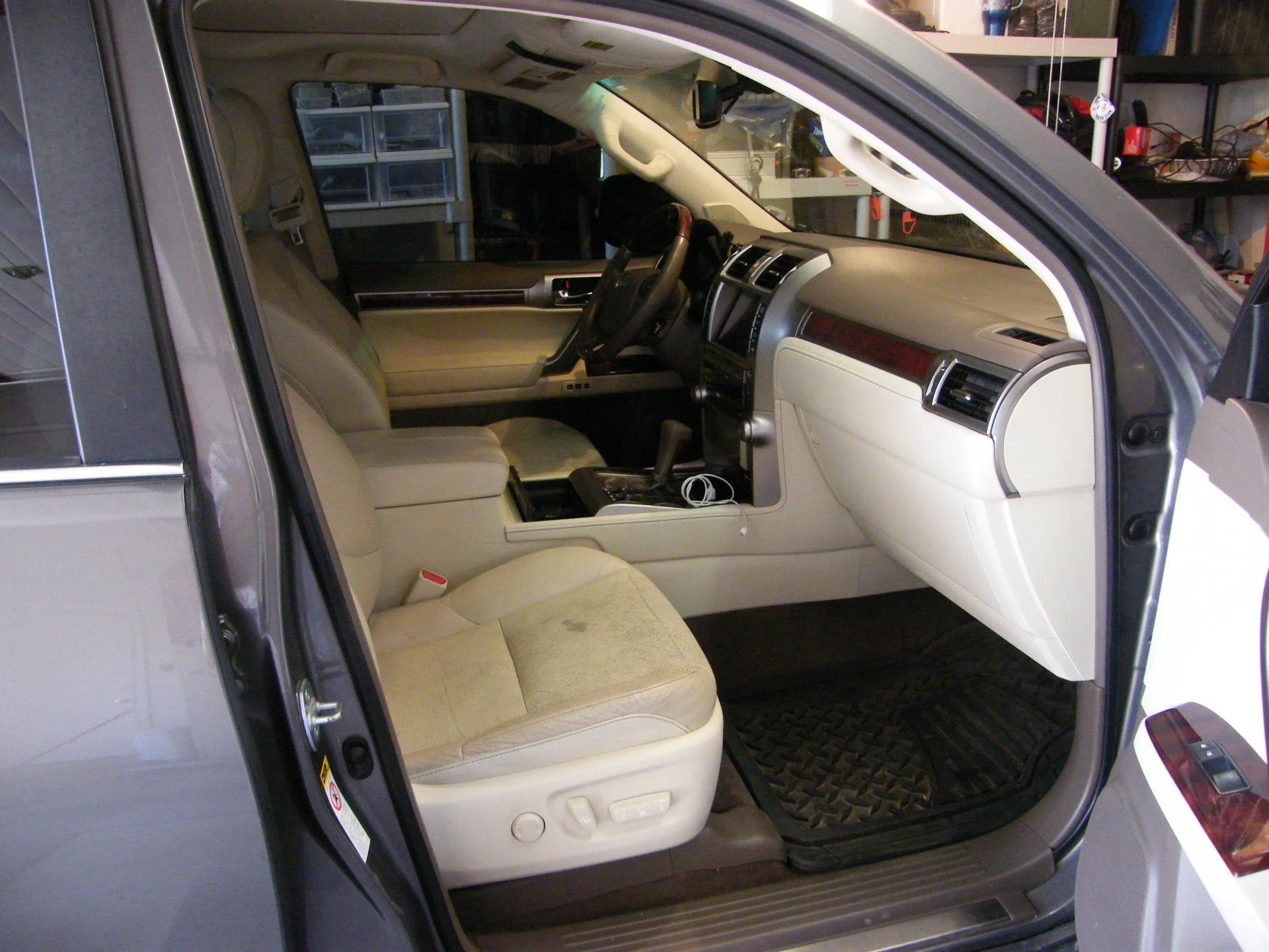

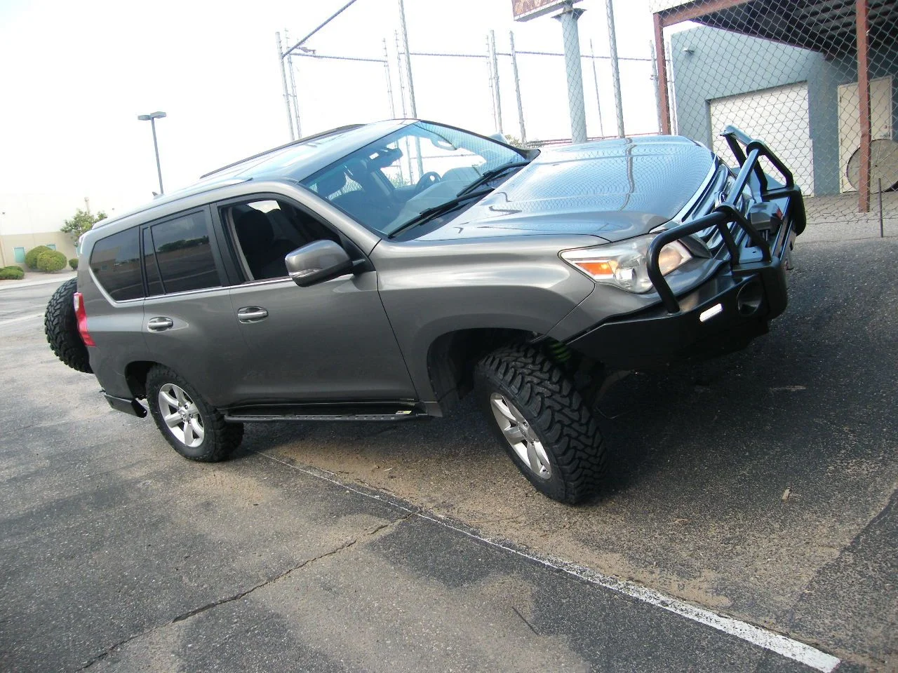

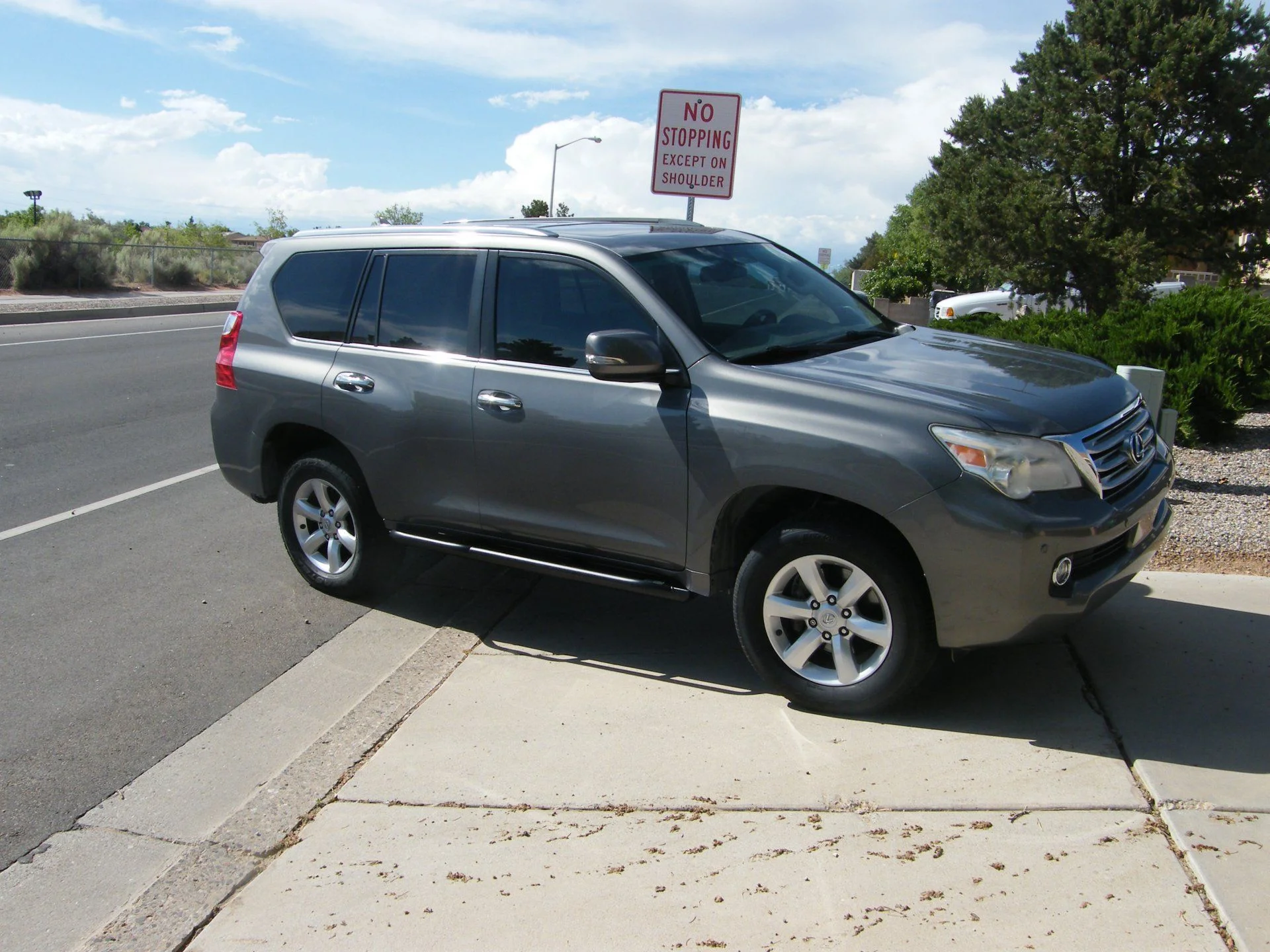

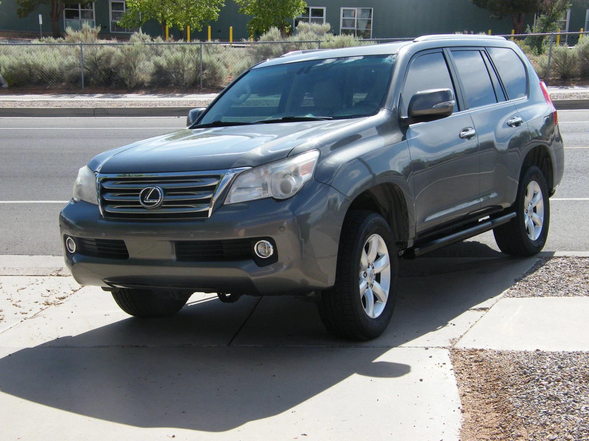

Pictures of my GX 460 after some mods
Posted pictures twice, oopps!!

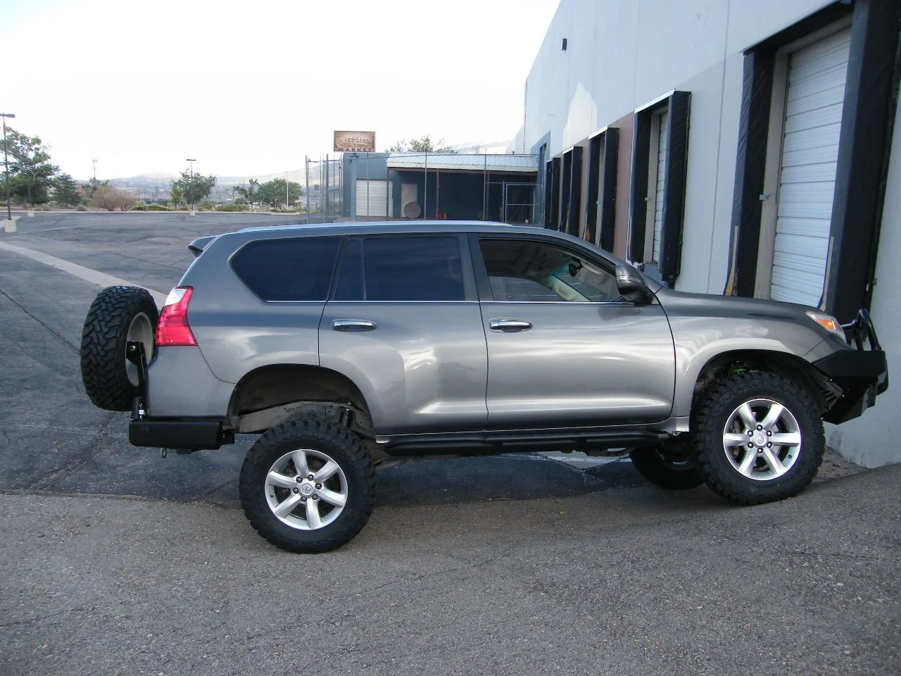

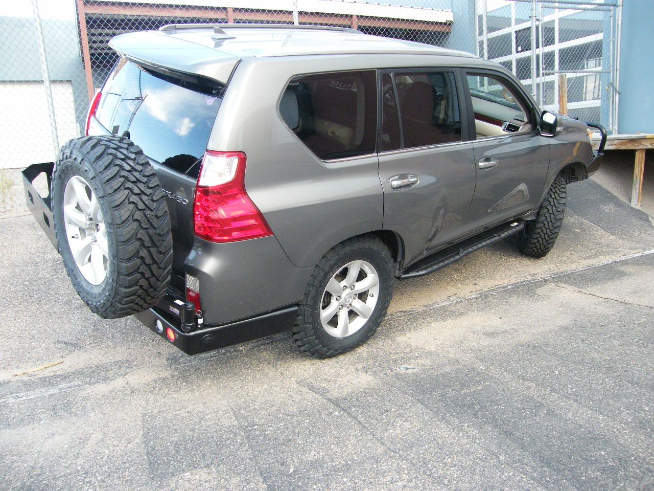

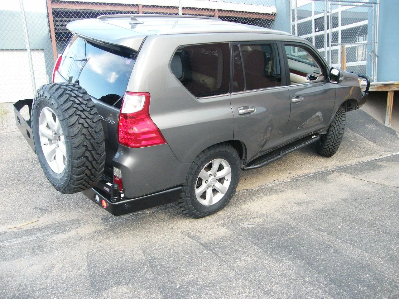

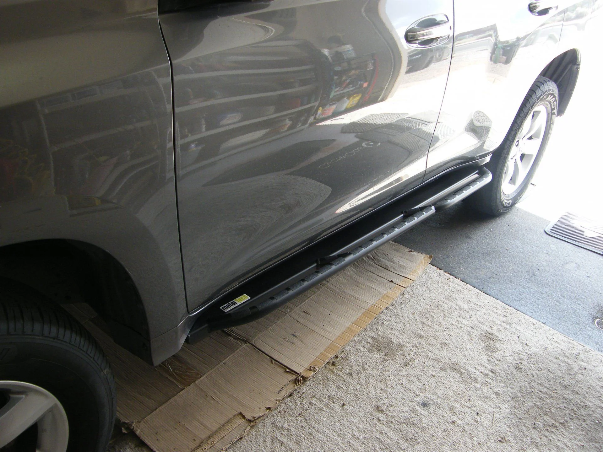

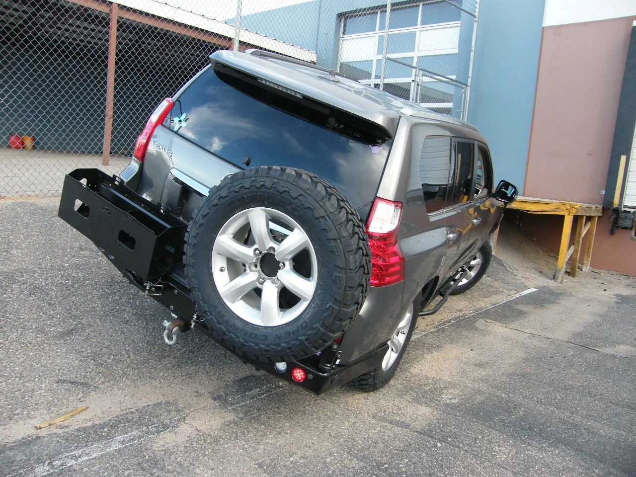

Ironman front bumper, Warn Xeon 12K winch, Metaltech sliders, Dobinsons rear bumper with dual swings, Toyo Open Country Mud Terrains. 265/70/18.
RCI Steel skidplates about to be bolted up. I removed the third row seats to give more rear storage and shave off 100 pounds of weight.
Still need Gamiviti roof rack and then can mount up my RTT. Lots of more things to do. Gotta mount my HAM and CB radios/antennas and get the ARB dual compressor plumbed to the front bumper. Rides smooth, need to get it off road once skidplates in place. Hoping for a Fall camping trip.
Excellent!! Time to take it out and scuff it up
Got to do that,but skidplates first. Don't mind some scratches, but don't want any holes in the drive line or gas tank
Looks great! That rear bumper must accommodate a gas can back there next to the tire? Still on stock rims with the new tires?
Carrier can hold 2 5 gal gas or water containers. I am going to get other wheels with some neg backspacing, 0 or -12. To move the tires back out to a better, wider stance. No rubbing now but needs to be centered in the wheel well.
