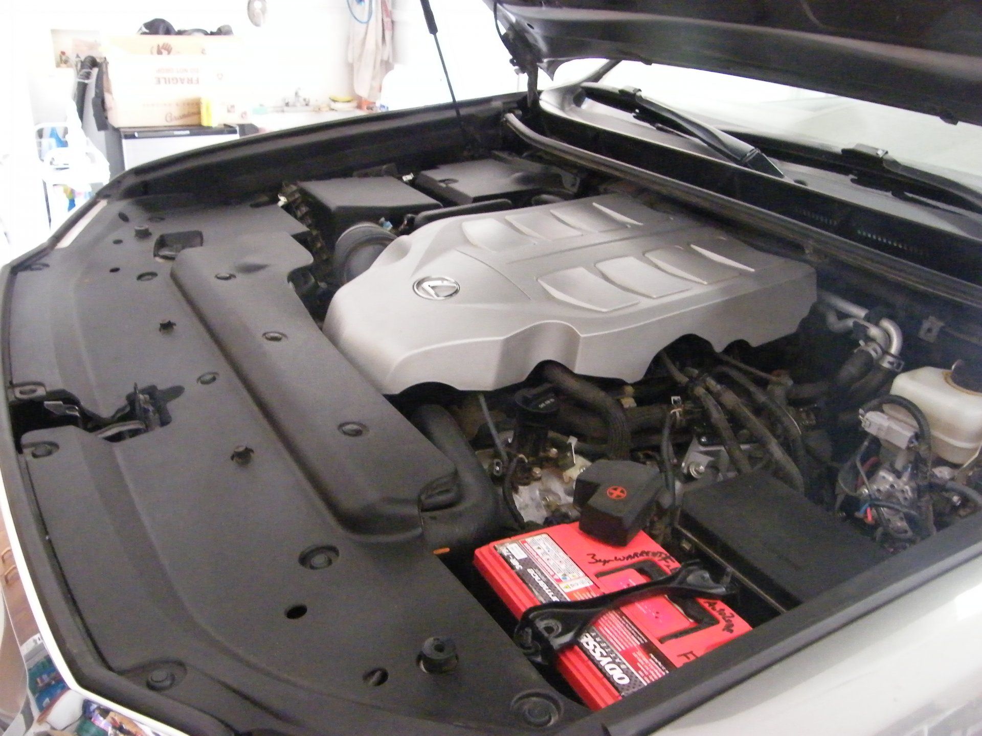

I have done some things to my GX. Pictures are few right now, but I will post some soon. First, I changed all the fluids. Took off all stock skid plates. and removed the electric 3rd row seats. That removed 100 lbs of weight, just the seats!!!!
I bolted on Metal Tech sliders. That went well, since I took 3 days, not because it was difficult. I had to trim lower rocker panels and grind a metal cover protecting the KDSS box. I could not mess up the plastic panels, so I did lots of measuring, before cutting. Even reattached the "puddle lights".
Ordering bumpers, skidplates and lift has taken a long time. Pandemic put items on back order or items not being built until they are ordered.
I have bolted in an under hood ARB dual compressor and slowly getting that wired in. Bumpers, I have turned over to Desert Rat to mount. I don't have the ability to deal with these very heavy , weirdly balanced items. Good thing, cause , neither is a direct bolt on. Cutting plastic, and some custom spacers, Desert Rat is having to build, and weld on would have stopped me in my tracks.
I will be getting some of my skid plates next week and I can get them on. Skids are important since I am not building up a rock crawler, so underbelly clearance is not great.
Going to get a Gamiviti roof rack, to mount up my RTT. He does not build it until it's ordered, 6 weeks, so I will order that soon. He makes quick release pins for Batwing awning, so That is the awning I will get. One minute on/off.
Need tires, so I will be figuring out what size will not rub. Looking like 285-65-18 (32.8-11.5") or maybe 265-70,( 32.6-10.5"). 3 inch lift. Would like to go bigger, but will be doing some measuring. This GX has a lot of built in articulation.
