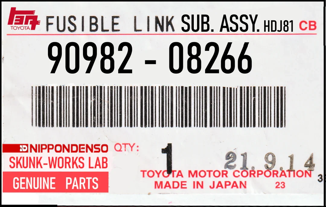

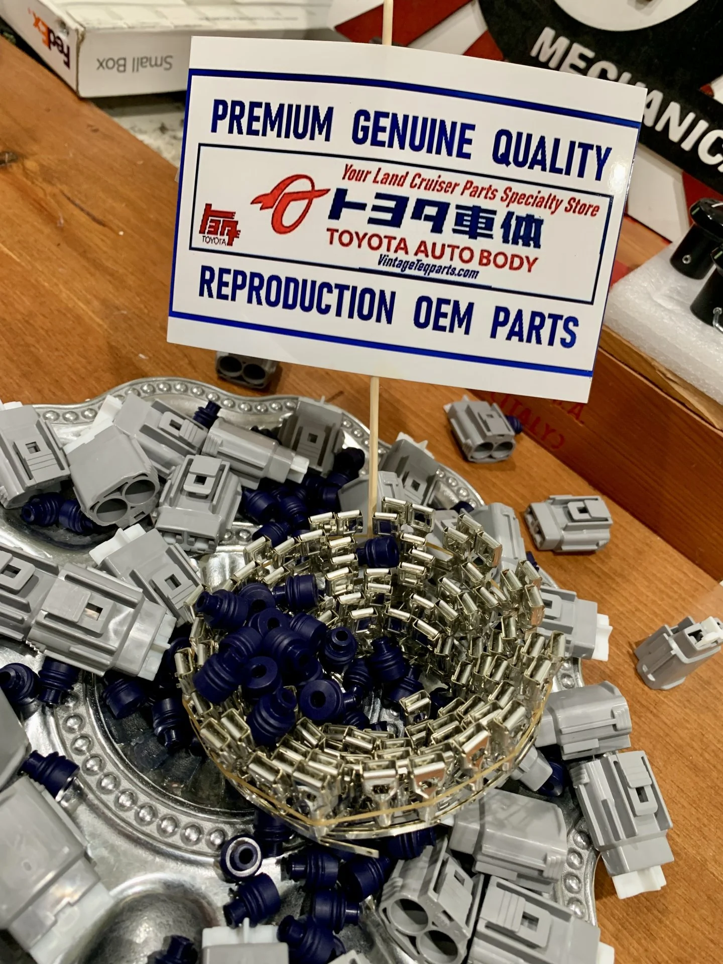

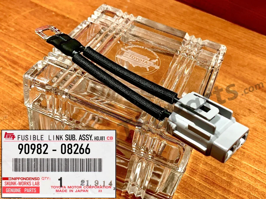

i think everyone regretted importing there HDJ81 , when there 90982-08266 NLA / DISC. fusible Links burned up or age and time became ashes to dust and dust to
on the road side stranded ........ :confused:
- but and however ......
- with technical assistance and input consulting from HDJ81 Community members like @Dusten & @ZCissner , and @HillCountryTX to name a few ,
the once extinct 90982-08266 now LIVES ONCE again ....
and for the long term too ...:)
- so ,........... ,
- do not fear importing your dreams and your HDJ81 based on this once thorny issue of NEEDED parts availability topic at hand ........
is now in good hands ...
