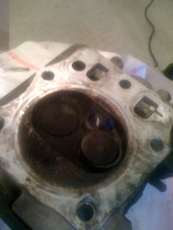

photohead.webpI took it apart tonight.
One of the valve seats popped out. Nothing damaged, it simply popped out. I was talking to the local lawn and garden shop today and they thought it may be a stuck valve. So I decided to pull the head off.
They said it would less than 100.00 to unstick if they had to pull the head.
I believe I can set the lash. But, I've never replaced a seat and valve, I dont' have the spring tool. I did find a complete PDf of the shop manual for the engine online for free.
It seems much less difficult than a front axle service, which I sucessfully completed a few times.
So if I can find the correct parts, I may give it a try. What are your thought? Is it difficult to find the correct fitting new parts.
Got it done. I hope she holds.
I found a local shop that did it for $20. They pinged it in. The other valve as well.
Had I known it was $10 at Napa, I should have just grabbed the tool.
Not to save $10, but to get some experience. The shop said everything looked good. No nicks, etc...
I'll put her back on tonight after work. I'm sure it will be fine. Thanks for your help.
