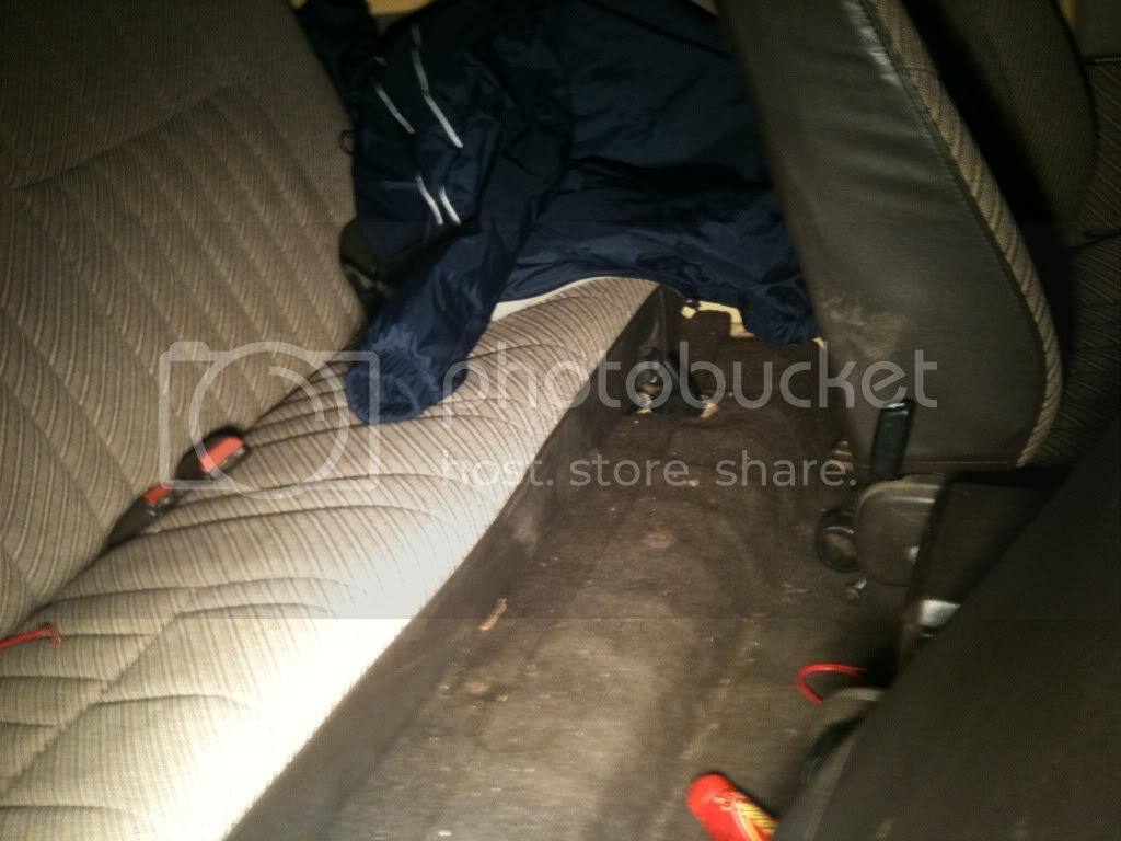

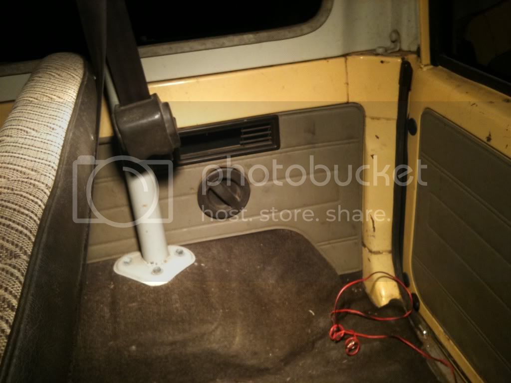

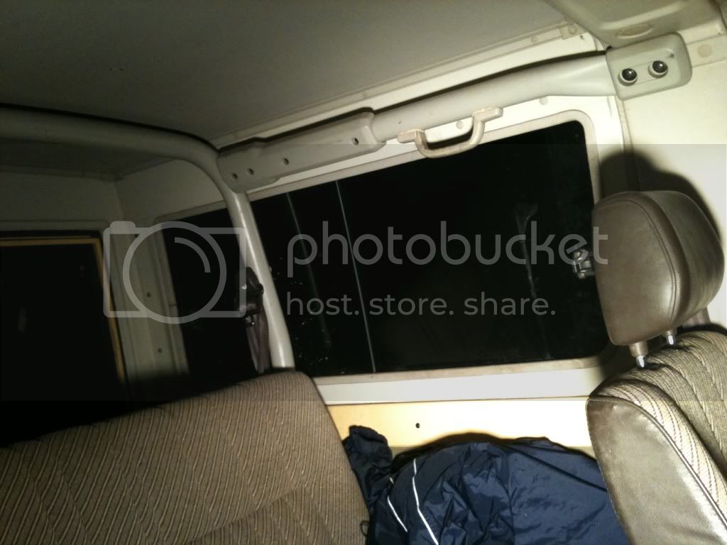

I'm picking up a 1997 HZJ73 with the 2 long bench seats. I need to change them out to a single forward facing seat. I've acquierd the seat with belts, but need to see how the seat and belts are attached in the rear.
I gather there are rigs with just lap belts, and those with shoulder belts (attached to the roll bar). Photos of both types would be very helpful.

Will try to get some pic tommorow of my brothers 73 and forward facing seat and seatbelts
