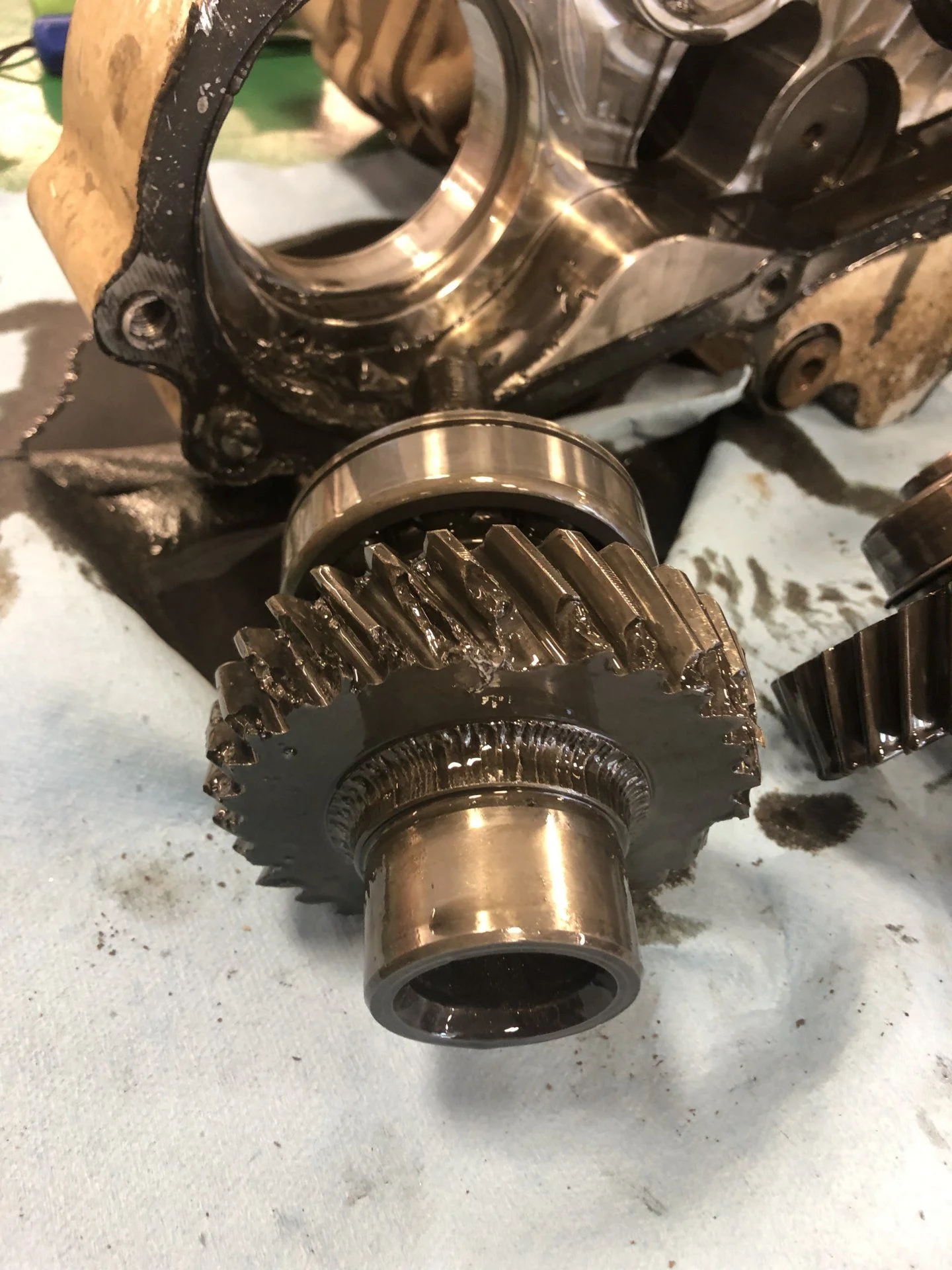

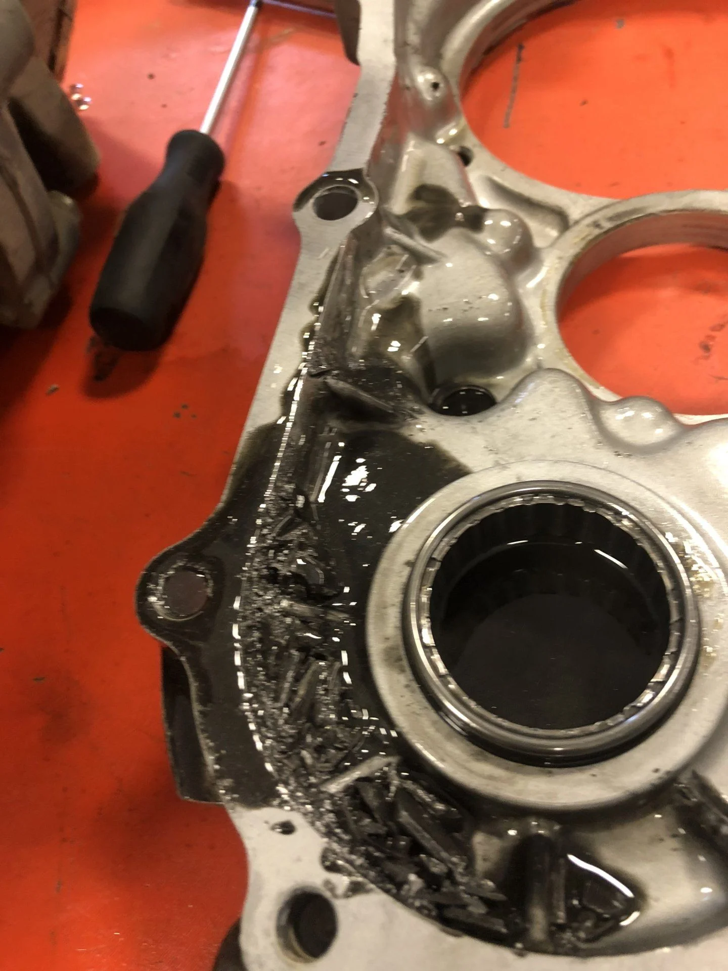

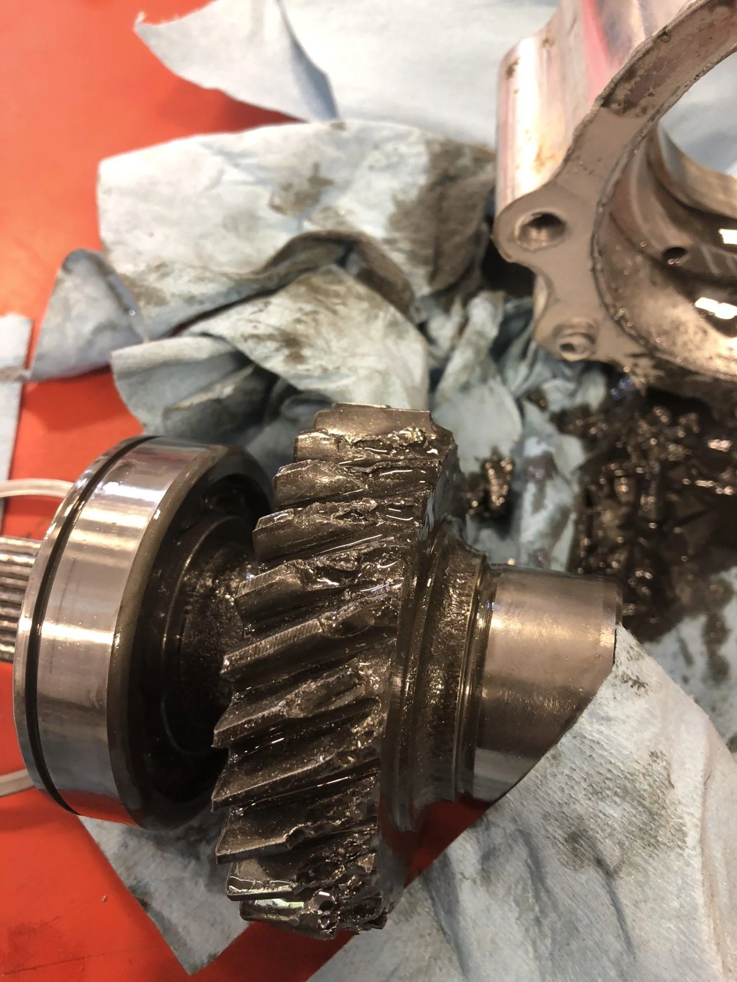

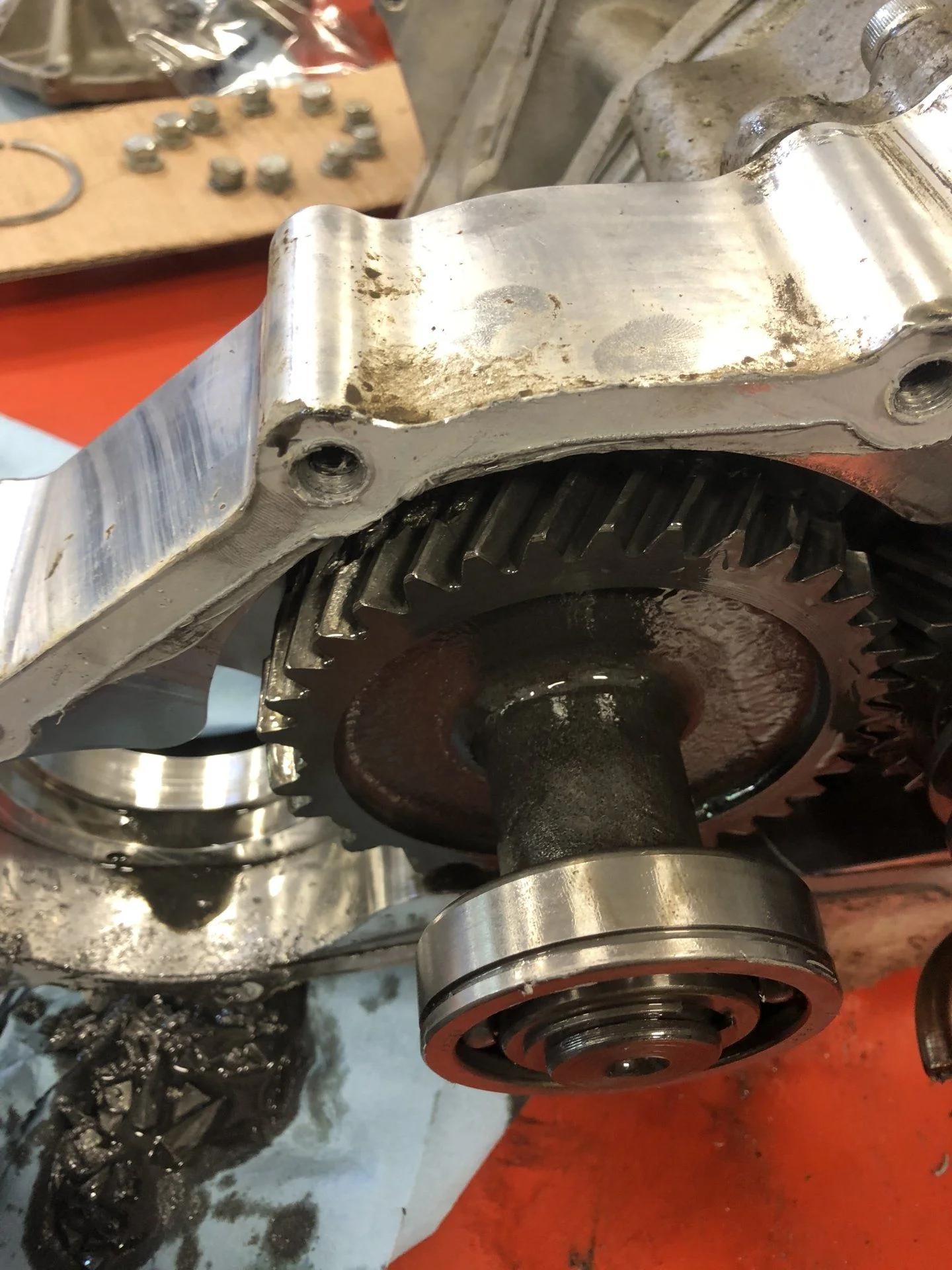

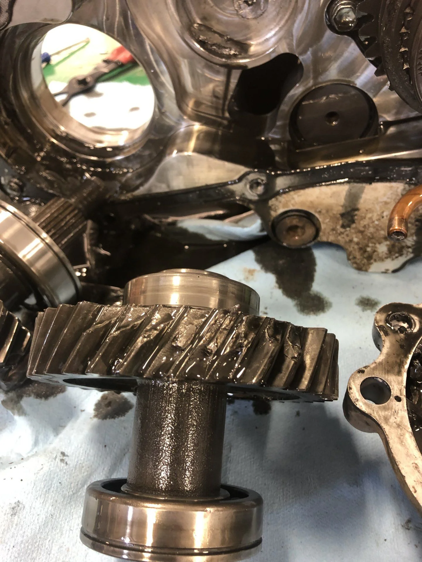

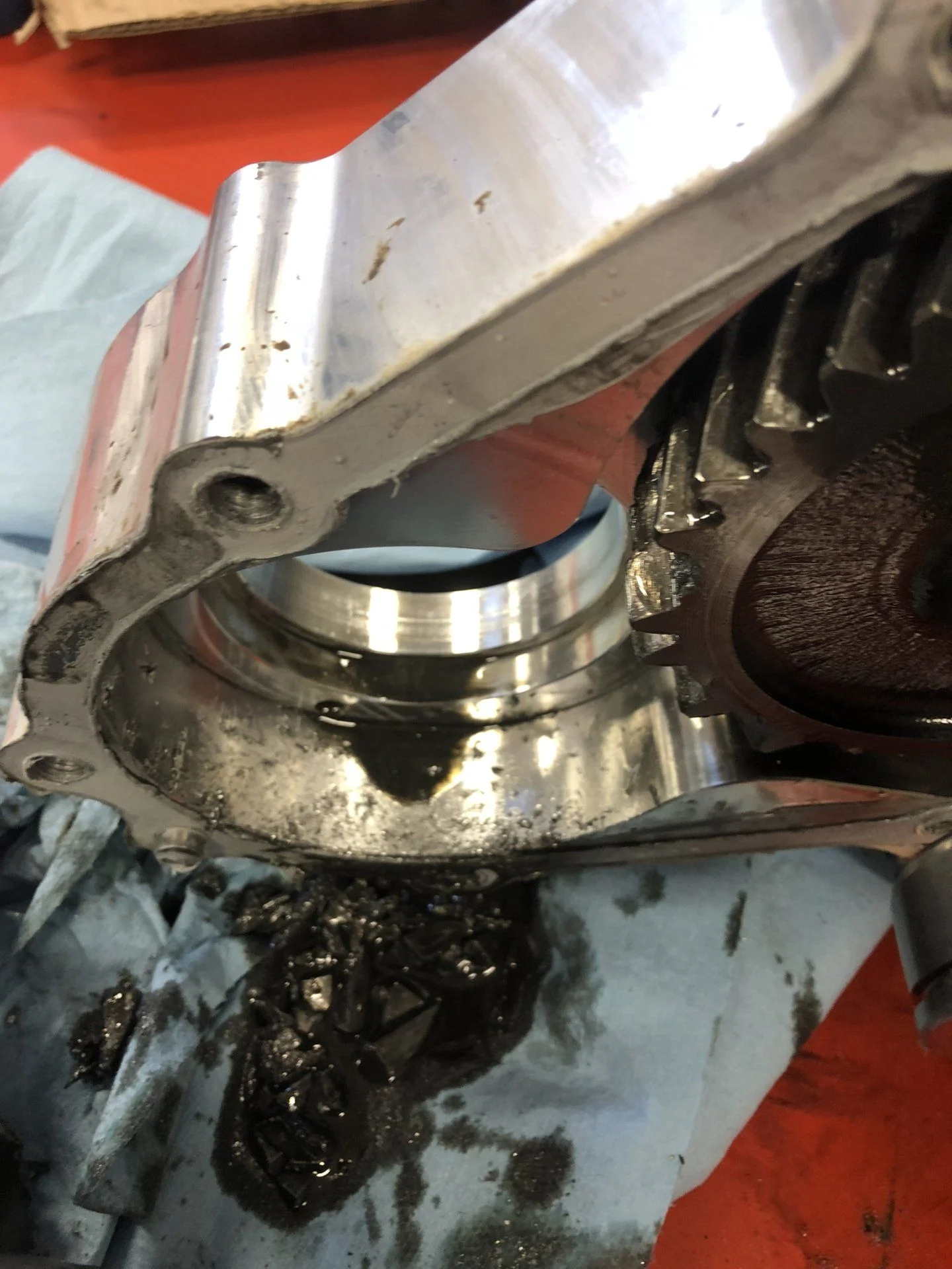

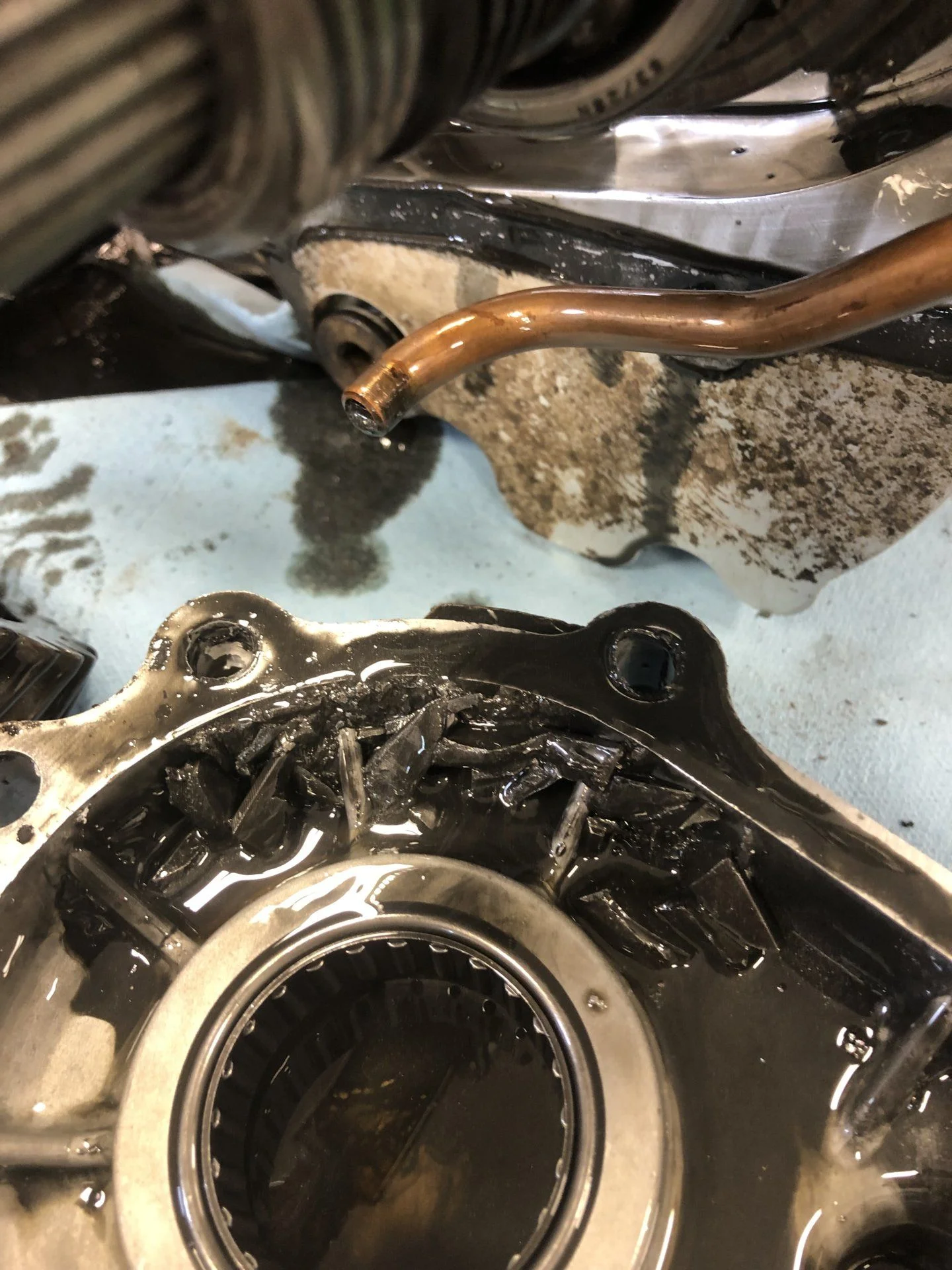

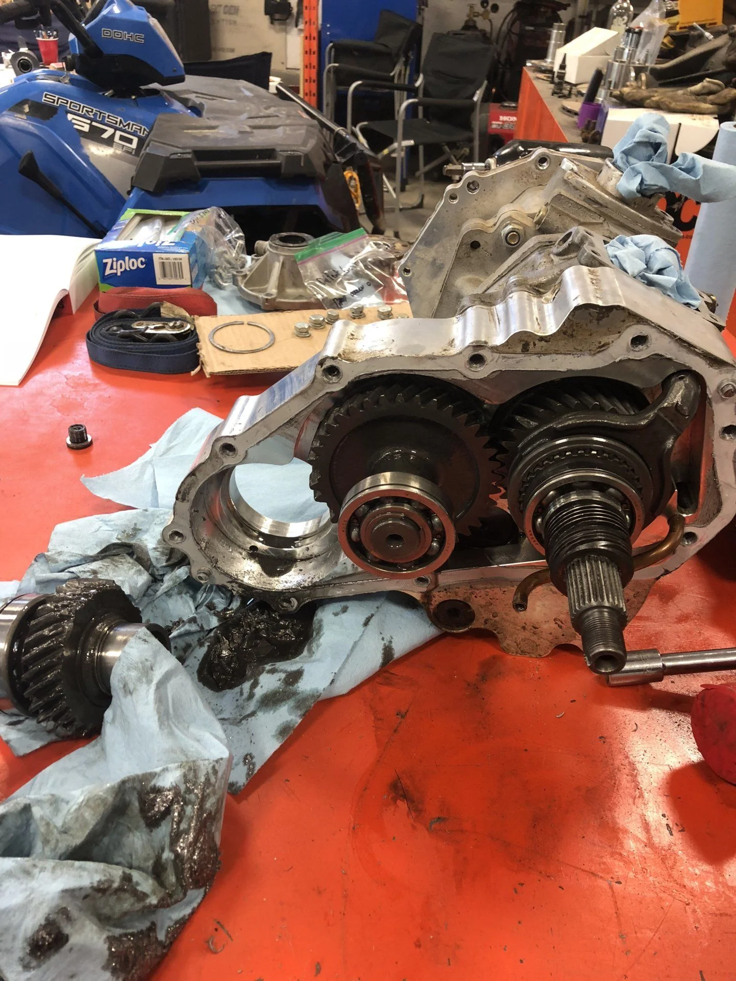

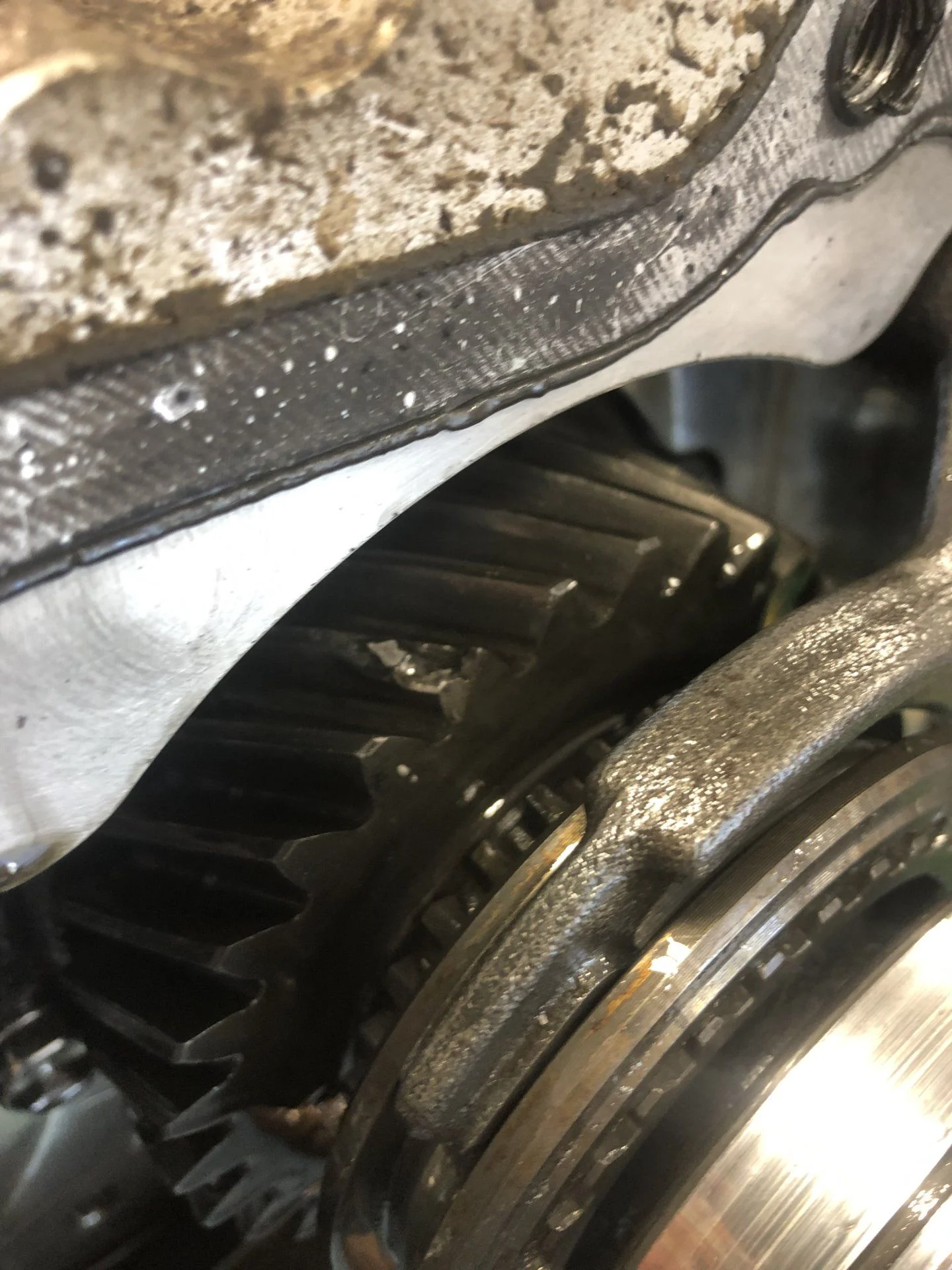

pulled my transfer case out of the old taco finally. Not super happy but I’m going to talk to BCC tomorrow. He has always been good about things. Sucks because who knows how much metal got to what and it’s not as easy as ordering part numbers from a Toyota website. Hopefully he can help me. Pics of what I’m talking about.All three gears are missing teeth which means a full rebuild of the back case.

The back case is a Trail Gear conversion to a gear case. Now discontinued which is mega bush. Talking with Tehran I've decided to send everything back to him in hopes he can piece it together with what he has there. Pain in the arse going back and forth on that many parts. I am also sending my taco chain case as well, just in case.

Was due to an idler bearing that let go and then checked out all other areas of the t-case

No I don’t know why it happened. I had the same thoughts as you but I’ve found several forums that have people running the same setup. Hopefully not a common problem.
