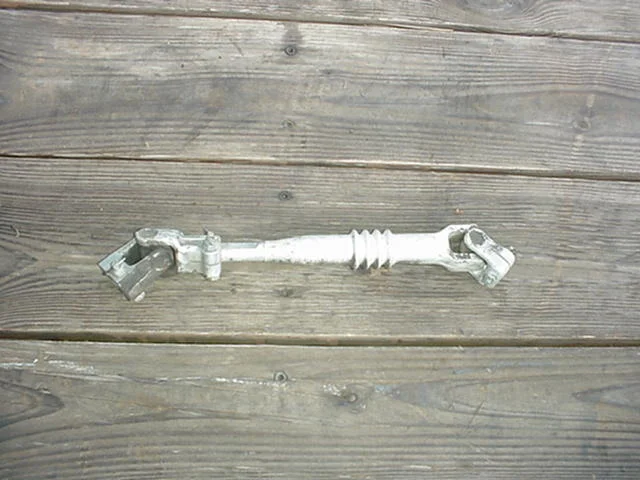

    found it in a pile of parts,,,

    Looks like the couple shaft between the steering column and the steering box. It looks a little long for a '55, but I'm not an expert. How long is it?

    Unless the late late model FJ55's steering shaft changed, that is not from an FJ55. The FJ55 u-joints up to at least 77/78 were larger than those.

    Either an FJ55 or a 60-62, I see you own a 62, take it out and compare them.

    It looks similar to a 55 steering shaft, but I don't it is.

    i dont think its 55 either, 55 is welded instead of the 3rd clamp this one has, plus it looks to have a flat edge.

    it is not from a 62,,, I was going to get measurements but never got around to it,,

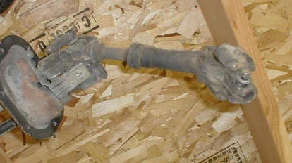

    here are some reference pics. the one in the rafters is from a 71 piggie...the one in the engine compartment is from a 73

  9. 3pits
    3pits
    Messages:
    2,216
    Likes Received:
    23
    Joined:
    Jan 14, 2005
    Location:
    NE GA
    yea there is no way what I have is from, a 55 not nearly that beefy,,, ooooppps there it goes into the scrap pile,,,
    thanks guys!
