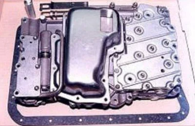

My truck (trust me, there is lots of rust hiding under the snow, salt and grime), add to it some tranny goodies (extreme valve-body with 3rd lock-up, and ATF cooler)
Get a cheap old boat trailer (3500 lb axle and surge brakes if I can find one), make some brackets to mate with the spring hangers on a 62 frame, go to California and pick up clean body.

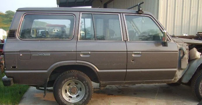

Thinking out loud... (dangerous stuff)
The FJ60 body & frame looks like a trailer kinda. It has taillights. It has a "tongue" (bare rails out front). It just needs a hitch coupler bolted between the front bumper mounts, and a rear axle on some old leaves. With no engine, trans, transfer, shafts, steering, frt clip.... There shouldn't be that much weight left. Anything heavy can go at the extreme rear of the trailer or in the backseat of the towtruck. :hillbilly:

I like thinking out loud, but I see three problems with that. The practical one is too much tongue weight (I would think anyway). Also, the axles are staying in California, I understand them to be slated for another project. I think this jury-rigged set up may attract unwanted attention from the Po-Po and/or border guards. If it was a short haul, I would give it a try, but it would be ~1800 miles......
I did something kinda like this once. Had a 60 frame and body that needed to be hauled but the axles had been yanked. A pair of 8' long 2x4's will set into the front and rear spring hangers, then a lag bolt can be screwed in to hold them. With that setup I was able to drag the frame and body, using the 2x4's as sliders, onto a trailer.
That I like to hear.
Instead of a boat trailer I'd find a regular flat decked trailer.
That would be simpler, if I can find one to borrow I should go that way (I know a guy who uses a suitable one to haul his hovercraft, but I'm not too optimistic on him lending it out...), my thought on the boat trailer is that one would be lighter and cheaper get ahold of.
If you have it on a trailer with a wooden deck it's then a real simple matter to screw down some blocks to keep it from shifting. Still gotta use straps or chains.
I towed this configuration 700+ miles with a FJ60 that had a tired 2F so I know it'll work, and this was another body/frame that went to Canada.
