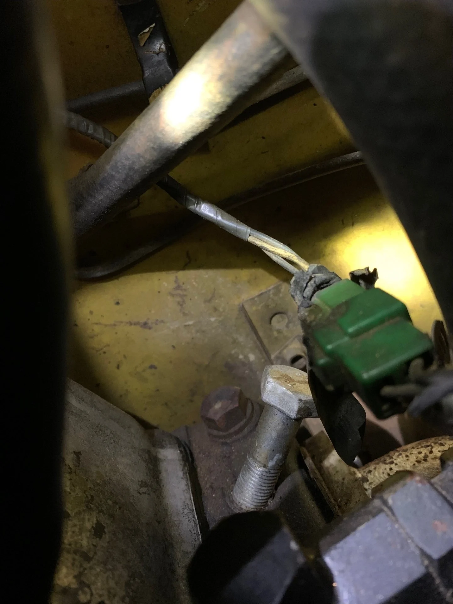

Hi all - I have a '76 40 with a weber 38/38 carb. The green connector for the water temp sender and wire to the carb melted. It looks like it was resting on the cooling union next to the water temp sensor. You can't tell from the photo but the green connector has a perfect indentation on the bottom that matches the union. My question is are the green connectors sealed? I have Yazaki white motorcycle connectors I can use to fix it but I don't think they are sealed.
If sealed is required does anyone know where to get the green replacement or other recommended sealed connector?
Many thanks.
green/white/blue are interchangeable

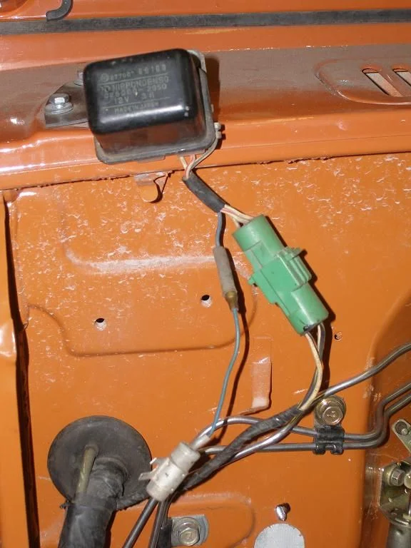

VINTAGe TOYOTA GREEN OEM connectors housings are always associated with IGNITION system related circuts ....
Coils
Distributors
Carburetor assy. air horn & other circutry like
FCS SOLONOID
Elec. key switch on column 73-84 fj40 fj55
FUSE BOX inline fused protected side involving ignition circuts
VOLTAGE REGULATORS SEALED FIRST GE< Water Proof types
First generation Alternator Input Plugs / connectors UV rated Spash-proof type era
Emissions components that have a electrical component involved
GREEN
YAZAKI connector housing COLOR CODE Prefix is #60
ex:
7118-3320-60
also : GREEN color connectors are first generation attempt at
UV rated JIS Spec. NYLON ........ or Plastic if you will

I'd look at that screw used for capping the smog pump hole(s). The screws are touching exhaust, and could be a heat/abrasion problem for the wiring? There is a good OEM plug, a Jim C. option, and probably something available at the hardware store.
