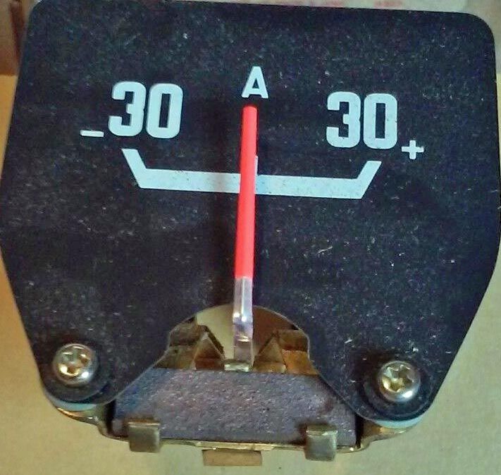

Seems as 99.9% of the amp gauges in the old FJ40's are just in-op. I have in most of mine I owned just put in a volt meter and called it good. But I was looking around on the web to see what the usual cause was for failing and mostly is there a possible fix for them. Anyone know more on this subject, or know a thread on this. I'm talking about repair not replacement for my 50/50 amp gauge. 30 amp shown is just for reference.

I too would like to increase the longevity of my ammeter, perhaps installing a bypass charging wire and a limiting resistor in series with the ammeter. This would allow the ammter to remain funtional and limit the current running through it. Which, imo, is what usually causes these to fail.

That's a good point, something that Toyota should of done. But if its not working due to frailer is there a place to send it of a possible guild in how to repair one? Seems as in this day and age we could find a way to fix one, maybe.

My point was and is can one of theses Toyota amp meters be repaired if found bad. As for the two place that were offered to check into I will do just that-thanks for that information.
As why to have it repaired, I have a near complete stock FJ45 and I want to keep it as stock as possible with all factory gauges working, just my preference. I will note I have a volt meter installed so I believe in both, they both have their advantages. I will make contact with the two companies and post what information evolves from that contact.

I was wondering the same thing. My amp meter on my HJ45 is the only one not working. The FSM says you can check resistance of terminals on back or look for broken wire. I’m trying to see where the wire is connected in the engine compartment.
Rusty72, yeah never hurts to try a used one as long as it was working before removal. PM me with info. Cheers.
Should be the black two fuse case on the drivers side (RHD) may have yellow tape and maybe a bit hidden in the loom near firewall area. (2) 5 amp fuses. Cheers

View attachment 1693190 I was wondering the same thing. My amp meter on my HJ45 is the only one not working. The FSM says you can check resistance of terminals on back or look for broken wire. I’m trying to see where the wire is connected in the engine compartment.
I believe that year ammeter is actually indirect. Meaning a voltage drop on a resister controls the deflection on the meter. More complicated than early models.
There are a lot of amp meters out there functioning perfectly normally, but lots of people think they are broken because they stay put at 0, which is what they do when everything is normal.
If you want to check them, just turn on all the lights and accessories and honk the horn and watch them deflect to the left when the engine is not running.
