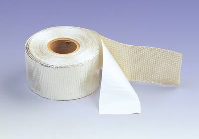

I use this $15 roll of heat tape from the same manufacturer, Thermo-Tec. You only need ~2ft.
You may be able to find it at your local speed shop that caters to drag racers or ricers.
