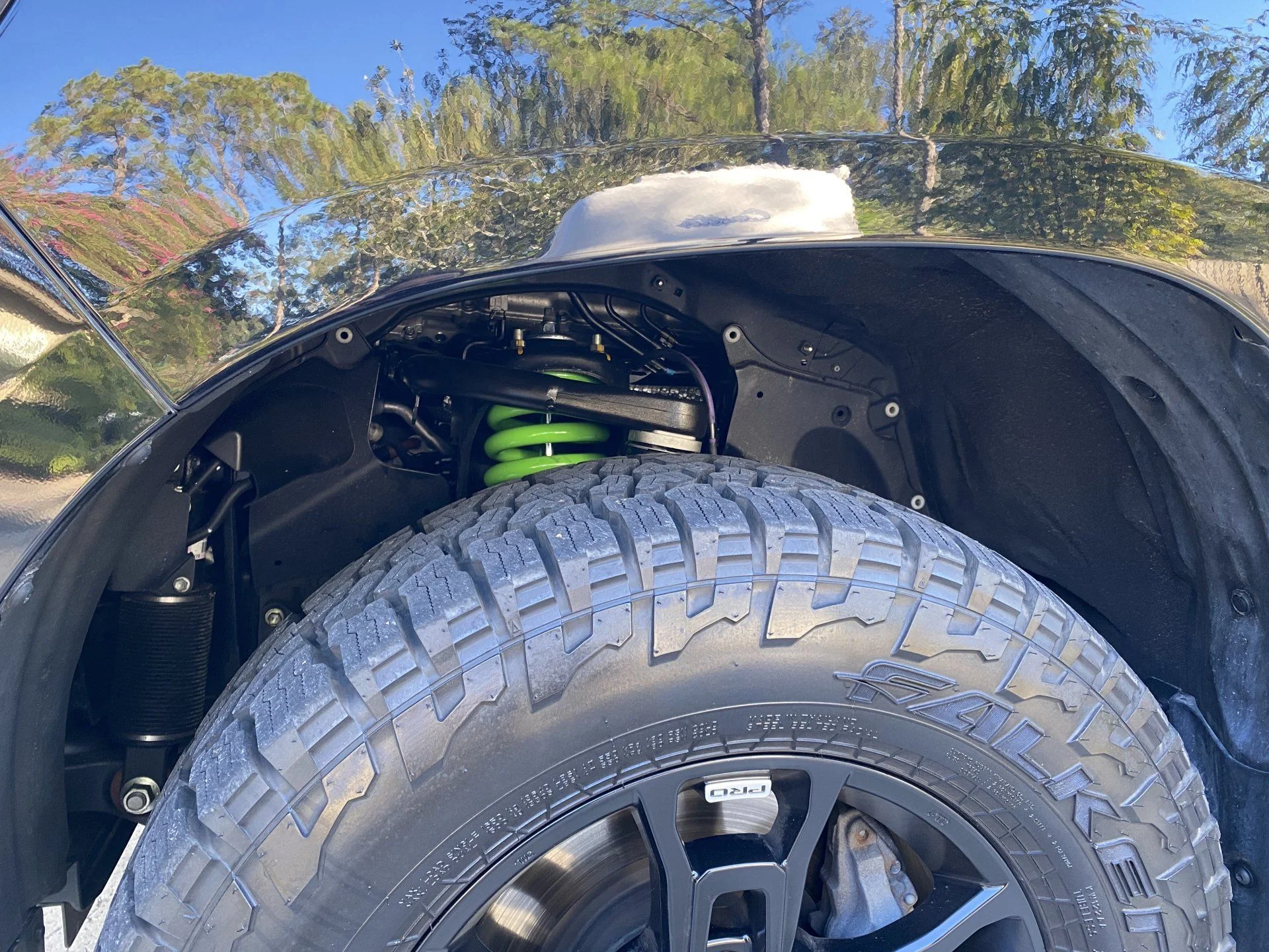

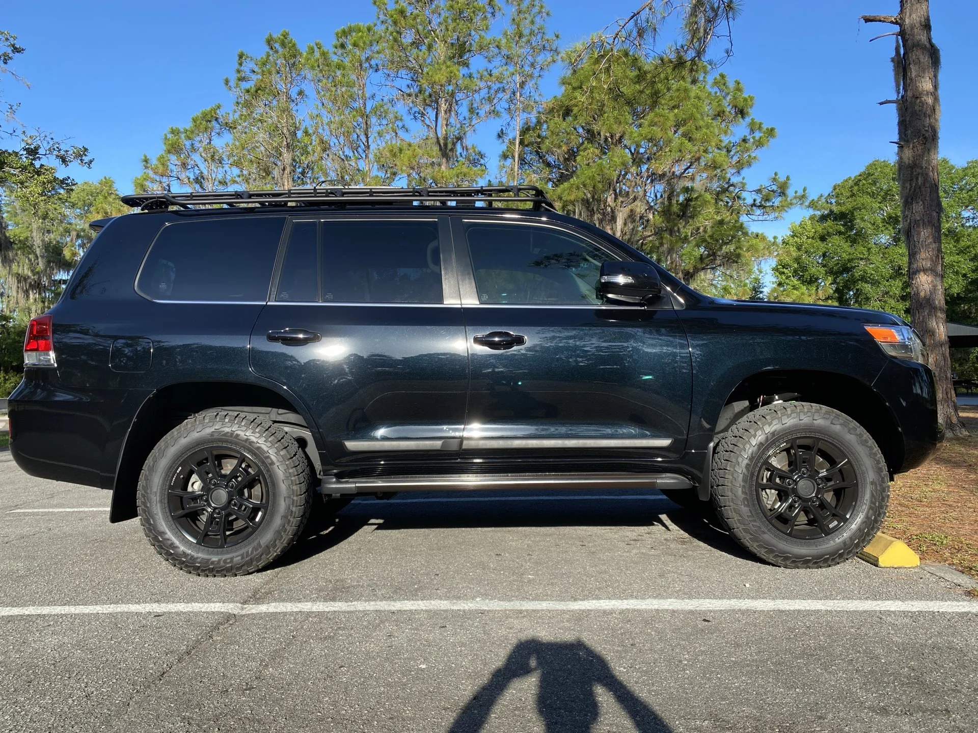

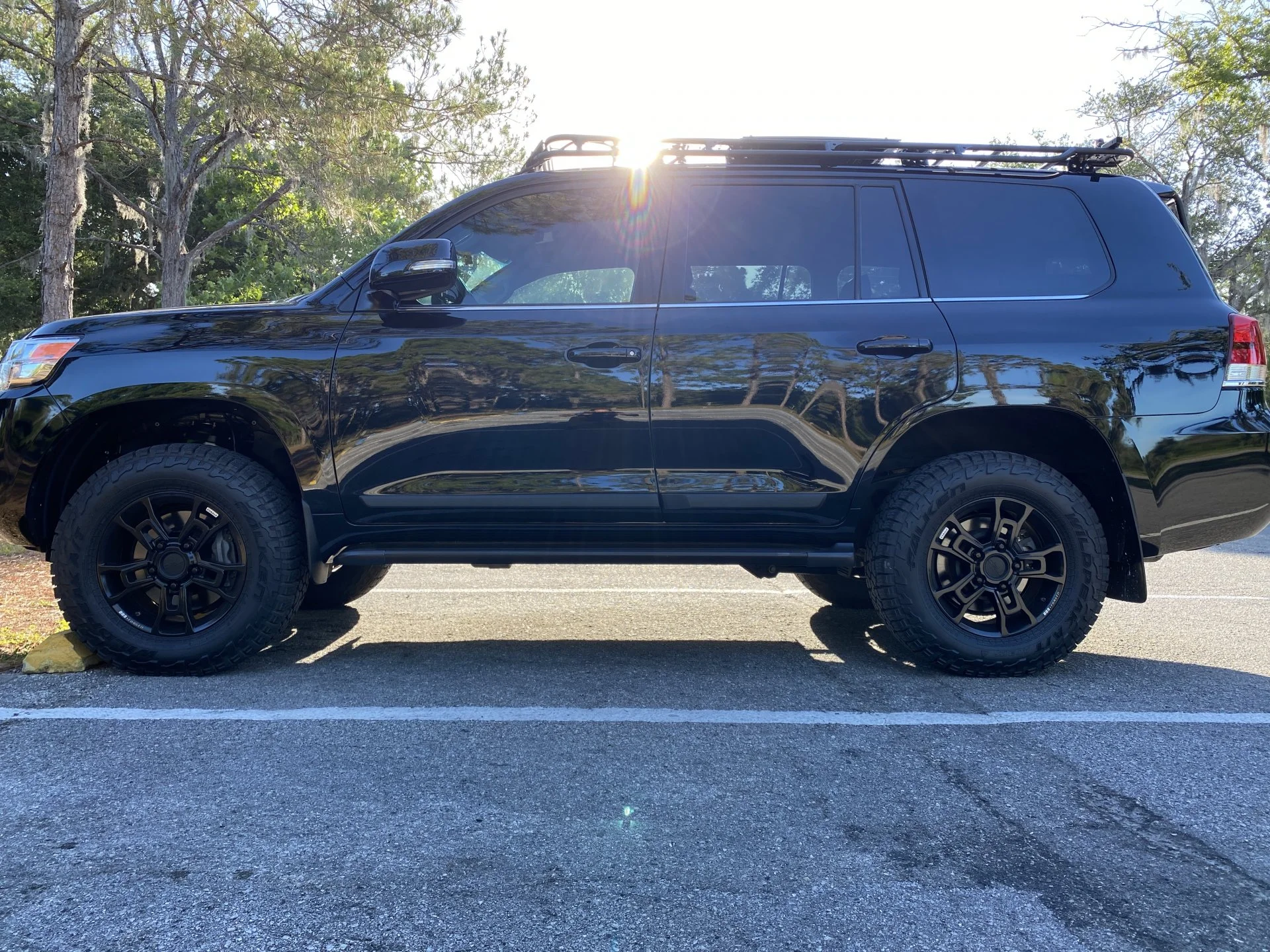

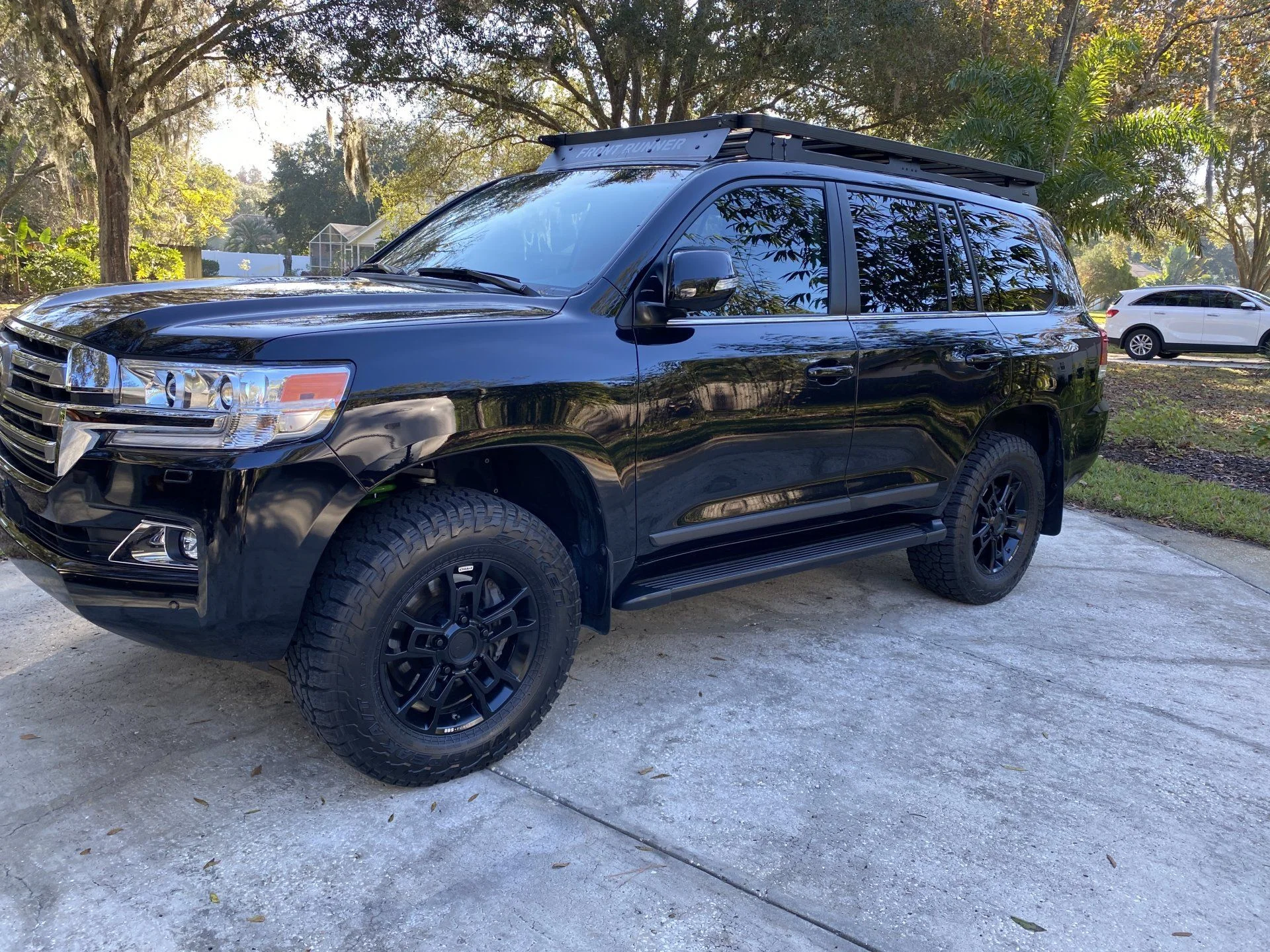

I didn’t need or want the adjustability of the BP-51s, so I went with the FCP 1” comfort lift and SPC UCAs. Very happy with that decision.
Good looking rig. This is the same lift I’m looking at. Any chance you have a couple of other pics? Would like to see a complete broad side view if not too much trouble. And how would you rate the ride around town just on a daily basis vs stock suspension? Thanks!!!
I’ll get a couple of additional pics next time I back out of my garage. 😂
Around town compared to the stock suspension, the FCPs are firmer and feel more “planted” without any harshness. I’m very pleased.
As promised:
