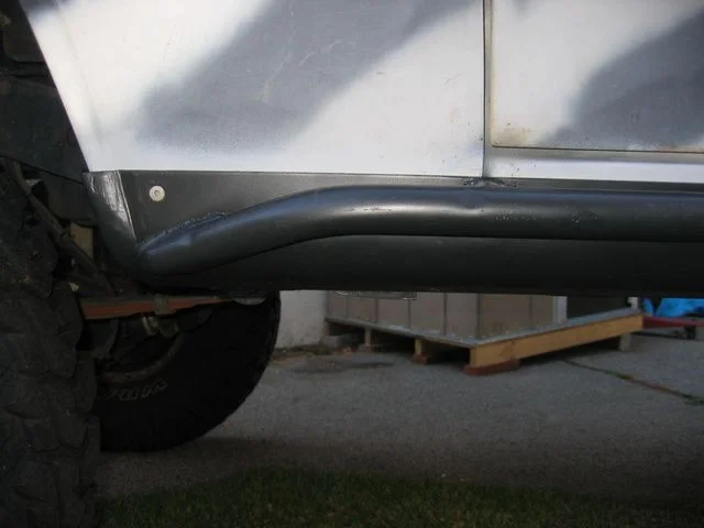

I will be aquiring a 55 come March and I was noticing that the rockers were a little rusty and bent.
I was wondering if anybody has installed the Iron Pig Offroad sliders?
How did it go?
Do you still like them?
Are they sturdy enough?
Do they just weld to the body in place of the current rockers?

I have given a lot of thought to using those sliders just to help out the clearance issues. I think a few people are using them with good luck.
So what 55 are you getting???
where do they attach to the body? just to the sheet metal? do they replace the inner door jamb too? can you do the same thing with 2x3 tube stock, you would just not have the contoured edge.
Nice install, Evan! Did you just through-bolt them to the rockers? I'm not sure I have enough metal left on mine to do that... sure would hide a lot of rust, though...

Kinda - I Foarmed the edges to fit the contour of the body and added nutserts to the body to hold it in place and reused the ft 10mm one that holds on the bottem of the fender.
Then i added way too many braces that also go to the body in 4 places , and even added a small jungle gym in front for max anti rock sheilding .

Thanks for the info, Evan. Clean looking. Yeah, I saw the corner guards. Mine aren't worth guarding (I might fit up a net to keep the Bondo from littering the trail...:rolleyes: ). Toying with trimming the rear fenders a bit (Pighead wants to help), but I'm on the edge of the resto vs. trail-ready conundrum, and I'd want to have a "stock-looking" mod, I think. Besides, we spent ALL our money on a major remodel/resto of our house last year, so options are slim right now.

Just so that no one gets confused. Yopper's rockers aren't the Iron Pig Offroad rocker reproductions. Yoppers rockers are 4x4 with steps. The reproduction rockers are formed 3/16" steel with the proper curve, they look very stock but provide a strong rocker for steps to be welded to.
A good example is Clay's 55
http://www.ironpigoffroad.com/images/spycam/fullfj55.jpg
Ryan.
