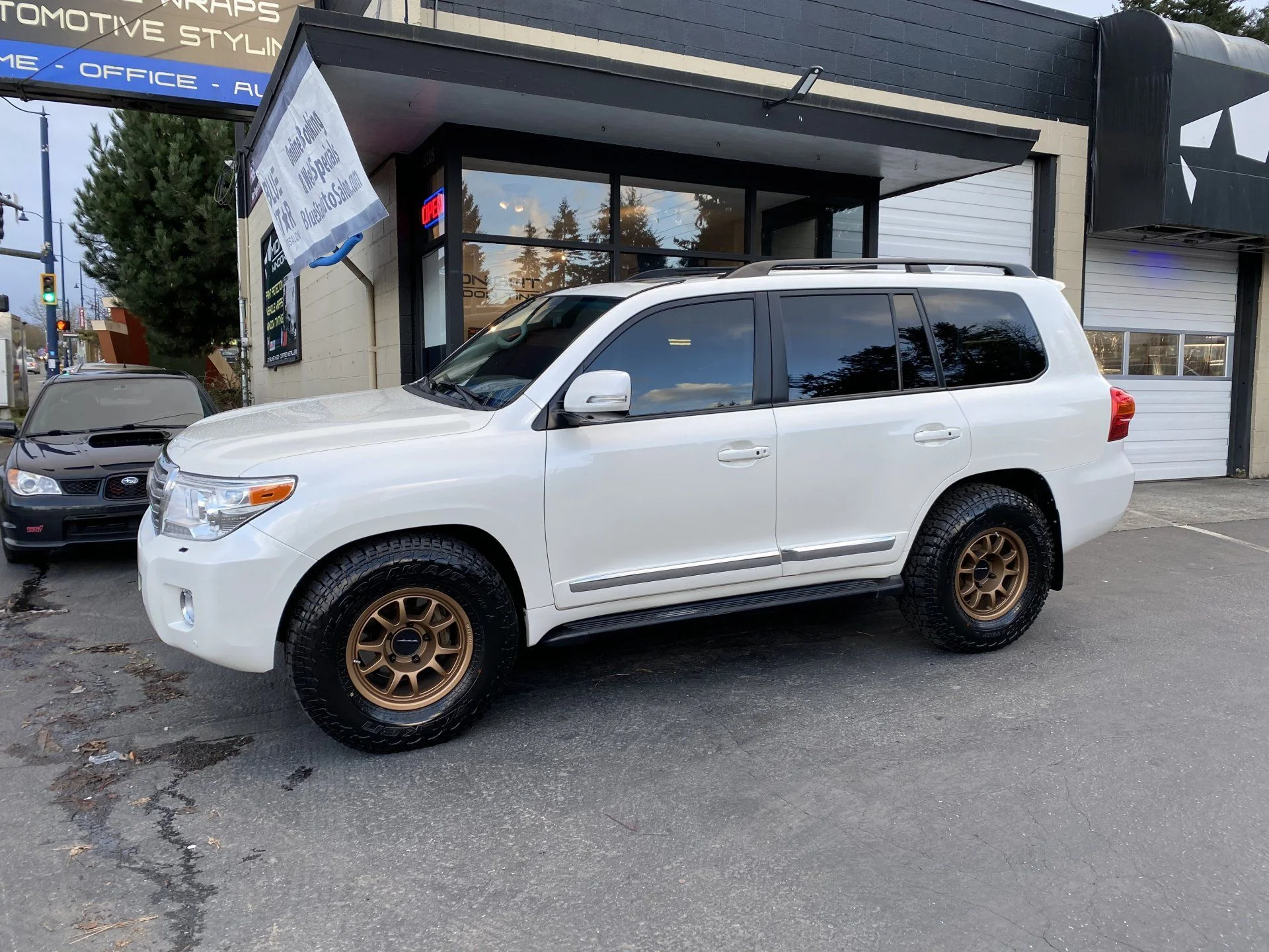

Completed today, ceramic coat and 15% tint on the front windows. 🙏🏽🙌🏽
wow, I guess I'll quit putting off my ceramic coat... blizzard pearl really is a great color. send a pic in the sunshine when you can!
I’ll probably get a pic in the sun tomorrow. I left it in the shop overnight to give it extra time to cure so I’ll be picking it up this evening :)

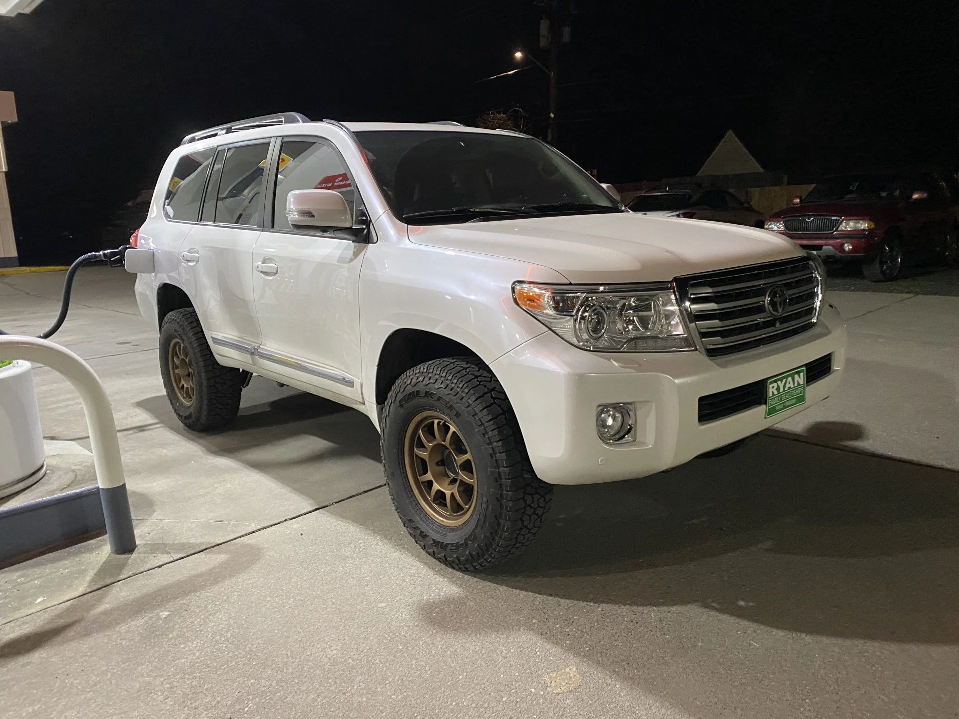

Got the lift on. Ended up with Bilstein 6112/5160 on the top perch (3” lift) combo with 2722’s on the rear. Also installed OME UCA’s.
installation took longer than anticipated but that’s how it always goes. Right?
The rear is sitting up real high (no weight in the back and rear seats removed). Drawers will be here soon. :)
Looking nice!!! I'm sure the back will settle eventually.
I'm planning to go perch 4. Not sure how it's going to turn out. Im waiting 9n thebome springs.
By looking at ur stance I may go 4 front and 3 back on th perch.
There are no perches in the rear.
the springs you use for the rear determine the lift.
