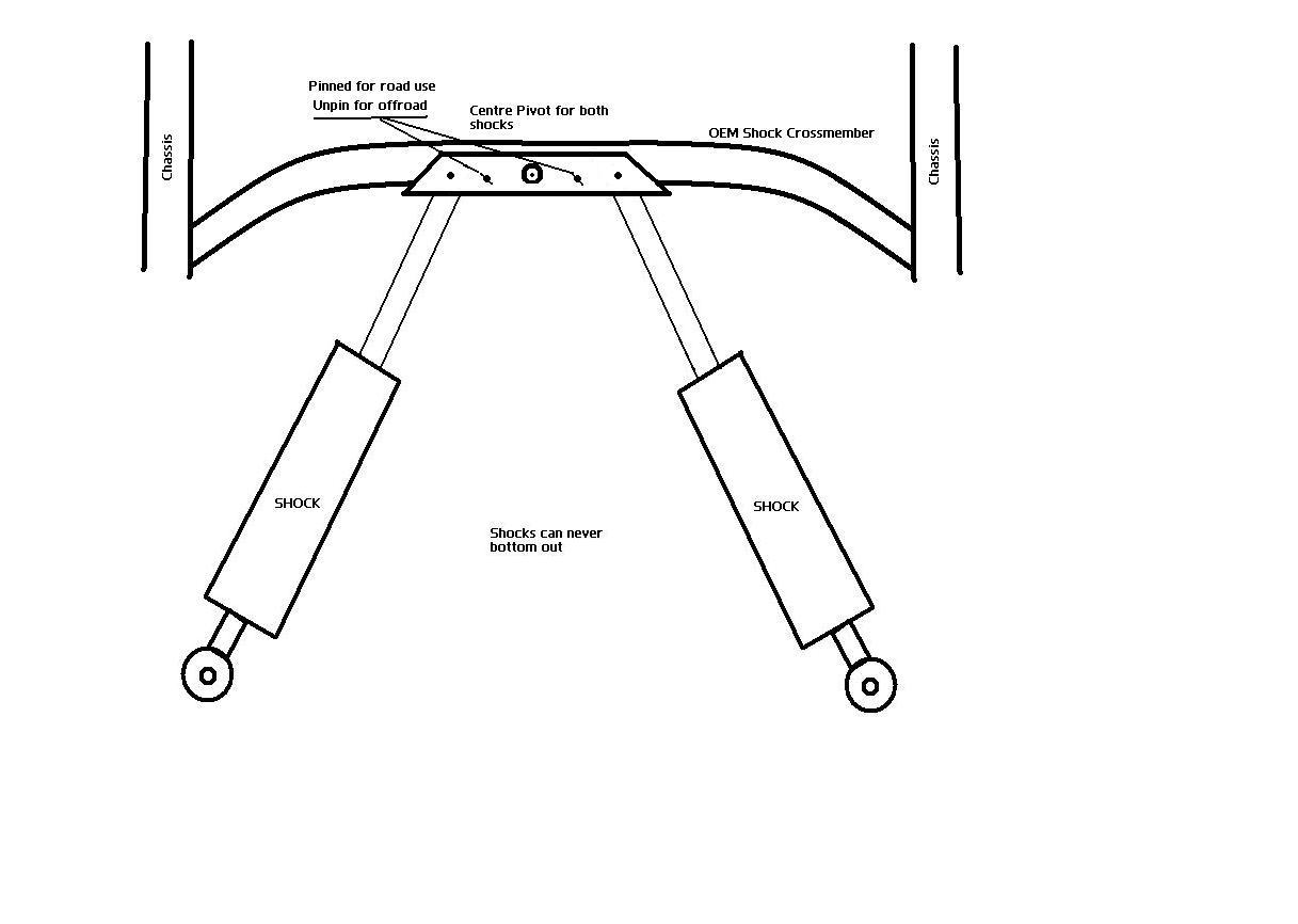

I had a brain fart at around 1:00 am last night
Ive been trying to find a way of making sure my rear shockies never bottom or top out when off road whilst still retaining the shocks themselves.
I was going to run long shocks and an inverted shock setup (like this / \ ) with long shockies, but i would still have bottoming out issues and a bit of topout.
Then i thought of this.
What ya rekon?
Interesting concept;) Im just wondering how the shocks will go without some resistance to push against.
there is always going to be resistance, remember if one shock goes up and the bracket moves up also, the other has to compress to accomidate the pivoting of the bracket.
Thus transfering the dampening effect through the shockies to the diff.
