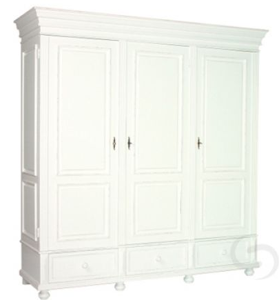

2" is no problem if you build the closets like a built in piece of furniture...
a pic from a quick search.. just make it deeper

Thicker GWB would add to the strength of the wall as well. Using wood 2x2 studs would be asking for a very warped wall. Like beafort said, build it like furniture usung 3/4" ply 12"oc as studs.
