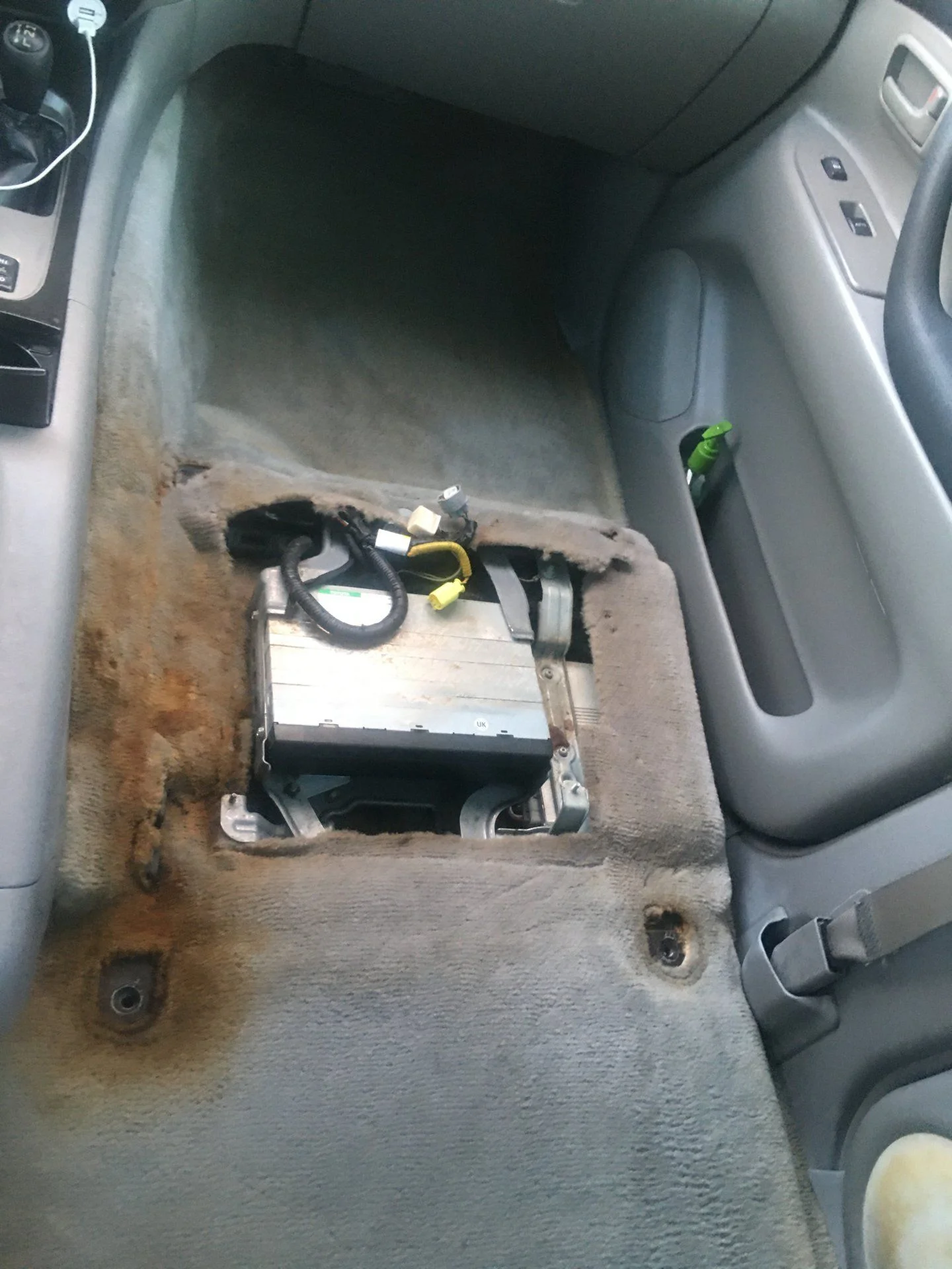

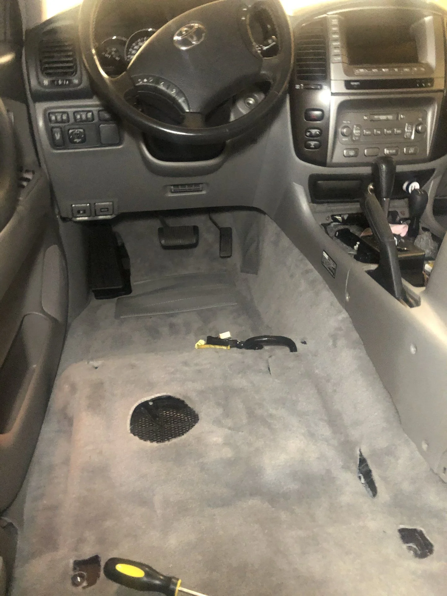

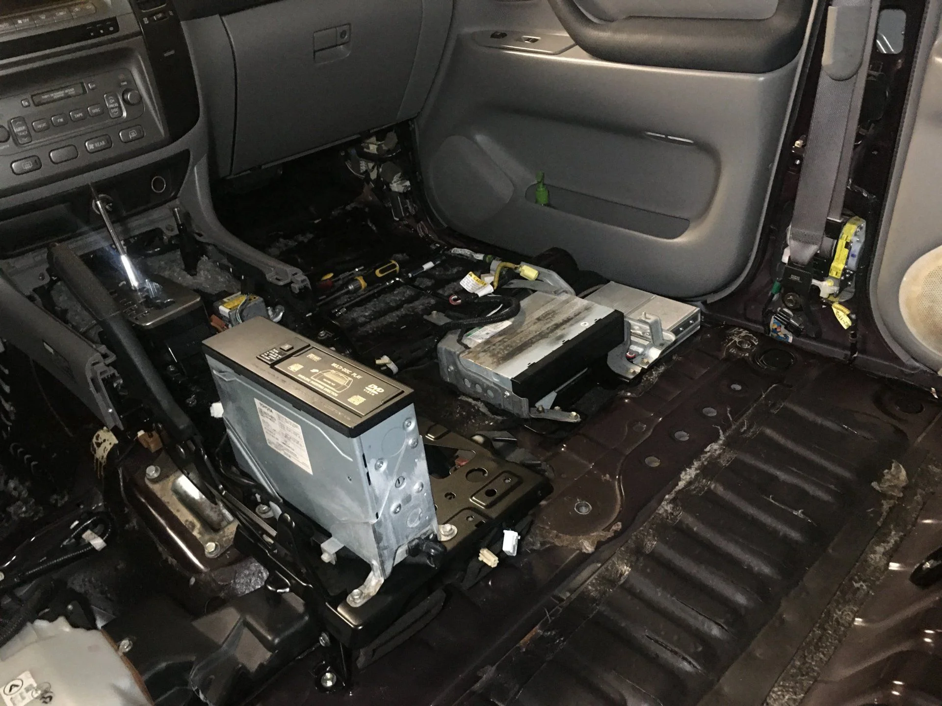

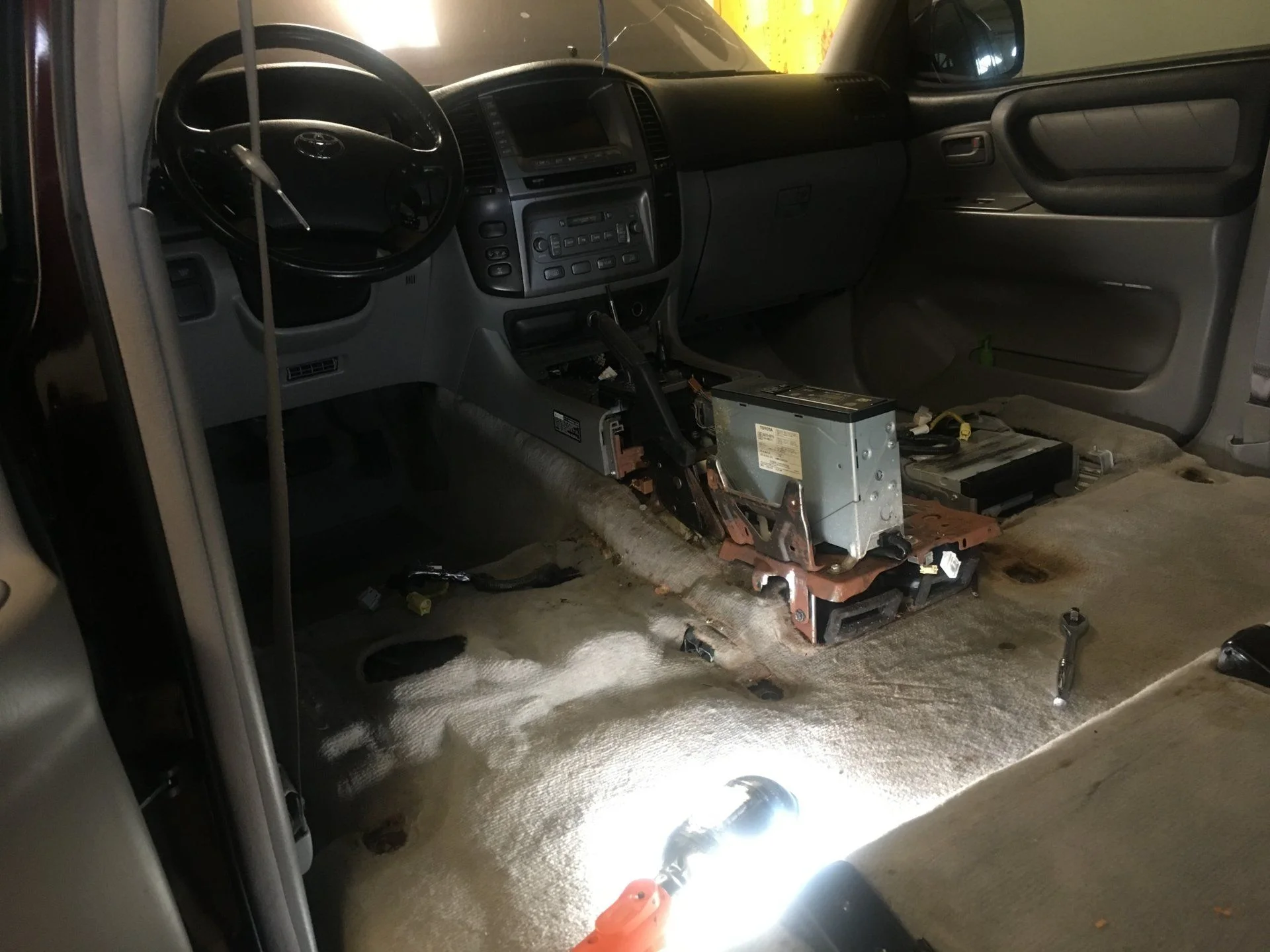

Decided to take action on the carpet which had irreparable stains.

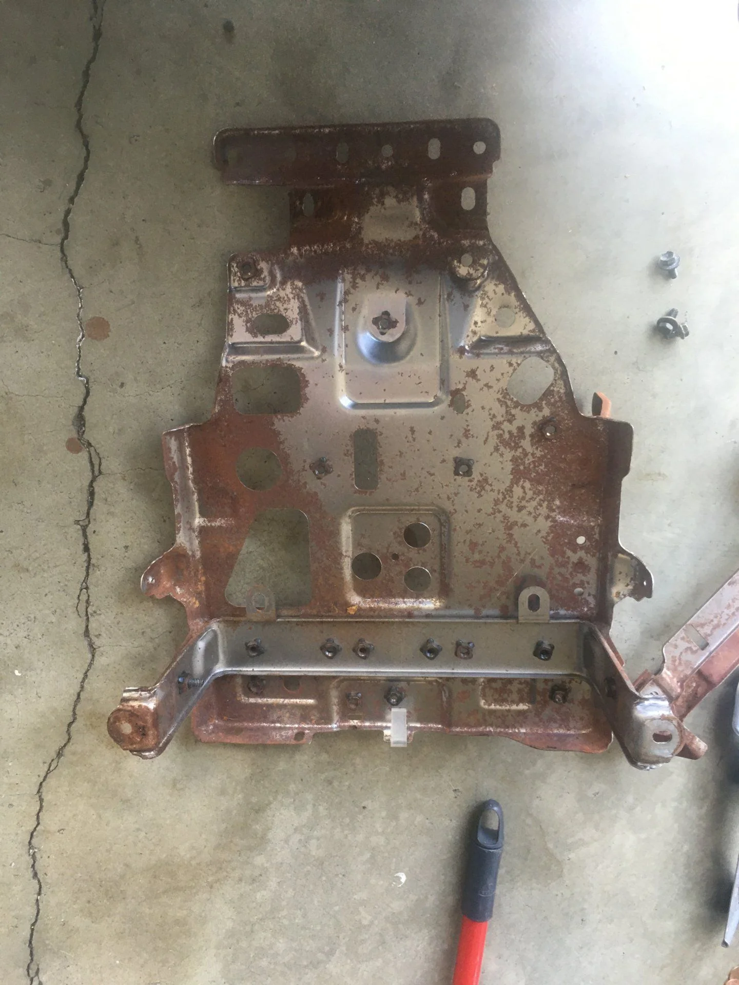

Center console base had rust!!! someone spilled lot of water and stuff seems like. Had to take the base off ...

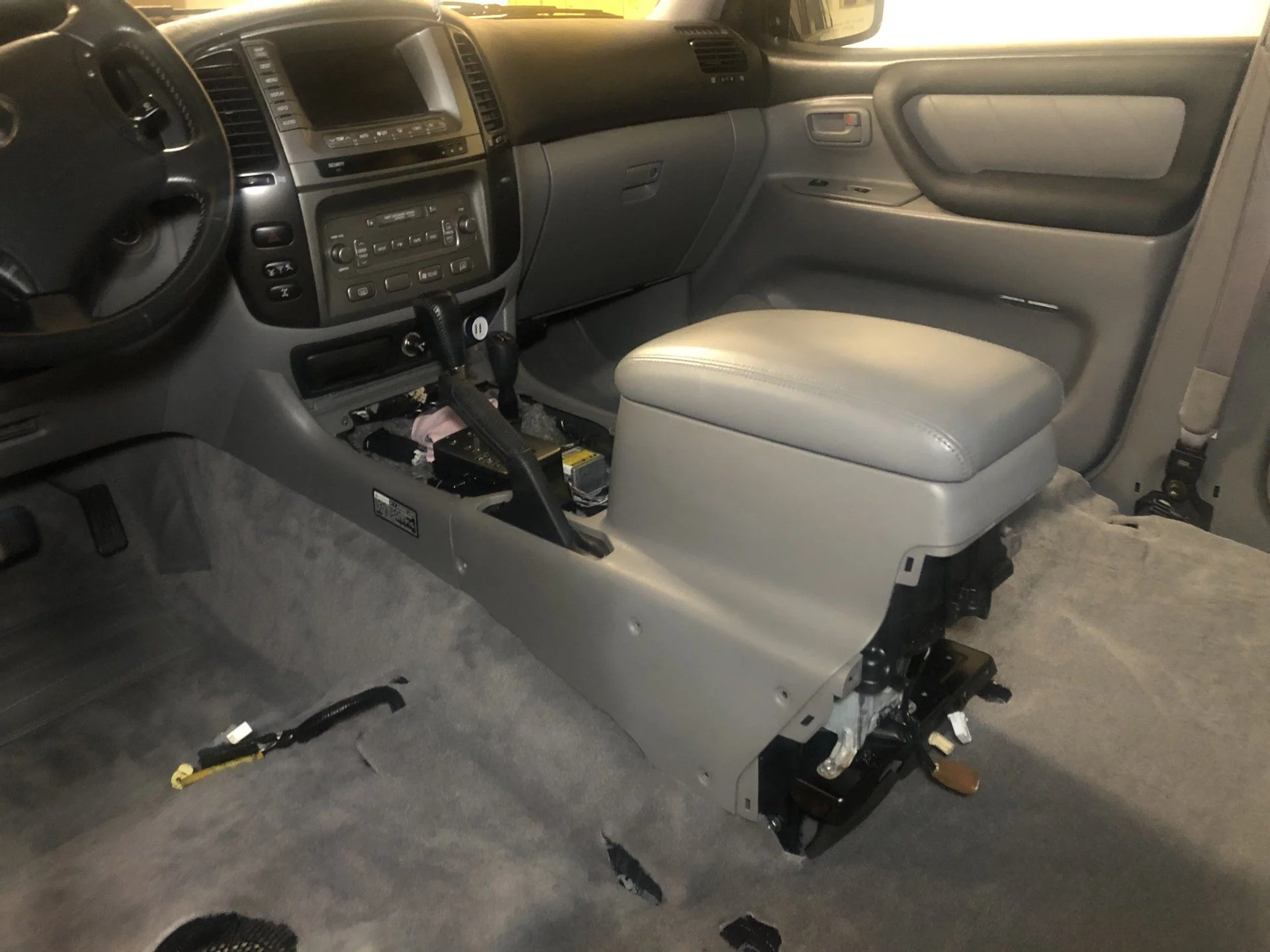

How hard was it to remove the center console portion. My cup holder cover has broken and is no longer attached and I wanted to remove that portion to see if I could have one of the guys build me a 3D printed cup holder that was a bit better.

Not hard at all. Remove the two shifter heads by turning counter-clockwise. Get the car in D or R (bring taller shifter back a bit). Open the ash tray and pull the ash tray up with the lid, while doing so hold the area where the ash tray connects to the console and gently pull up from there (middle I mean), it should pop up. There are no screws holding this down just 4 clips which will come OUT.

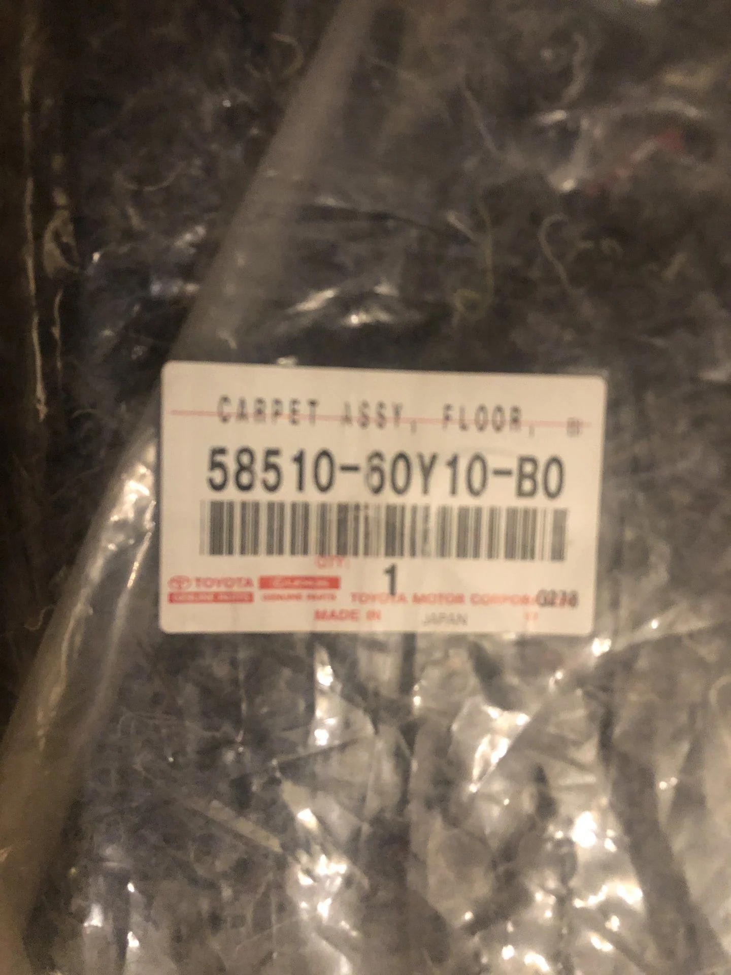

Great write up and pictures. Getting ready to do the same process here and put in new carpet (same color). Did you look at another options other than OEM? If so, which ones? Also, did you find OEM carpet anywhere for less than $940. Thanks!
