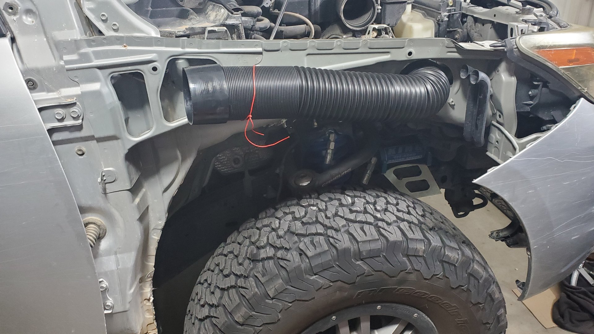

Since I removed my inner fender for tire clearance my intake is pretty exposed.
A lot of rocks have made their way into the filter box. I'm also a little concerned about water getting in there.
I originally wanted to get a tube into the cowl area but there isn't enough room.
I mocked this up, wondering if it will help or make things worse..
I really don't want a snorkel either.
IMO, you need something to isolate the part of the fender that air is being drawn from from the wheel well itself. There was a guy at LCDC that had a close call with ingesting water going through a minor water crossing a little faster than he should have. Part of his fender liner wasn't re-installed after his new bumper was put on. The air intake is essentially a shop vac sucking air from the wheel well. Without something to defect water, mud and dirt, you will likely get an excessive amount of crap in your air box. The filter will get dirty pretty fast if you go off pavement and will get wet with just road splash in rain.
Your tube will be better than nothing but I still think you need something to deflect wheel spray, splash, dirt and dust from the inlet.
I can't think of a better reason to install a snorkel that what you are dealing with.

This area is attached to the cowl area. Perhaps I open up the area some and add some wheel well deflectors.

To answer your question, I'd hesitate to locate it further aft. The tire will kick up dirt towards that spot rotating in the forward direction. I think you'll be better off pointing it forward, perhaps at the back of the headlight. Cleaner air there and it won't be in the wake of all the dirt/dust behind the tire.

I like where @Markuson is headed - if you do not have a dual battery, you could reorient the opening forward and get cool air from the front of the vehicle.
Alternatively, could you fabricate some replacement for the wheel liner splash shield that still provides tire clearance?
Does everyone think this would be better than going towards the rear of the fender?
I'll probably put a 4" diameter tube into the elbow so it doesn't collapse.
I'm not everyone either, but I have to say, with the options you've shown, I think you are at risk for ingesting things. If those are your options, a snorkel might be better.
Yup snorkel. Unless you can pull air from the other side of the box from the engine bay.
Unless you can figure out a way to put some kind of guard or something to deflect splash and spray, I think you need to go snorkel. Having an open “shop vac” nozzle in the wheel well is bad waiting to happen.

I live in a desert and don't normally do water crossings. For now I'll be running this and will block the top off more.

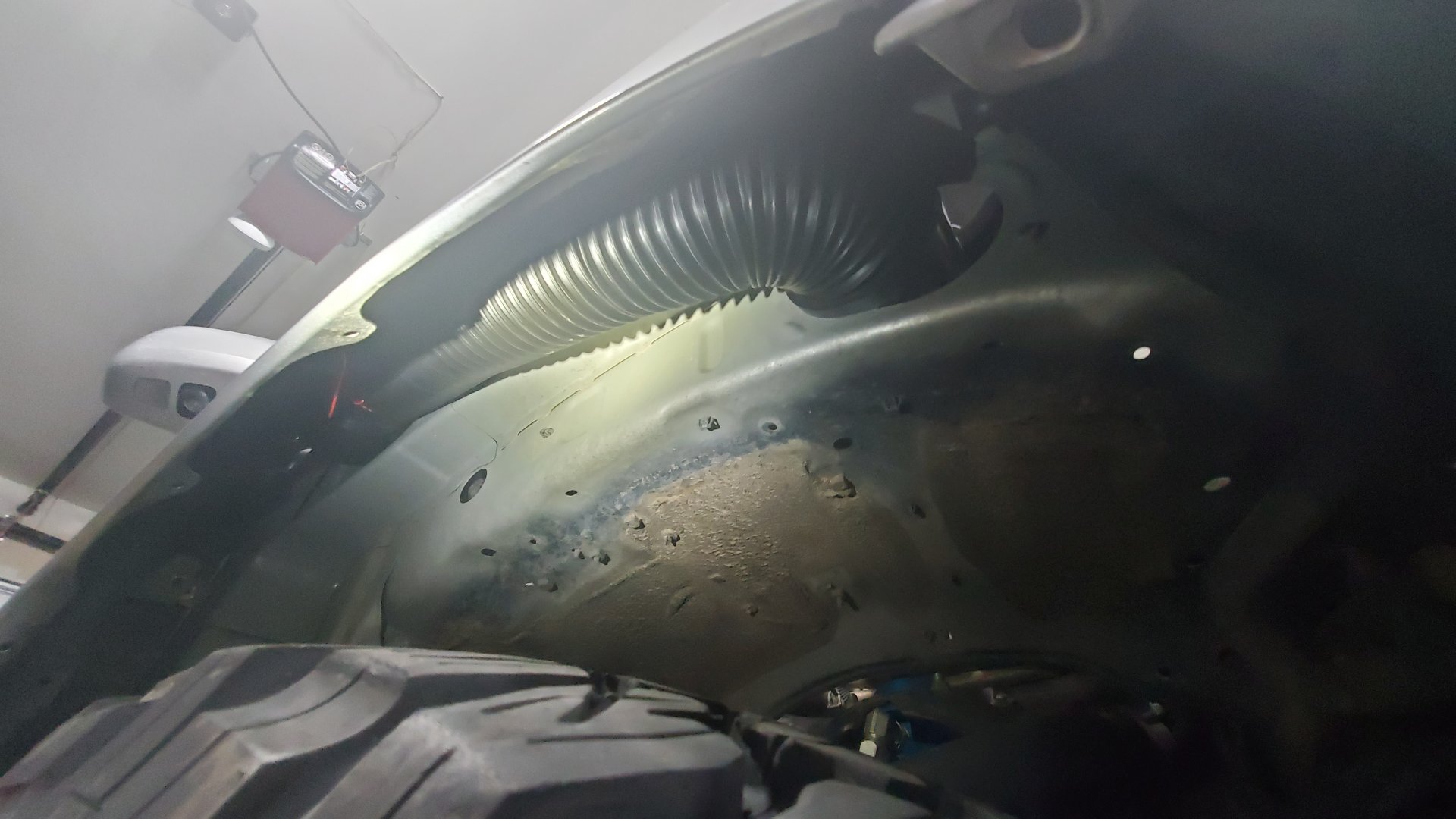

Had to cut it up and enlarge some holes, but I think it is good now
Looks good. Those inner wheel liners are cheap on rock auto if you need to make an adjustment. :nailbiting:
