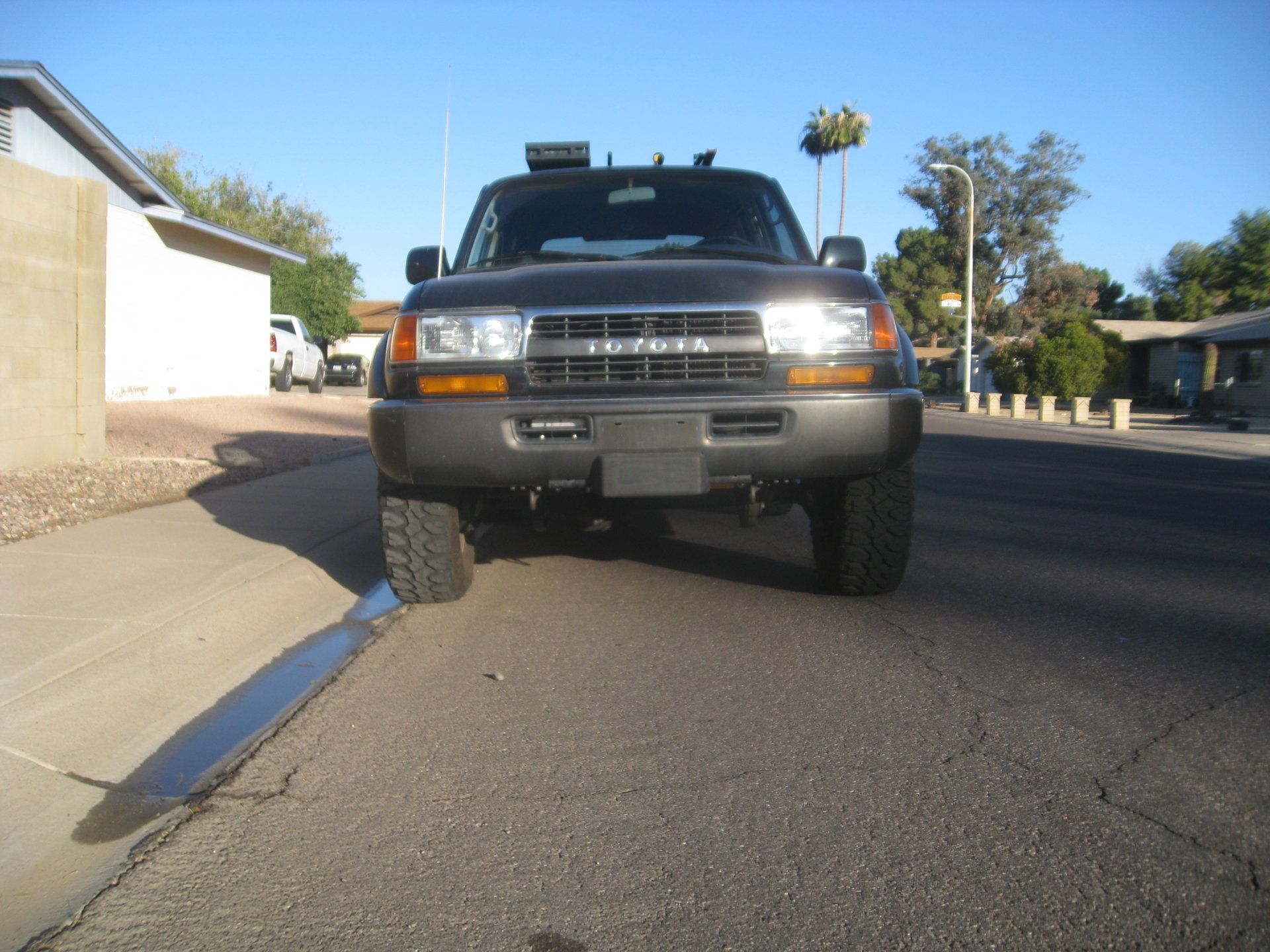

These measurements were all taken with 3/4 of a tank of fuel, 265-75-16 tires, a 100 pound Ramsey winch mounted under the stock front bumper, plus 100 pounds of recovery gear on the roof rack. With another 75 pounds of camping gear where the 3 RD row seats use to live, and a custom made swing out tire carrier mounted to the Passengers side of the stock rear bumper. I'm happy to report that after my install, my truck does NOT have the "stink bug" look, it's nice, and level.
