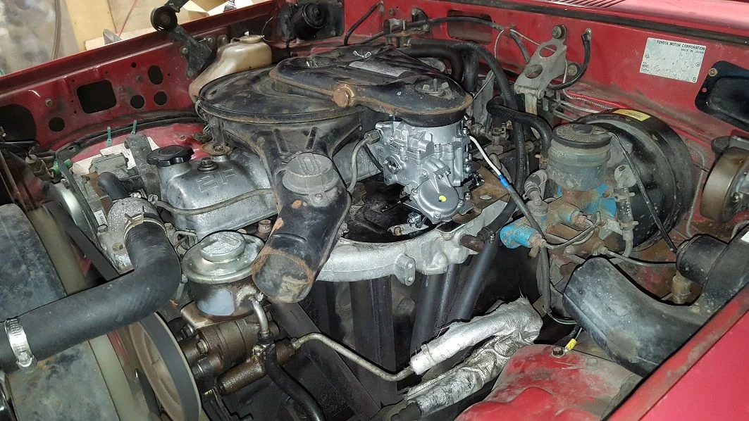

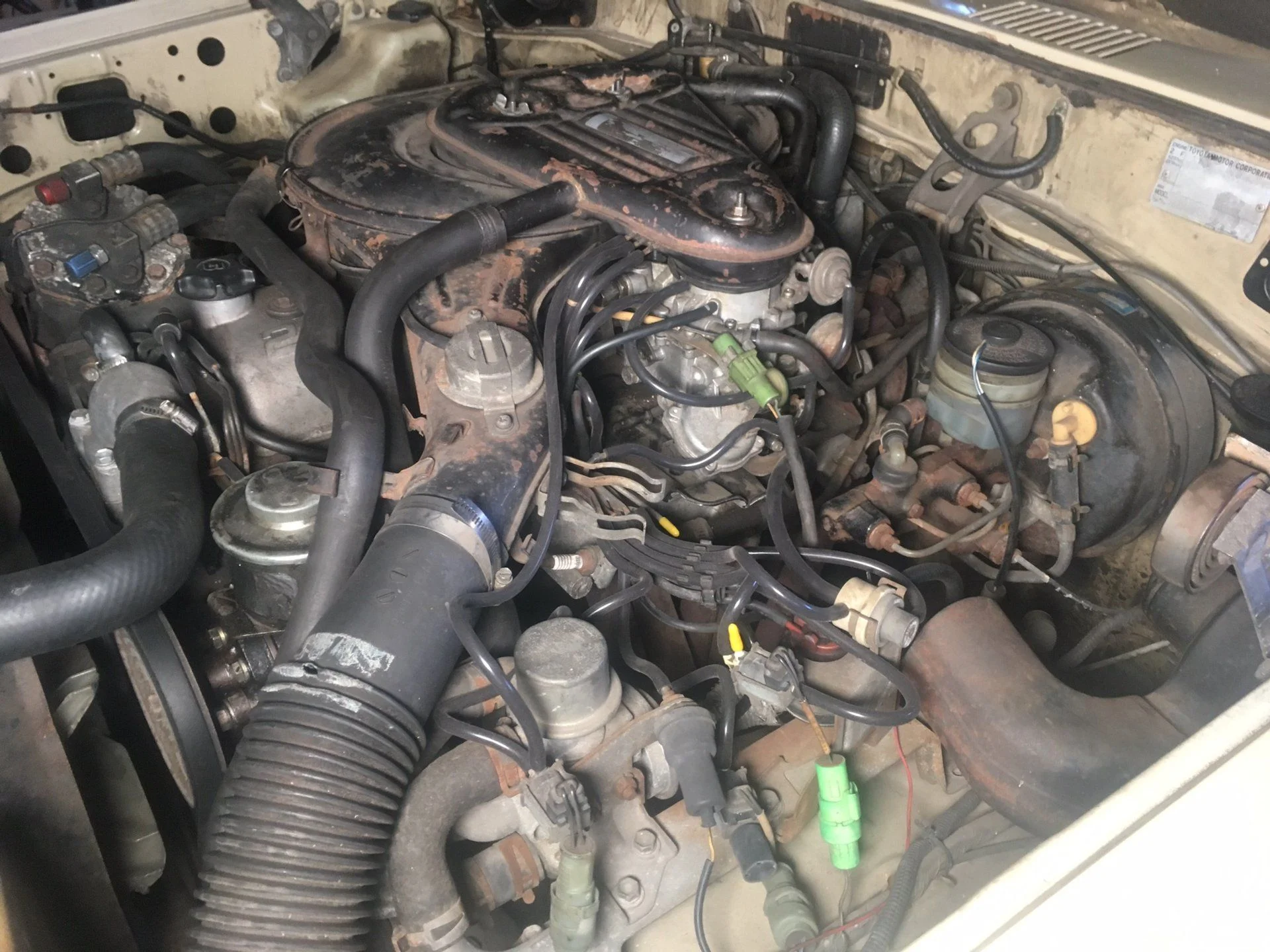

Can you post some pics of your engine bay for us. Can help tell the tale of your truck. Honestly, rebuilding the carb is not an overly hard job, :banana::banana: at most, you just need to pay close attention to small parts and @Pin_Head has some great video tutorials on YouTube (linked in the How-to section) for disassembly and reassembly. I am currently in the process of doing mine while I have a borrowed carb on the truck.
well you can go from that to this.
and this is with the very carb you're looking at.
if you are not required to pass a smog test/inspection there is no good reason not to gut it.
and i can assure you, it will run better, start quicker and generally be cleaner under the hood.
