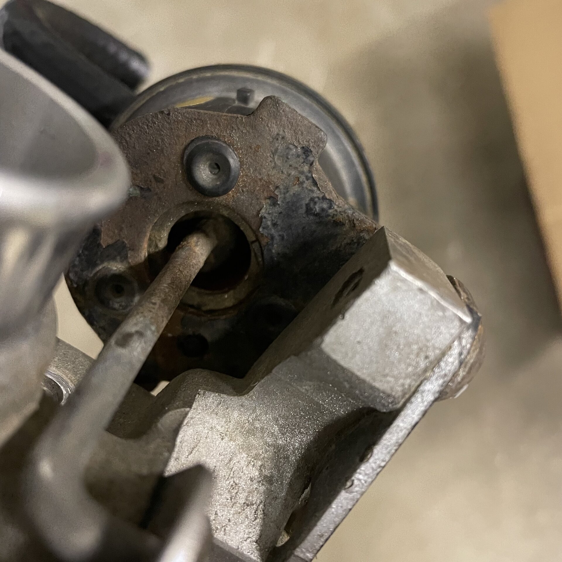

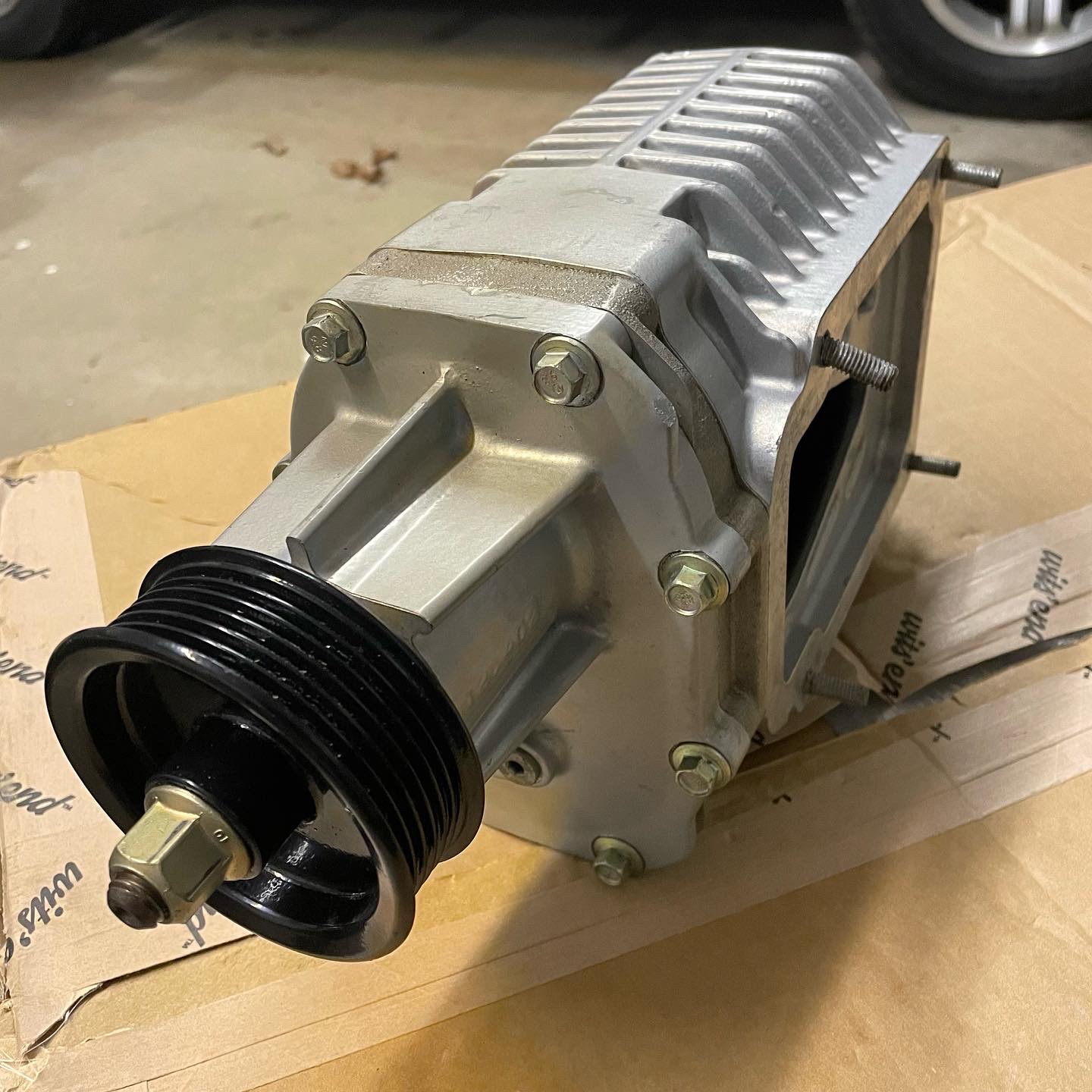

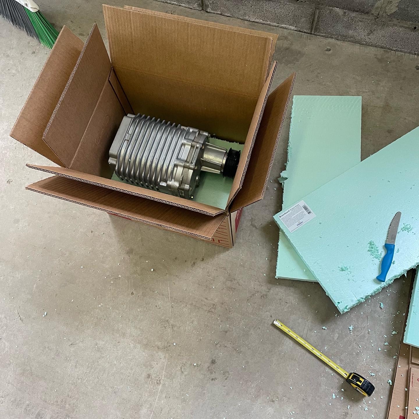

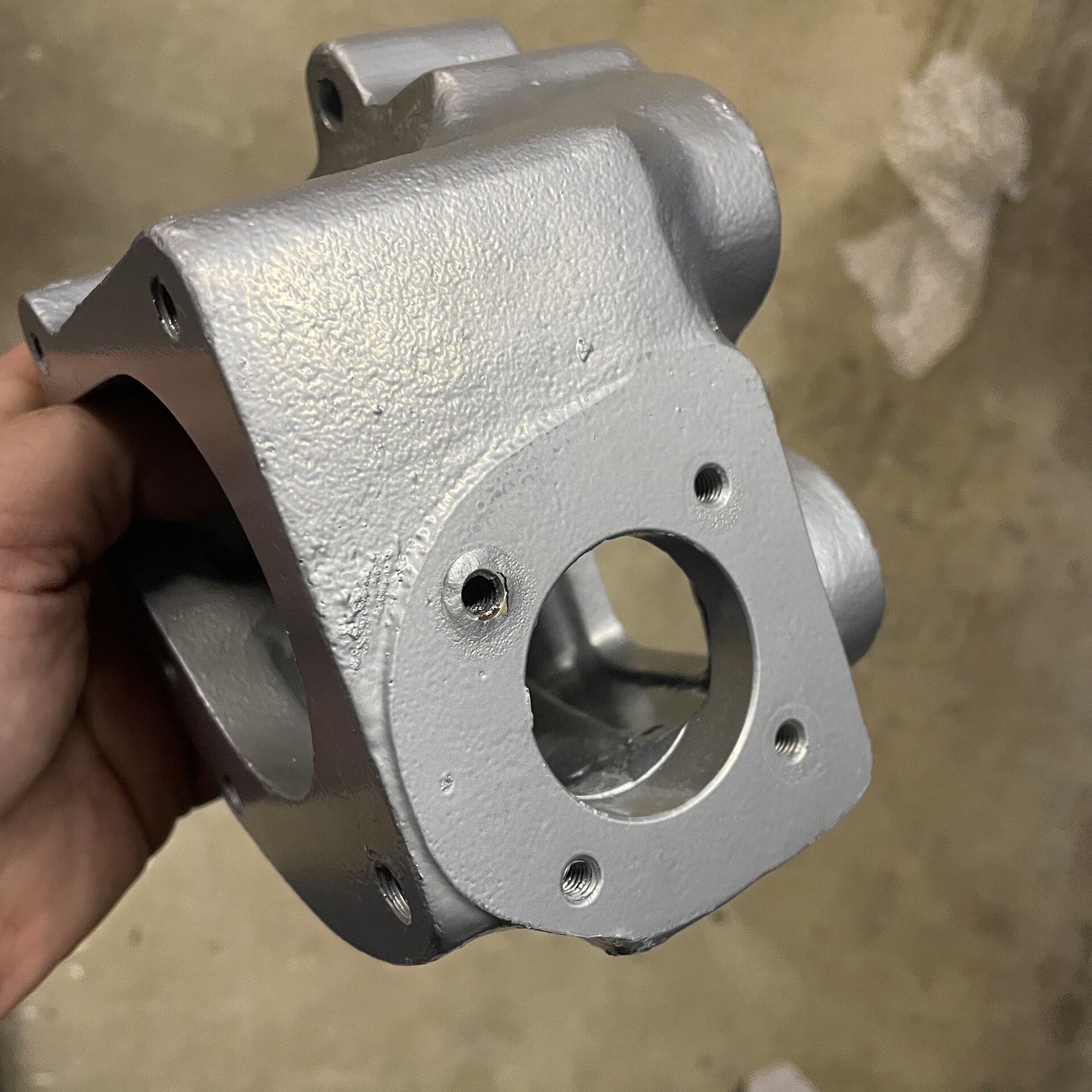

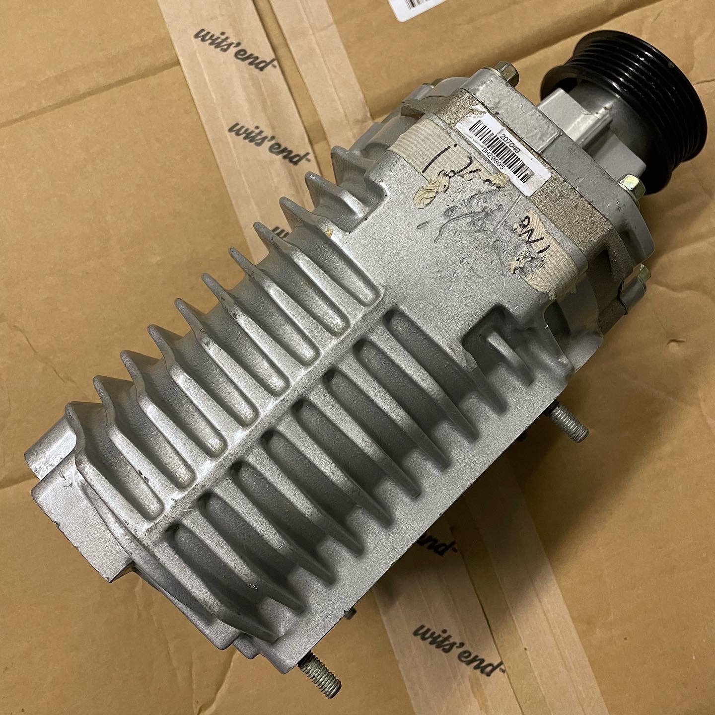

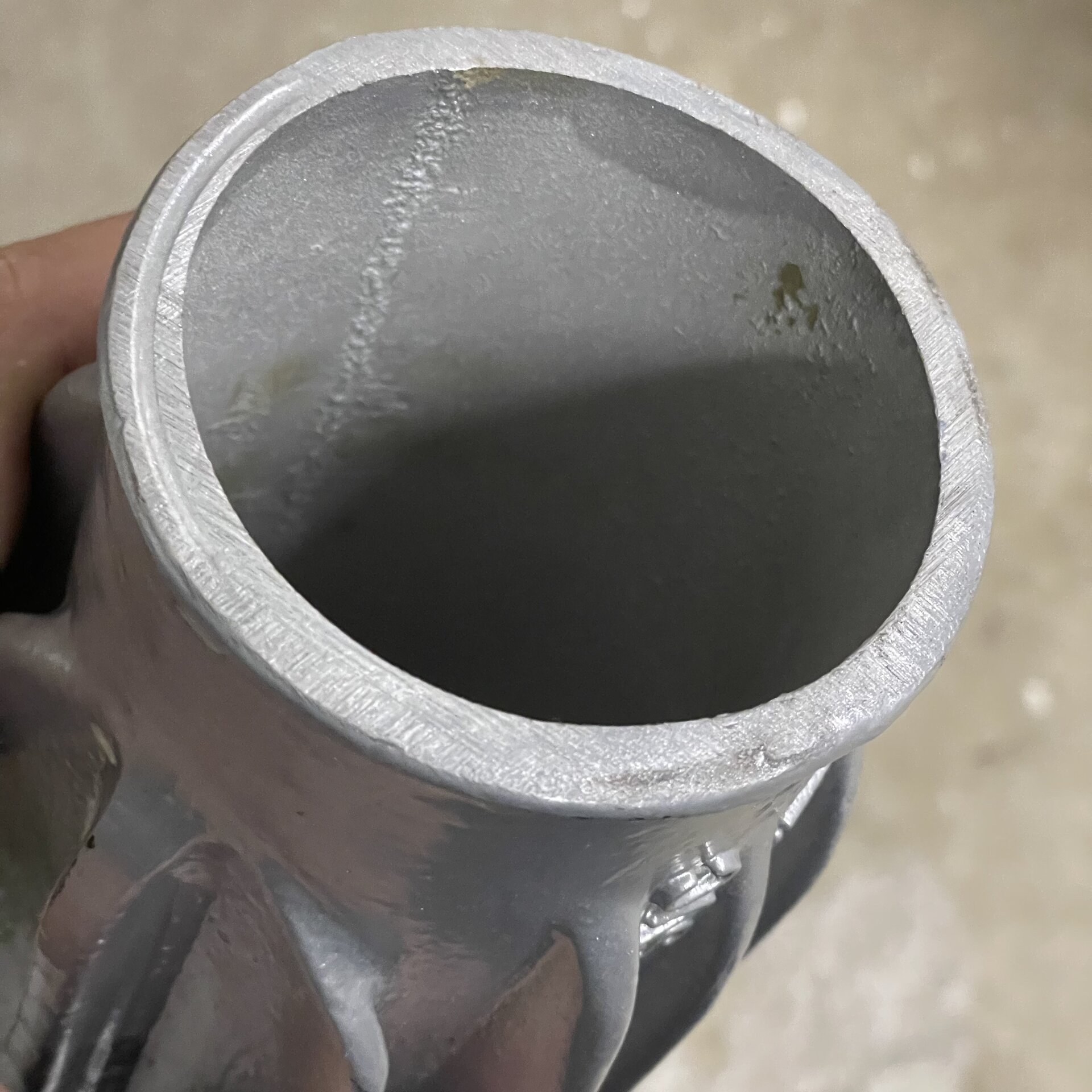

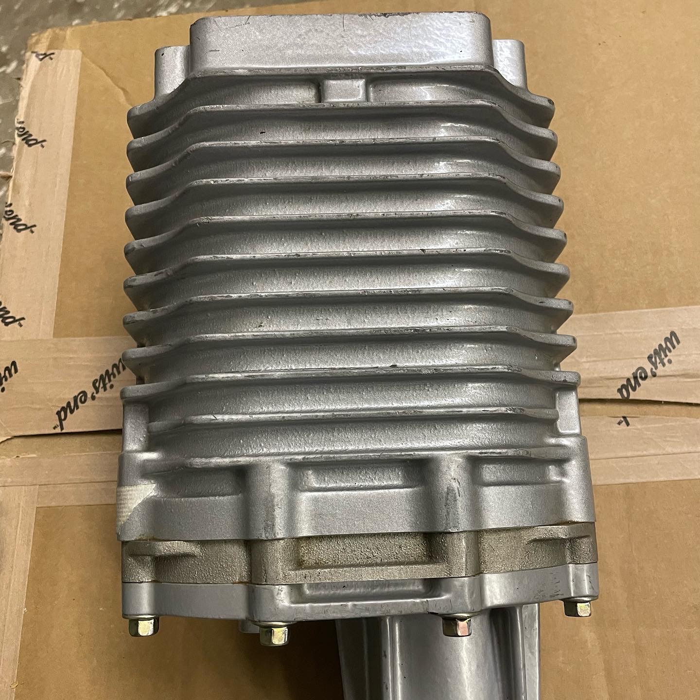

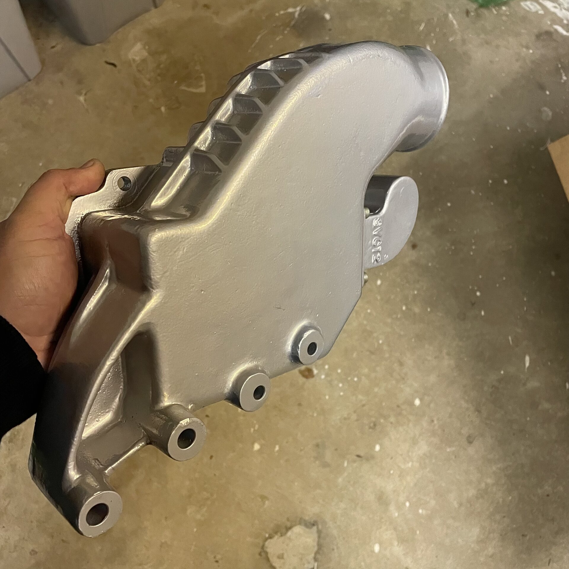

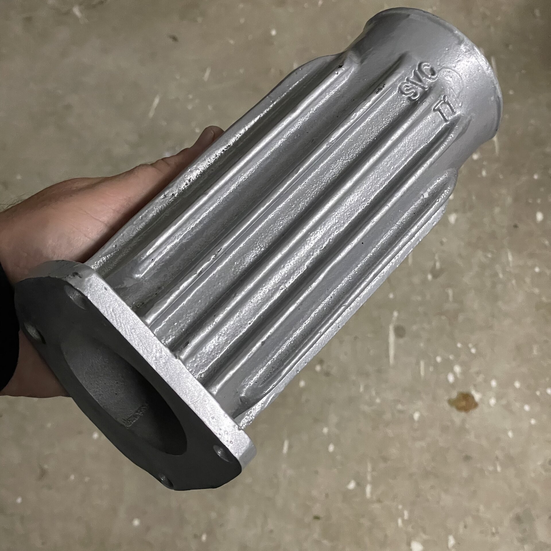

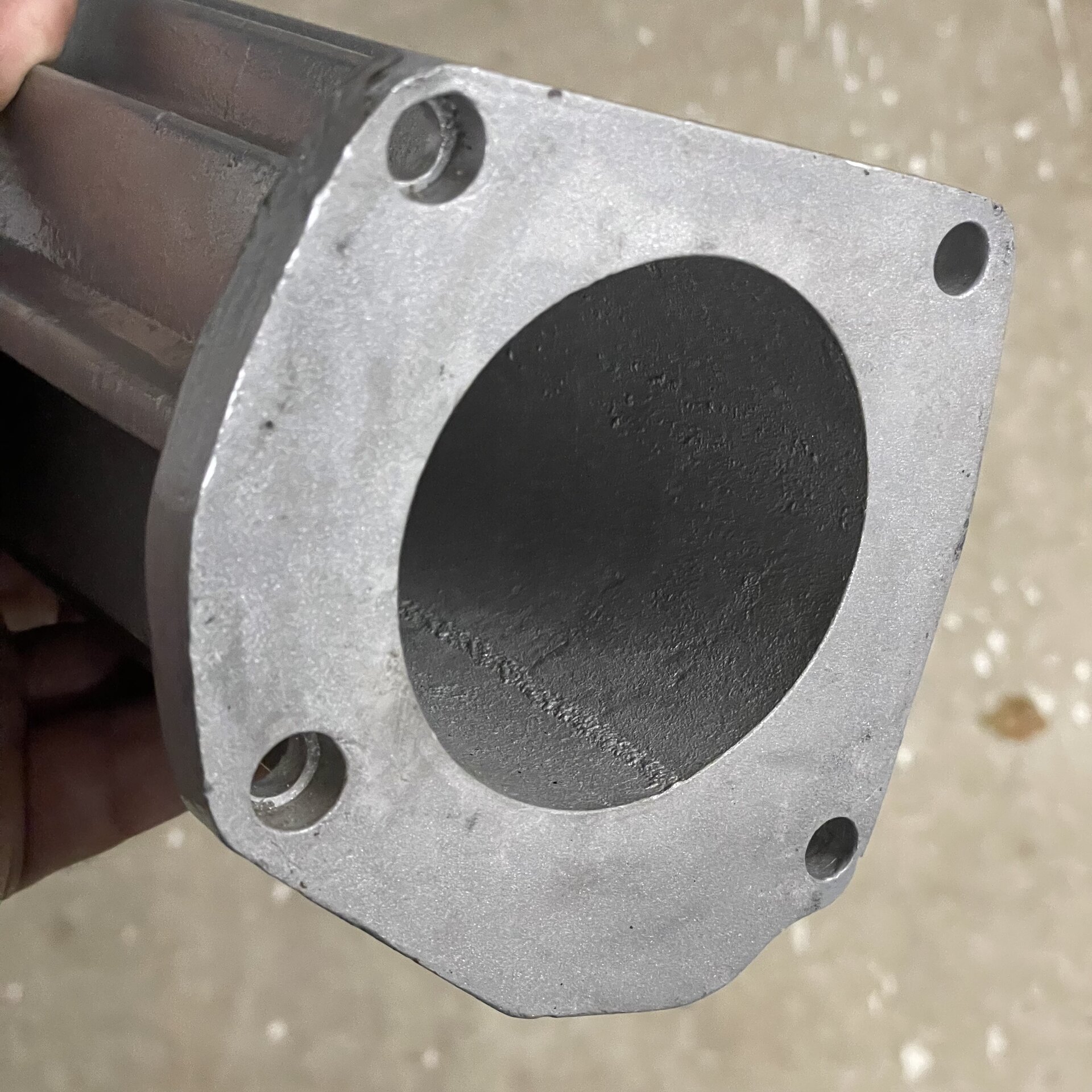

1. These first photos are of the case as it was delivered to me. Fairly good condition. One or more of the studs that secure the plenum to the case are bent and will need to be replaced. The rotors spin smooth from what I can tell. This is my first supercharger so I’m learning as I go.

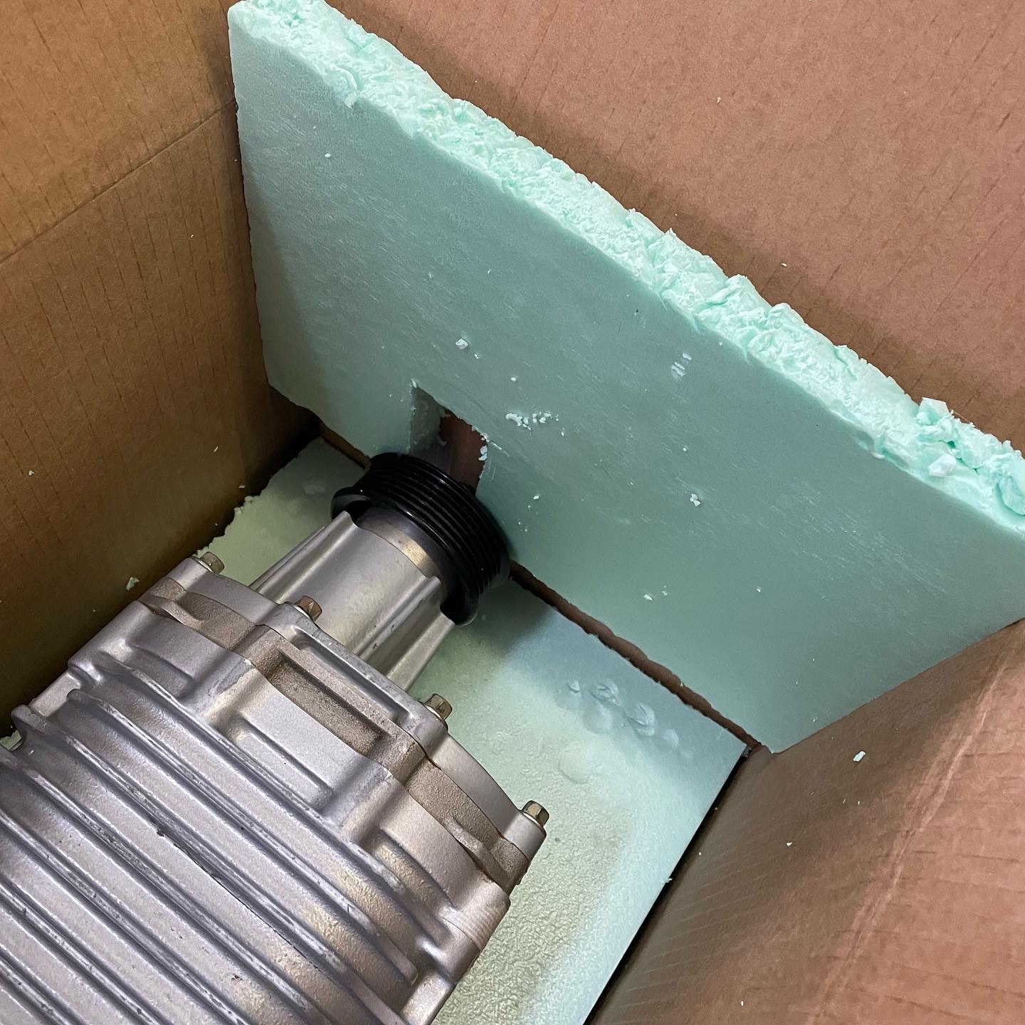

packed and shipped the sc to Jon Bond Perfornance last week. There is currently a 2 month backlog on rebuilds. easy online process. Fill out the form then print and include with your package. I decided to call to make the work appointment.

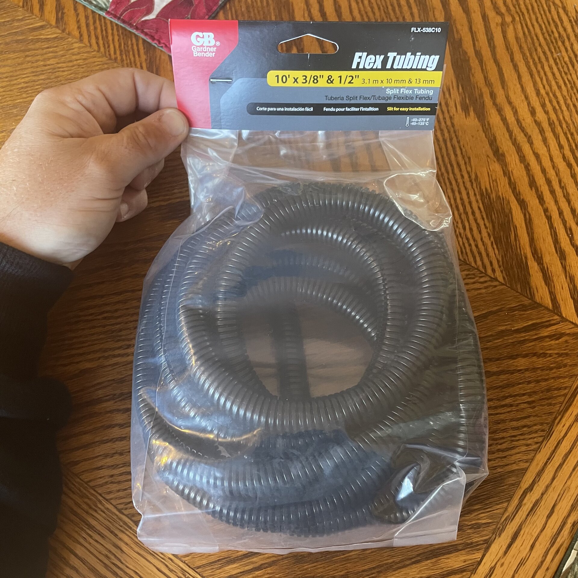

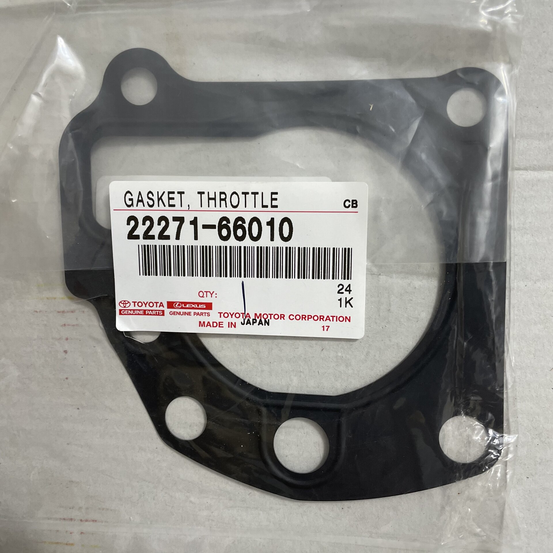

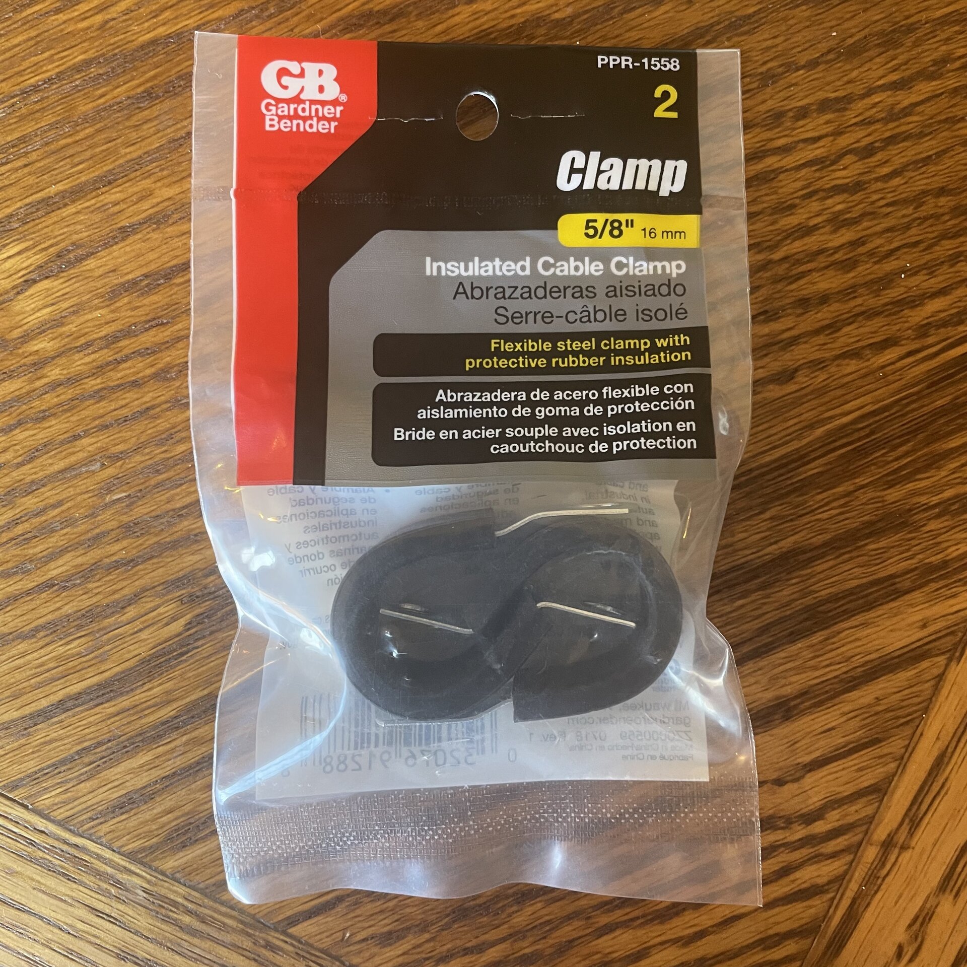

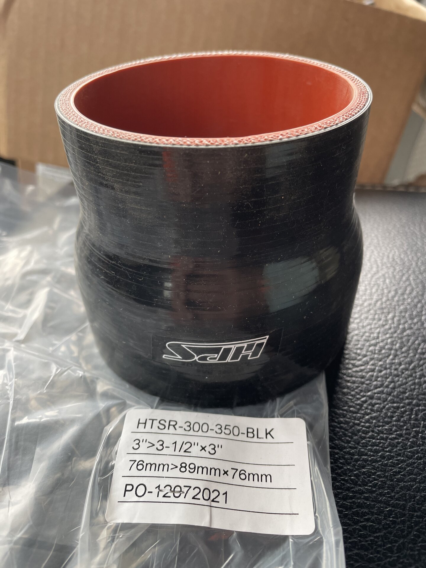

The plumbing and vacuum kit I received with the supercharger was essentially unusable. Parts were missing, the incorrect size or not even included in the original kit.
Home Depot to the rescue.
In the installation manual the rubber lined metal clamps are referred to as Adel clamps.
The continental spring tensioner was sourced from rock auto.

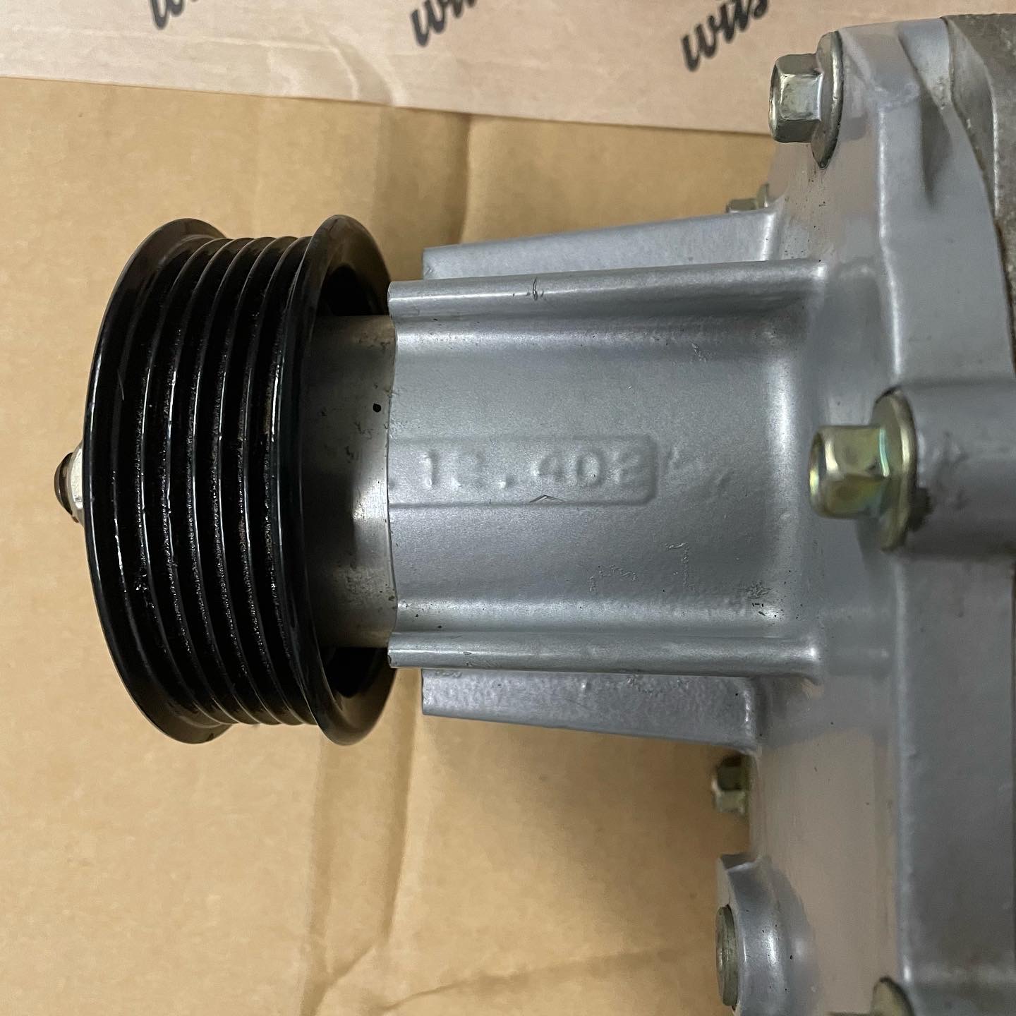

I bought my rig in 2010 with 92000 miles and a TRD super charger that was put on at 50000 with a new head gasket. I see redline almost daily, and I tow occasionally. I now have 258000 on the rig and it still runs fine. Only maintenance on the S C was new front bearings, seal, and oil because the seal was wheeling. I also installed a 2.8" pulley about 5 years ago. Makes a little over 8# of boost. I have lost the drive belt twice due to pulley bearing failures, both times on the trail, so I cleaned up the mess and drove home. No big deal. It drives about like a 3fe rig on the highway. 8# boost is really nothing for the 1fz. The Aussies are turboing these at 20-30# without a rebuild sometimes and they hold up quite well.

Not a Toyota built product. Blower is an Eaton m90/mp90. IIRC it was designed by TRD USA and it was magnuson that was chosen to supply parts and develope the kit. It was then marketed under the Kazuma label for a period by TRD. From thread below the unit was not developed until 2000, 3 years after state side 80 series production ended.

To my knowledge it’s a TRD supercharger. This version came after the Kazuma, but before the Magneson version. I could be wrong.
