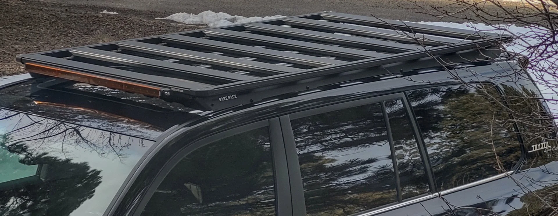

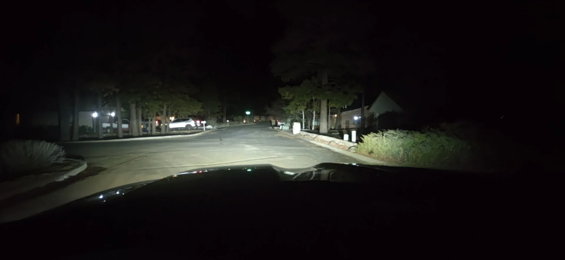

I finally had the dash switch installation for the ARB Slim Lightbar completed today The wiring loom ran to the hatchback thru the rack, into the headliner to the driver side sill trough
Installation of the wiring loom and switch took my installer around four hours.

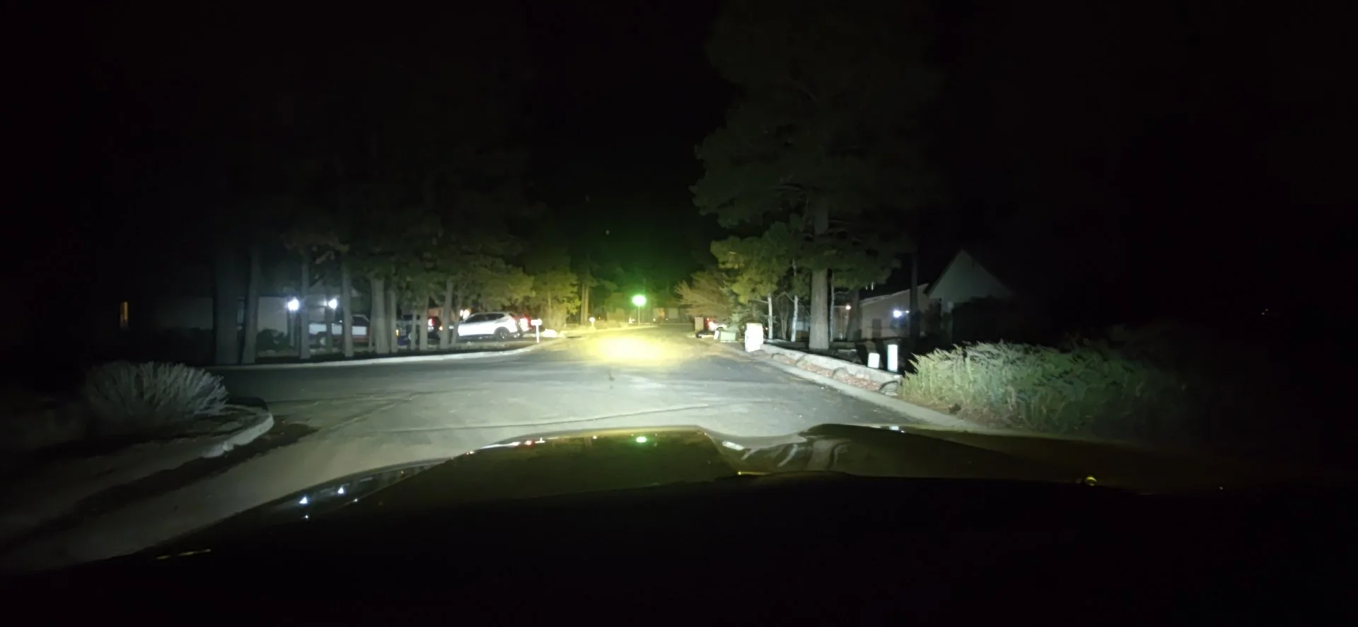

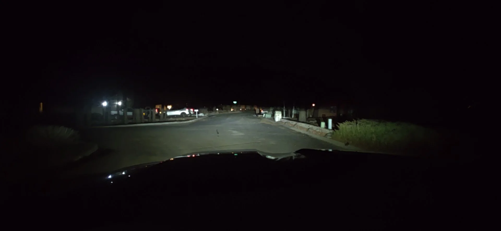

Photo #1: lights only on low beam position.

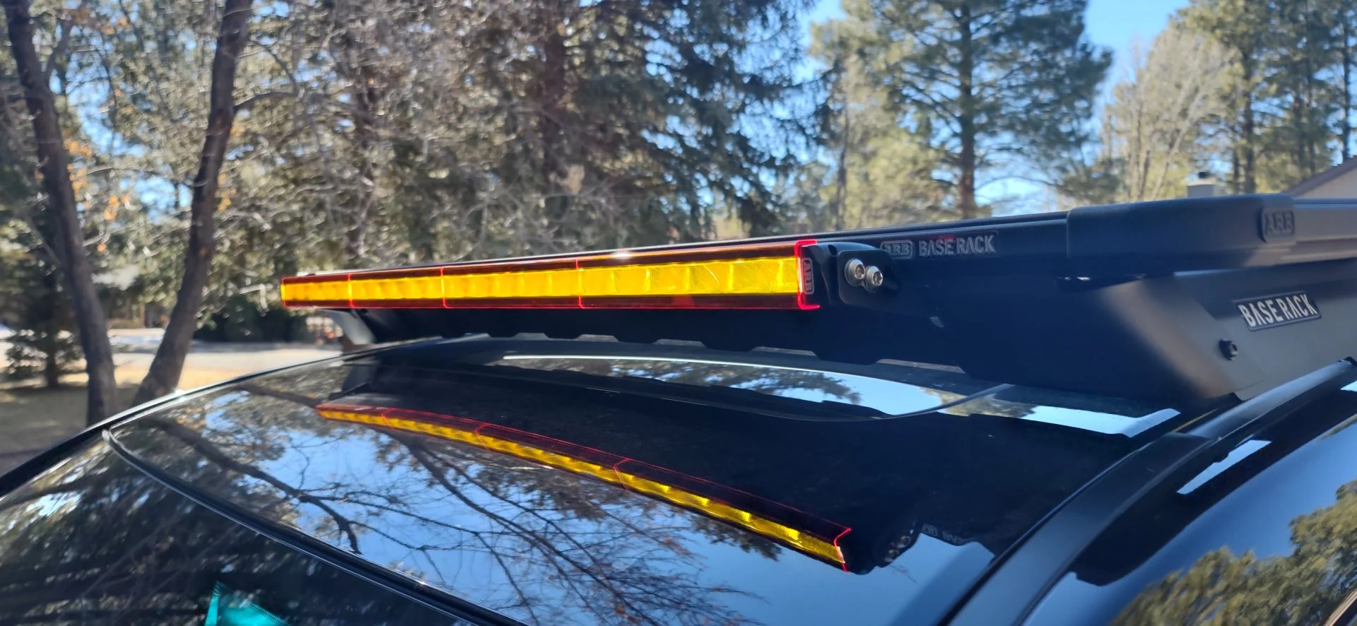

Photo#2 :lightbar w/ Amber covers on.

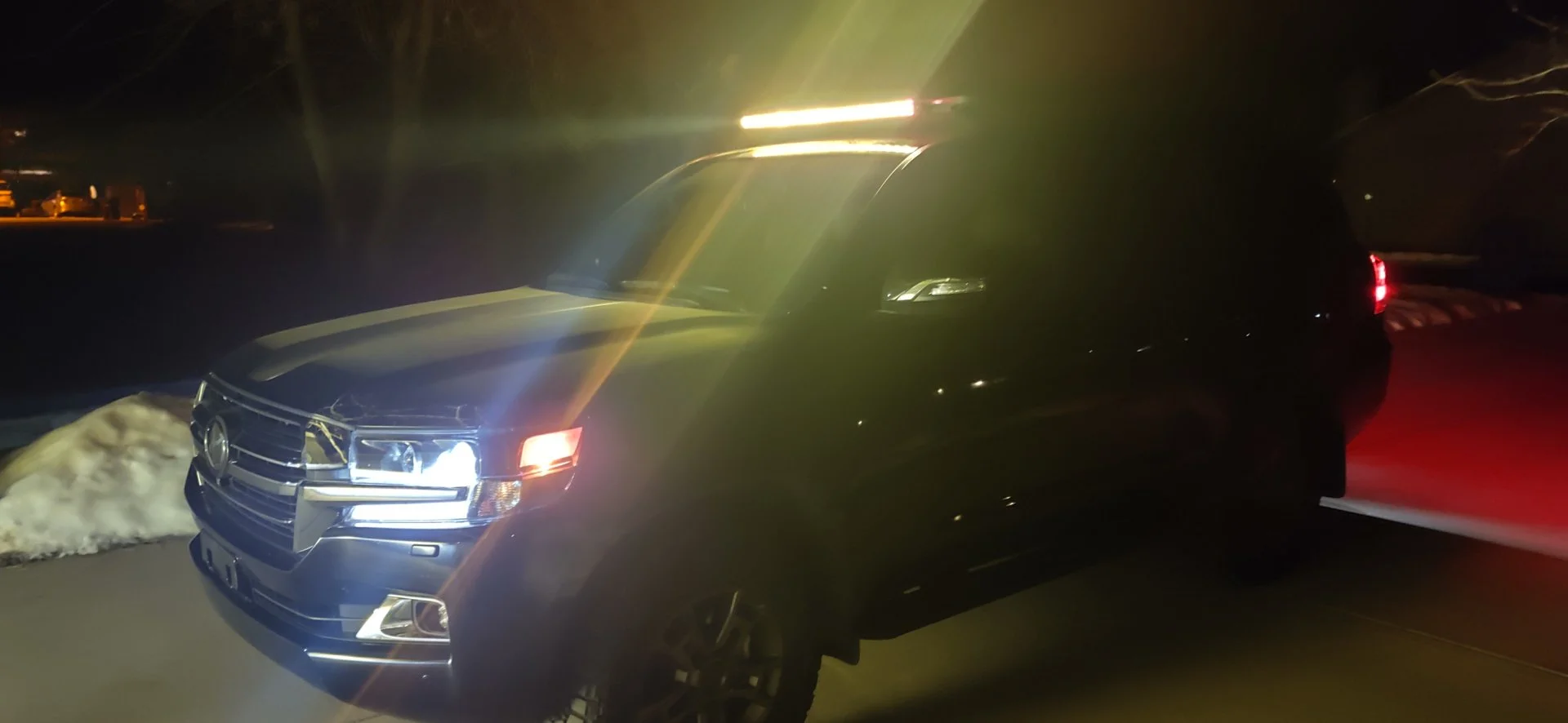

Photo #3: lightbar w/ Amber covers and Baja Squadron Pro driving lights turned on together.
The lightbar does not put any noticable or annoying glare on to the hood from the driver's seat
Plenty of light for where I drive on and off road.

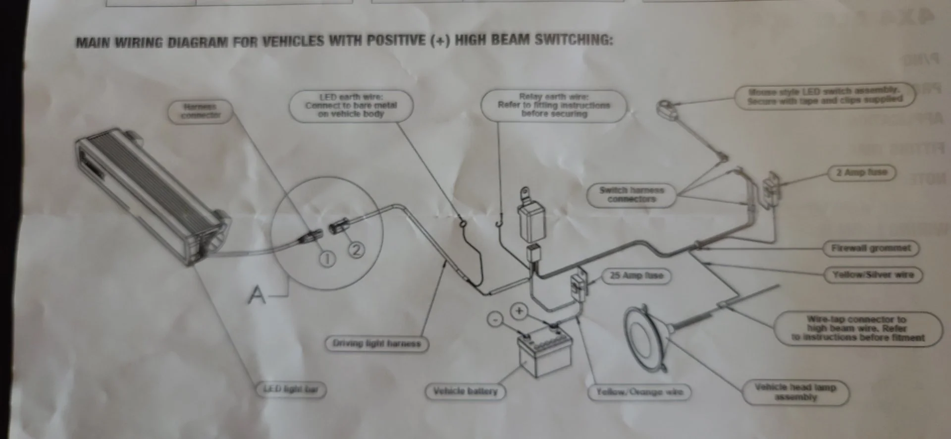

FYI: I purchased the recommended ARB wireloom and one wire loom extension. One extension did not reach the battery. Thankfully, the mechanic was able to build the required additional extension with not to much trouble.

Here is the ARB schematic for wiring. We installed an aftermarket switch on the dash in lieu of using the provided ARB switch.
