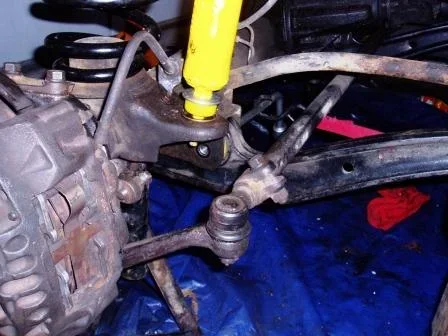

With body and rear axle bolts in, front was way off.
Took it out to check bushing locations, looked good. So, put front axle in first then tried to get to rear. Still off. P1010082.JPG
Managed to get the lug wrench in and strapped it rear pumper and racheted to torque the holes together. P1010084.JPG
BINGO!
