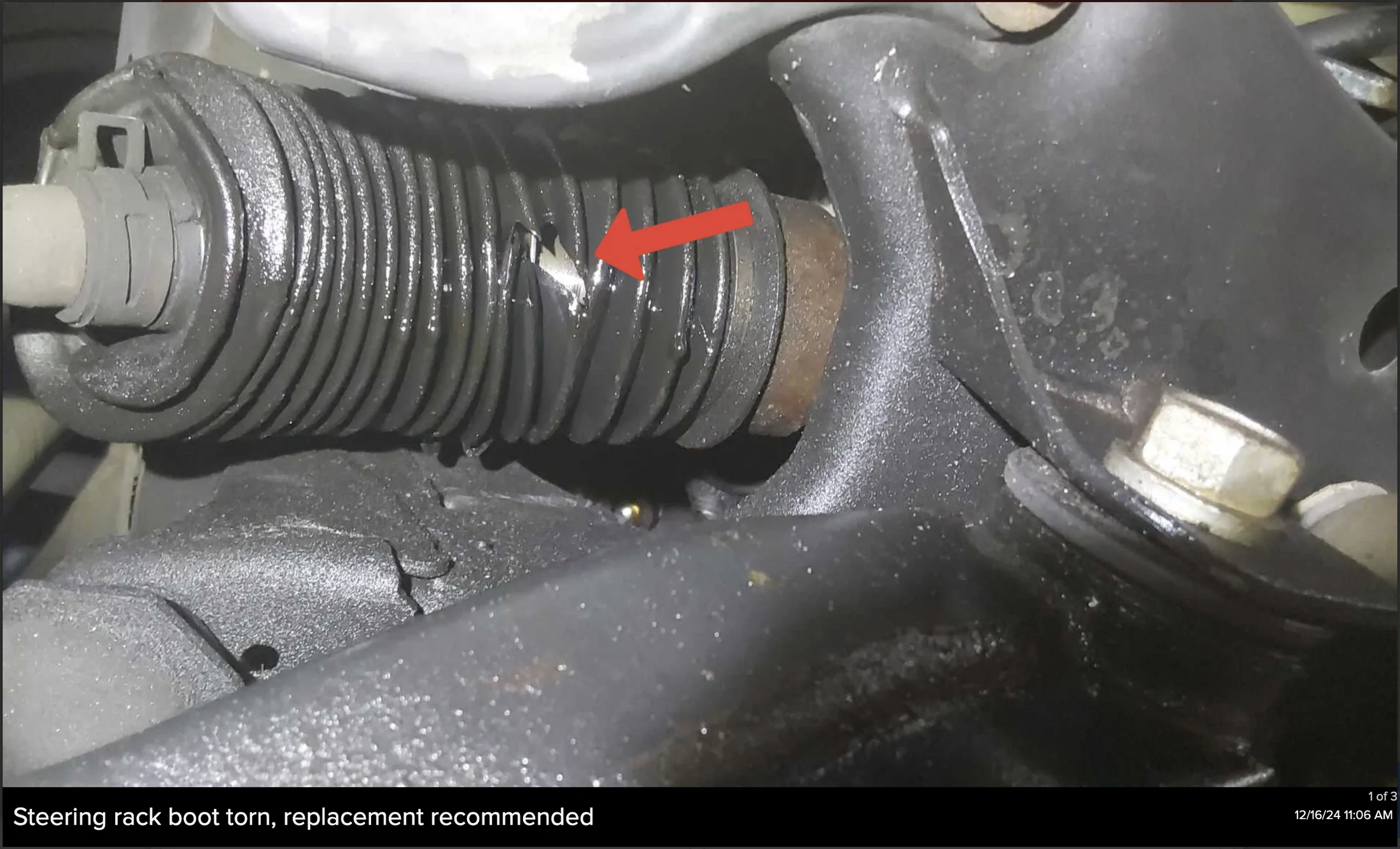

Problem 2: Steering Gear/Rack
- Report says "steering rack boots torn, steering gear or rack leaking, inner/outer tie rod damaged/free play"

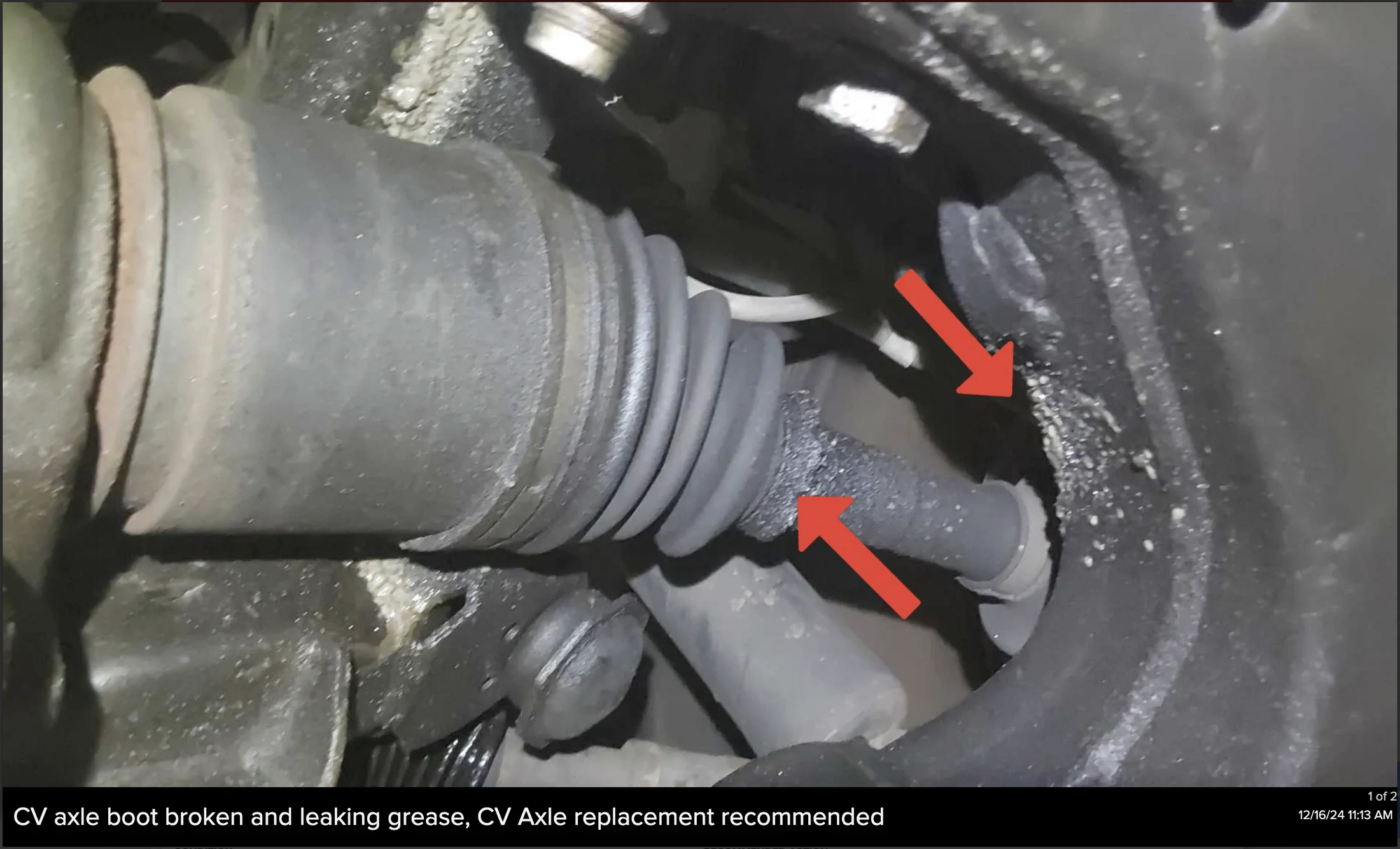

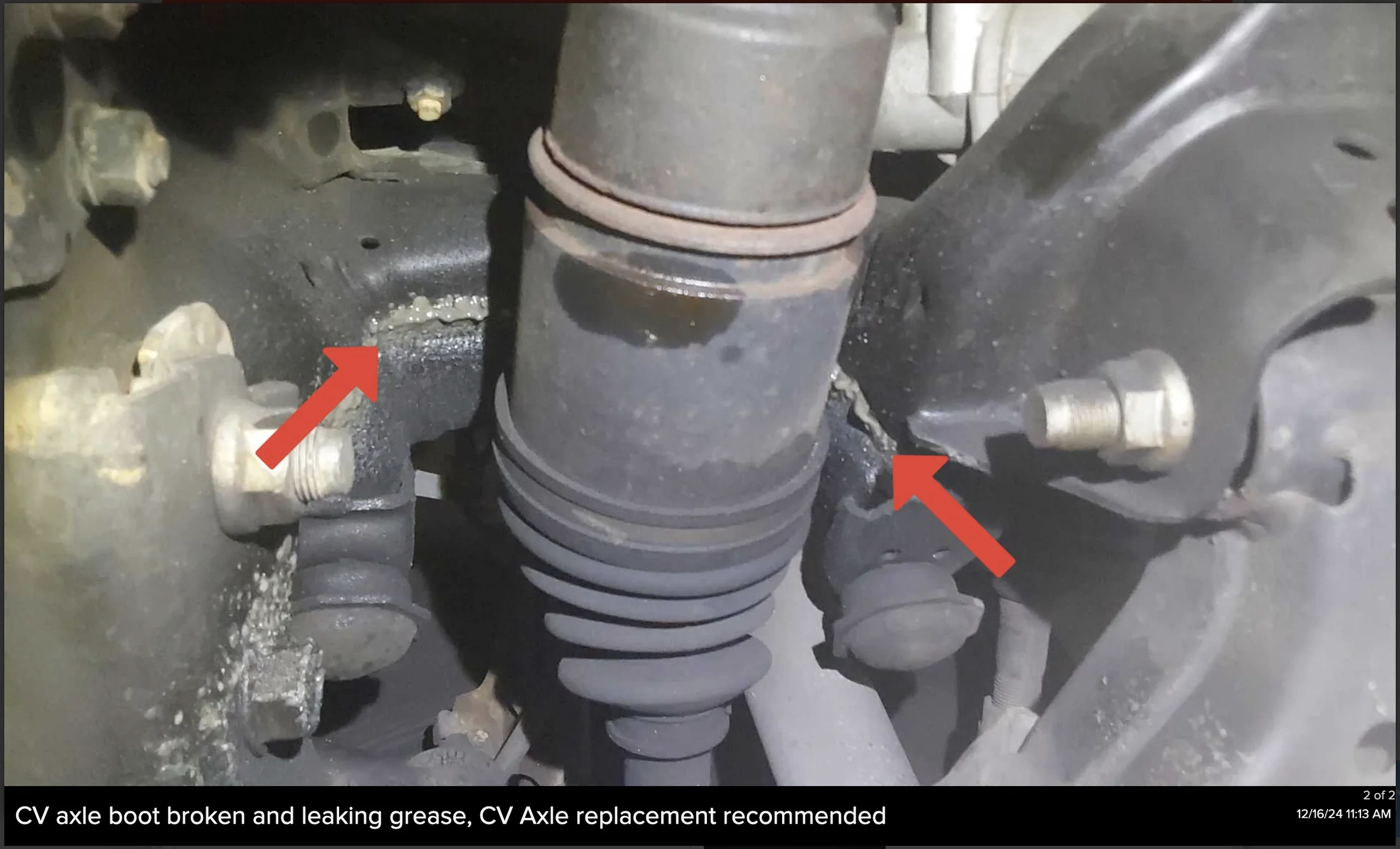

Problem 3: CV Axel Boots Torn
- Report says "CV axle boots broken and leaking grease"
- They suggested replacing the CV axel. Is this needed or would a simple boots replacement be enough

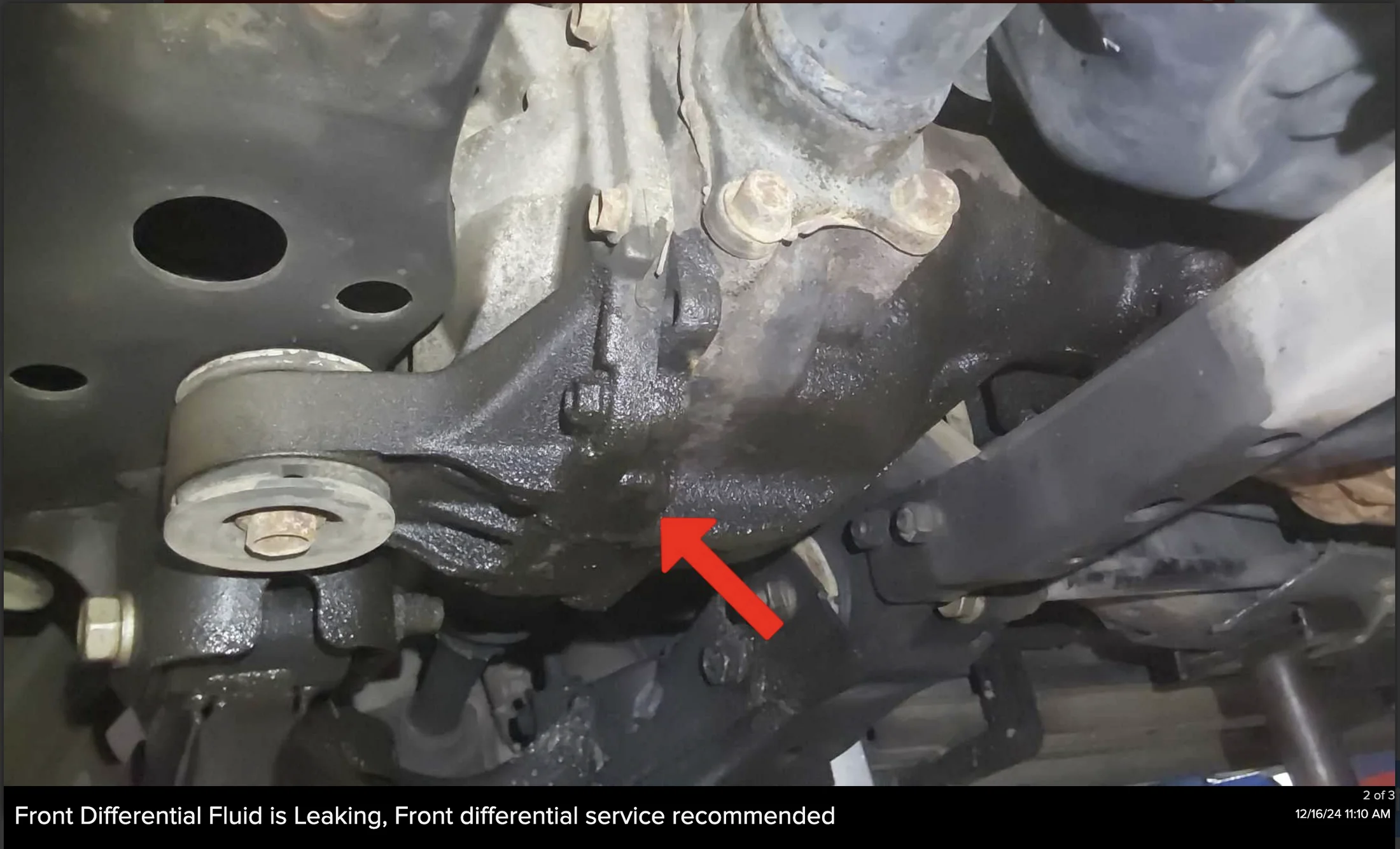

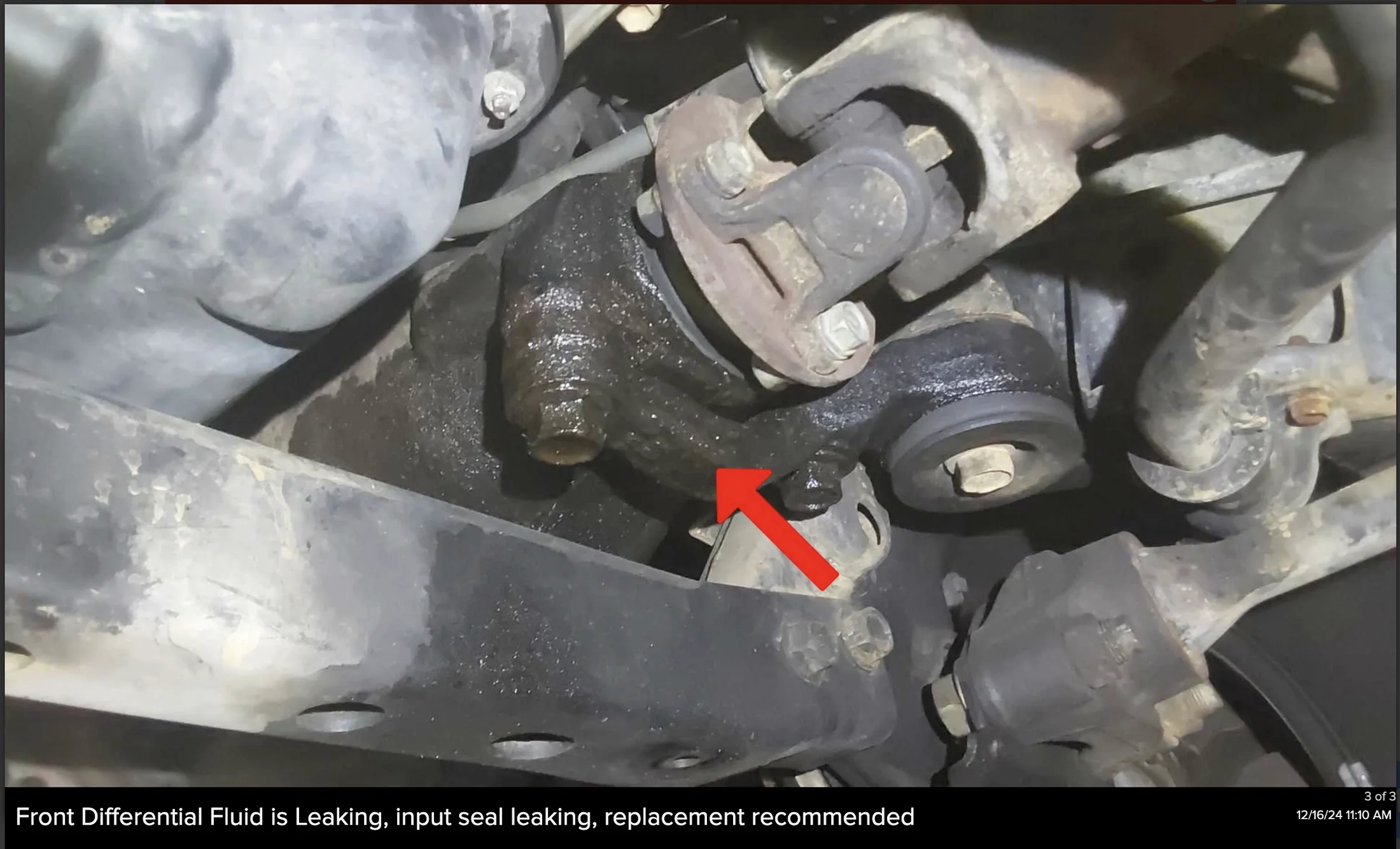

Problem 4: Front Differential Leaking
- Report says "front differential fluid is leaking, input seal leaking, replacement recommended"

The Steering rack should be addressed ASAP. You may be able to get by with just fixing the bellows and kicking the can down the road a bit longer.
The CV axles will also need to be addressed, but that is something that can wait a while
Same with the front Diff seal, you can put that off for longer as long as you keep an eye on the fluid level.

I'd make sure the diff leak isn't from above, does the fluid smell like gear oil?

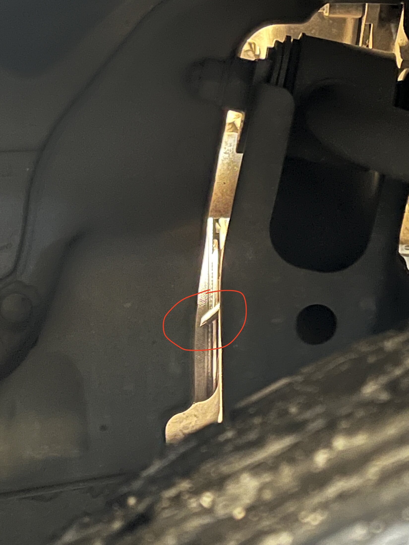

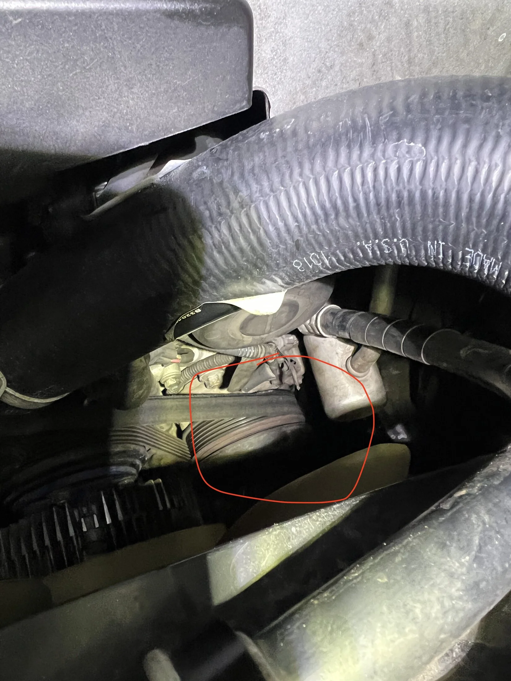

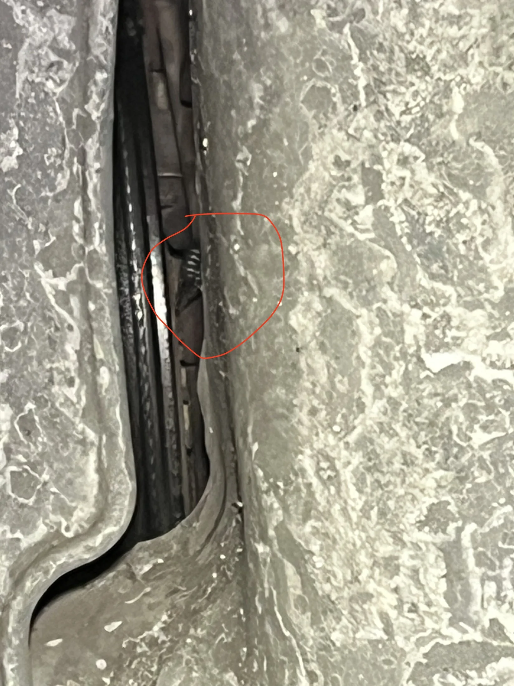

Speaking of belts, here is something interesting I found earlier. Might not be related to the "knocking" but pretty curious what this is?
From driver-side front wheel well, with lights shining from engine bay, you can see the screw
I pointed it out to a mechanic during oil change, and he pushed it in with a long rod and said it should be fine. Here is the same angle after. Not sure if this is the screw or something else
The nail could also be seen from the engine bay. Here is roughly where it was (I believe)
