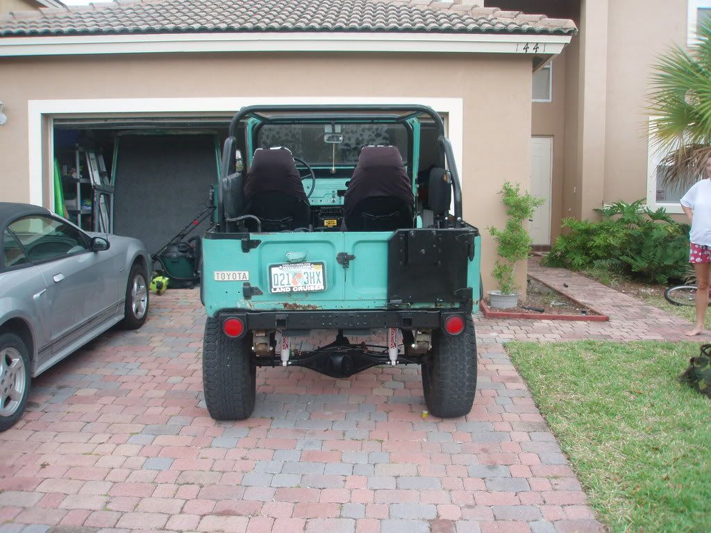

So I bought a 1965 FJ 40 but my problem is it i can't drive it further then 15 minutes without it getting ridiculously hot inside the cabin. I think the headers run pretty hot and there's two black hoses that run through a little box in the front of the cabin. A lot of heat gets flown through this box, and it's placed just a few inches from the driver side area.
My question is how do you guys direct the heat from your headers? Or better yet, what am i supposed to tell the cruiser mechanic in my area that i need to get done to the machine so the heat dissipates correctly :/
Sorry for having such newbiish vocab but not sure of all the terms and what not.
You can see the little box in this photo, it has the yellow sticker on it.. In the center of the console
http://i169.photobucket.com/albums/u211/65fj40/P3230003.jpg

Heater hose back of the engine coming out of the head. Does it have a little valve on it? If so cut it off in the summer.
I have seen some people use shields, header wrap or having the headers coated.

I'm not falling for this one.:beer:
You had no problem getting it open in this pic?

I'm Confused.
ARE YOU SURE THE HEATER ISN'T ON?
I'm with this guy... in the original post you were asking what the box is with the autometer sticker on it... thats the Heater!!!! I bet your heater is on and thats why it's getting hot in there! you don't have to cut anything or block anything.. just turn the damn thing off!
