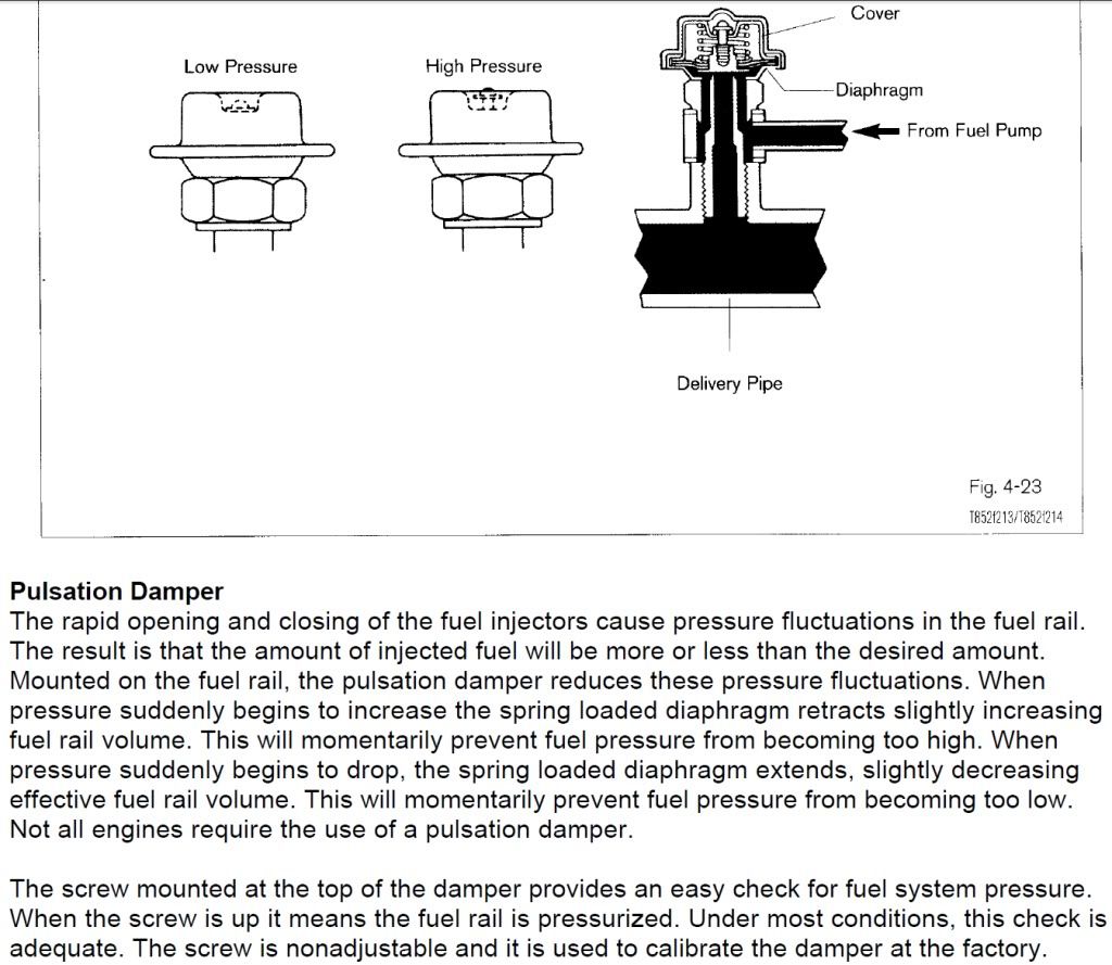

Anyone know about the pulsation damper? I know it's supposed to pop up, but wondering if that screw preloads the spring and adjusts the pressure, or just engages the diaphragm and holds it all together. It's just acts like an anti water hammer deal in home plumbing right?

the screw is nonadjustable and it is used to calibrate the damper at the factory.
That pretty well answers that, looks like I'm buying a new one. Exactly the info I needed though, thanks!
