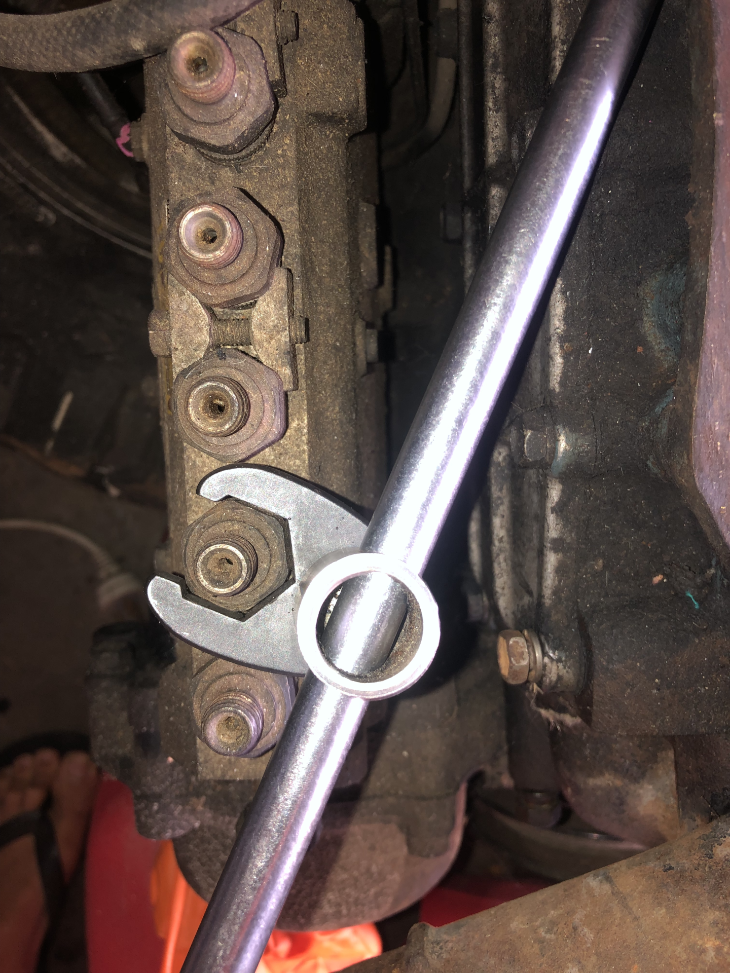

A 22mm crow foot with perpendicular breaker bar can hold the injector pump nuts still, if removing the hard fuel lines. It can fit behind the injector pump.

Here is a mock up example on a cooked 2h I picked up. The arm can lever against either the block or upper arm of the water pump housing. You can still access the 17mm hard line from the outer side of the pump.
At least it works for the the first 3 injector pump nuts which are too close together to get a spanner on them. I have pulled apart 3 x 2h's and all them the injector lines are virtually welded to the pump outlets, the little clamps which hold the cog wheels don't hold enough and are easy to mar.
