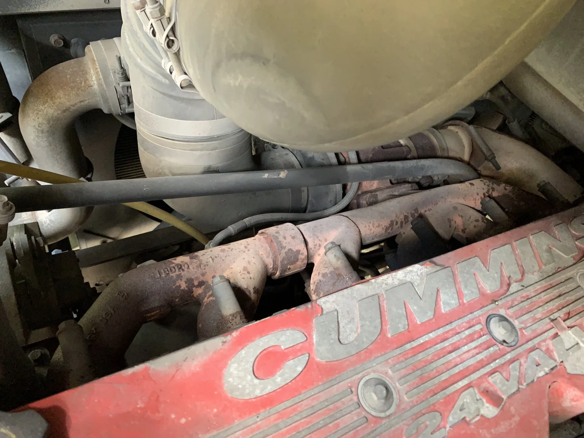

I'd recommend a can of Kroil over the other sprays for a job where you don't want to drill. I also own the Mini-Ductor II MD-700 although it was only $350 back in the summer of 2019.
I had a situation where I had an exhaust manifold that broke in half. Cummins wanted $4K to change it mostly because they expected a number of broken bolts based on past experience.
I have to say it worked great. It will turn the bolts red. None of my bolts broke on a 20 year old turbo diesel Cummins engine. Granted, I took my time and was spraying those bolts with Kroil every day for over a week before trying to turn them.
My only complaint is the MD-700 is a bit long to fit in tight places but some of the heating elements have a 90 degree bend. I bought their Essential Coil Kit and just found the coil that worked. I think you can bend the really long coil if needed.
It would have been nice had it been gun shaped like your last two Amazon links but I'm not sure it's worth the extra money.
