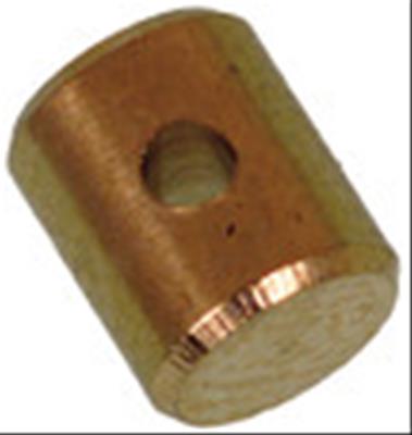

The cable that isn't attached to the Throttle Body is the Throttle Cable (Transmission). Looking at the one photo in Post #2 above (out of focus) it appears that the cylindrical lug ("barrel nipple") at the end of the cable is missing (fell off/pulled out). That small lug/nipple is what attaches the cable to the Throttle Body.
The Transmission Throttle cable is NLA so your only options would be finding a used cable or repair what you got.

Here's a link to various methods to repair the end of the cable.
Here's one method:
And another:
Photo showing the lug (barrel nipple) at the end of the cable:
