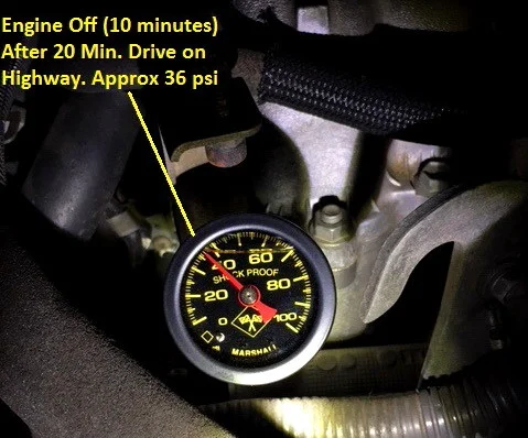

Normally, when the vehicle is first shut off....the fuel pressure gauge will show about 35 lbs of pressure for at least 30 minutes. It is currently showing nothing.

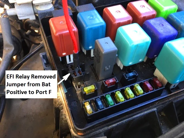

Well....now things have changed. Looked at it again this morning (cold here) and the security light NOW does not go off when the key is inserted or when cranking. So will jumper from battery to port 'F' later on and see. You might getting a PM for an immobilizer bypass kit.

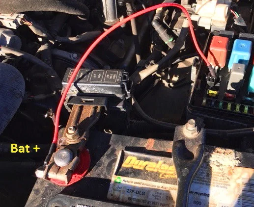

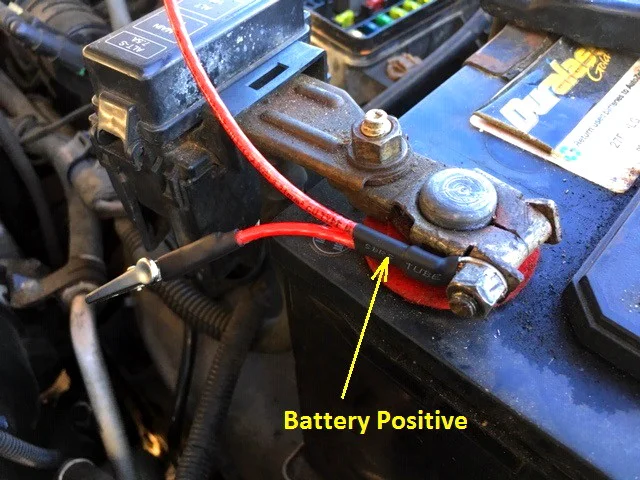

Update:

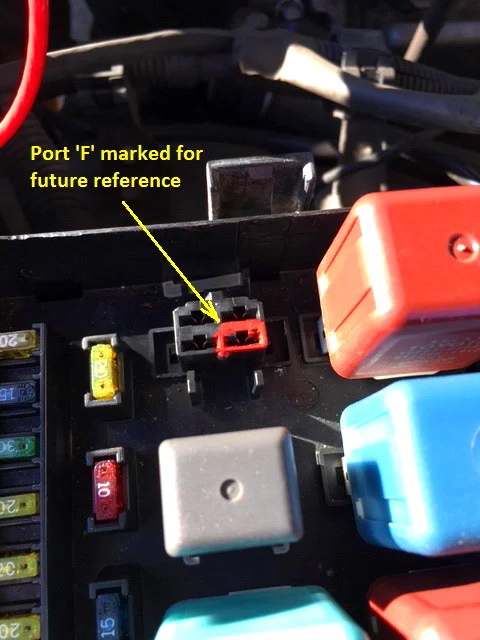

Made a jumper and ran it from the Battery Positive to the 'F' port on the Fuse Box (EFI relay removed) and the vehicle started right up.
Tested the EFI relay and it checked out OK (per the FSM), though relays can be 'weak' and still pass the FSM test.
So looks like the issue is with my Fuse Box though the top side looks good. Immobilizer Bypass is probably going to be my answer.
Presumably....I can leave my 'Jumper' in place to start and run the vehicle until my Bypass arrives? Yes/No?
It is okay to drive with jumper as long as you understand the risk of no fuse protection. I would disconnect it when the engine is not running because it will drain your battery.
You may want to throw a fuse in the line. I'd not drive in rain either, as best to keep water out of box.

I was also able to start and run mine by running a jumper wire from Battery + to the 'F' port of the fusebox after removing the EFI relay. So...able to use the vehicle while waiting on the kit to arrive.

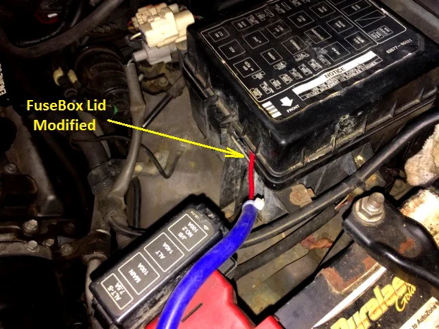

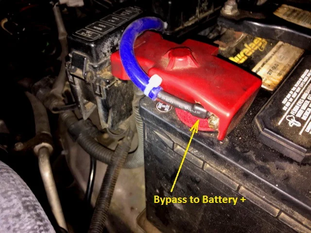

One note after installing the Bypass kit. IF you plan to leave it installed long term....it would be wise to attempt to tuck it under the fuse box lid. Different year models have slightly different arrangements for fuse/relay positions. In my case... there was just barely enough room to push the bypass kit down around the side of the relays.
My kit would not fire the engine because of the 'A' terminal on my EFI fuse slot being the problem. The solution for that is to run a jumper from the kit to the Battery + post. IF you have to do that....then you can cut a small window in the fuse-box lid and housing to accommodate the wire. Be sure to insulate the wire so it doesn't wear through and cause a dead short right off the battery (VERY BAD).
After having done the above....I was able to reinstall the top to my fuse box. I don't think leaving it off and having the fuses/relays exposed is a good thing long term.
