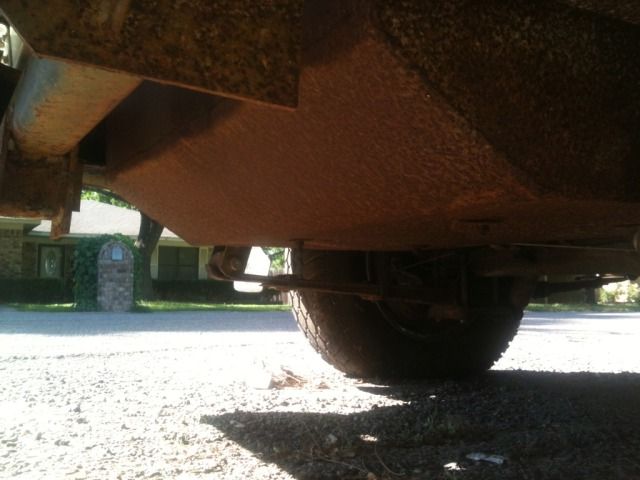

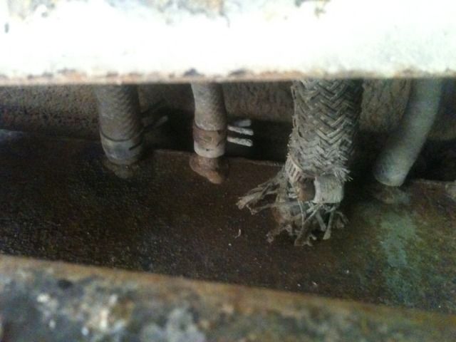

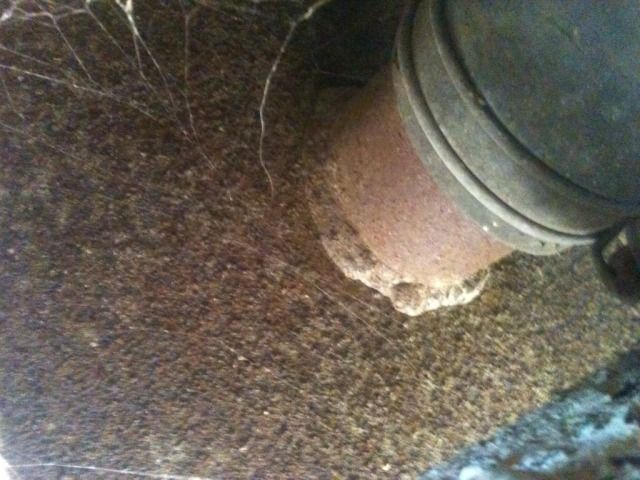

Ok so my new to me FJ 60 has several upgrades including this extended range tank. Wondering if any one can ID this tank. There are four 3/8" bolts protruding from the bottom of it in about an 18" square pattern. At first this made me think it was just a skid plate for the tank. After looking closer I can see that the filler neck and the fuel/vent lines are connected directly to fittings that are welded into the top of the passenger side tank wall. I have done a fair amount of searching and have come up with nothing that is similar to this tank. Any info would be great thanks.

Seems to sit too low to be the AUS/ Man-A-Fre style.. Maybe SOR or ?? not really sure.

I have the same tank. I bought it from a Mud member in the classified it had never been installed. I believe he said it was from MAN-$-FEE. It didn't line up to any reasonable mounting positions and turned in to a major PITA to install. If I'm correct these were the first ones that they started to "try" and manufacture in the US and gave up. Overall the design is good the bolts you see on the bottom of the tank are likely bolted thru the structural baffles and don't hold the tank in place but who knows.
