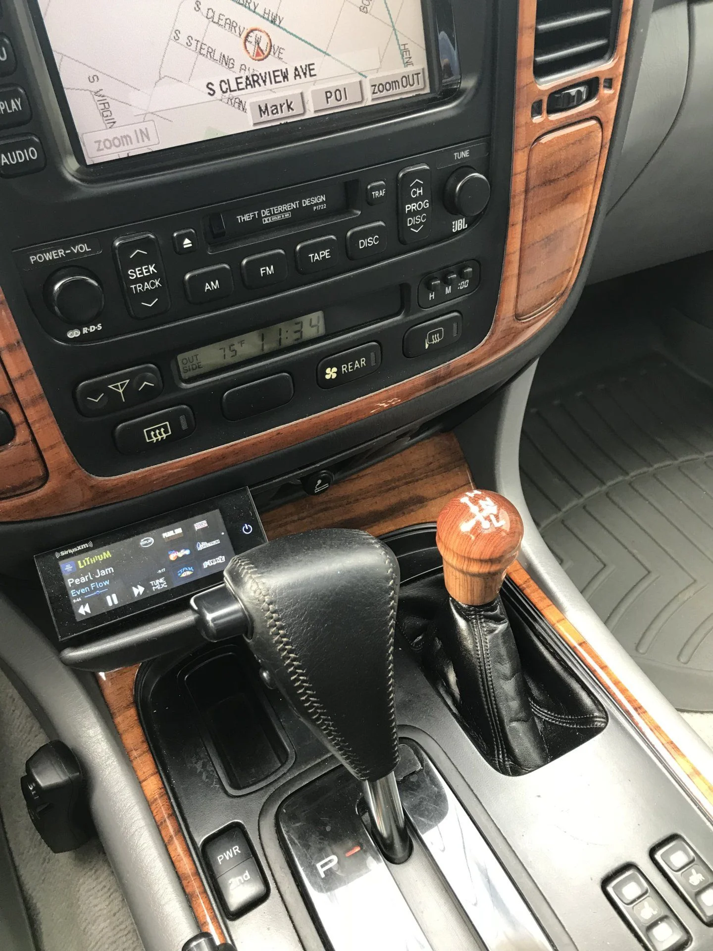

How?View attachment 1881516 I added Sirius XM without deleting nav or adding the BT45 module.
