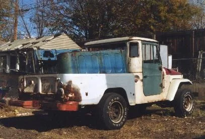

    Also, just to bring you guys up to speed- and yes I do need to do a project thread... this thing was found behind a factory in Goshen, IN. its a 64 short bed, fixed top 45. The bed was hand fabricated (in the late 70s) to attempt to duplicate the original bed that was trashed. The cab was mostly intact, except for rusting out at the usual places.... ie. beneath the doors and at the lower cab corners, top of the fenders. It had the original F, 3 speed on the tree, no lift, etc. when I got it.
    I have completely disassembled it since then. The roof panel is stripped in preparation for repainting. The fenders went to some guy in CA. The drivetrain is underneath the workbench.
    I bobbed the bed by 14" because I didn't like the amount of rear overhang. I bobbed the frame to match. I'm nearly finished with a 383 small block Chevy, internal balance with 6" rods, roller cam, to go in it. I have the SM465, NP203 reduction box and NP205 for the rest of the powertrain. I have a centered rear diff housing from Profitts Cruisers to match the output on the 205. Front axle has Longfields and will soon have 6 stud knuckles from Marlin (when they come out). ARBs front and rear, 4.56:1 gears. Scout steering box. Spring over and shackle reversal. Front axle is cut but not turned. Longs beadlock kits in box under work bench, to be assembled later in project. Likely going with 38.5" Swamper SXs. Roll cage similar to MetalTechs profile cage, with kickers that would go down to the rear fender wells in the bed. (And yes, that complicates roof options). Maybe a custom made softtop. MetalTech tube fenders. MetalTech nose guard/ stinger.
    My goal is to have something that no- one else has. A streetable and crawlable 45- except with 450 horsepower. ;)
    Things left to decide.... to chop the top or not. I think I could make it into a removable top using a reproduction rear cab panel and the fasteners to hold it down, if I ever wanted to. (haven't figured out the roll cage, yet.)
    So...........maybe posting my plans in the 45 owners group area marks me for great ridicule, since there's very little about the truck that will remain at Toyota built it.... but if there is someone that wants this cab for their project and they are either willing to pay me enough to purchase something else or trade me a removable top cab in similar condition, I won't cut the top off....
    Anyway, that's my plan, however halfbaked it might be.
