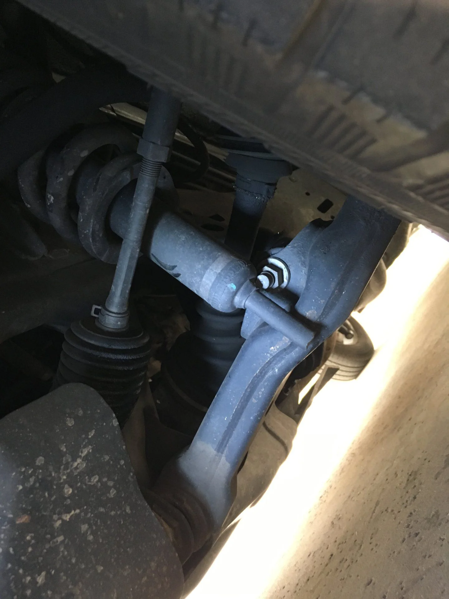

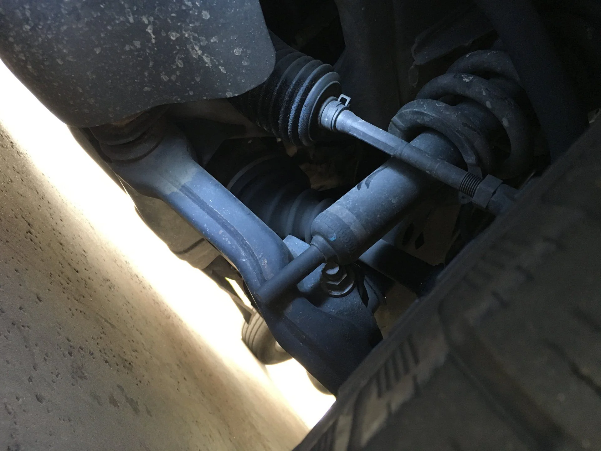

it happened in normal highway driving at a bridge concrete expansion joint (not a bump at all) - HUGE "plonk" sound as if a brick had hit the sheet metal :eek:
the GX was multi-point inspected less than 500 miles ago by the dealer where it has been serviced its entire life - service advisor today said he had never seen or heard of this happening
hey, I really can mangle anything . . . :doh: :hillbilly:

no spacer
That's nuts.
Could you take a pic of the break / the end of the shaft? Curious to know if there was any rust there (from a small, older crack maybe)...or if its all shiny.

dang, is that a stock part? What mileage I'm curious, not that it matters
174k miles on the truck, didn't get a good look at the surface of the broken part.
I put the vehicle on a jack, and got the shaft to settle inboards next to the mounting bolt in a 'pocket' on the A-arm, installed a strap to hold the last winding of the coil down to the A-arm, and limped it to the dealership. Driving in that condition, I couldn't feel that there was anything wrong with the vehicle. Lexus dealer rep said they've never encountered a broken strut.

Negative, nice and smooth, slight lean to the driver's side. The leftover 'pin' of the strut rested fairly solidly on the lower A-arm, in some sort of pocket about an inch deep. As far inboards as that was it would have taken a fair amount of articulation at the tire for that pin to come free. And Scottsdale streets are fairly smooth...
