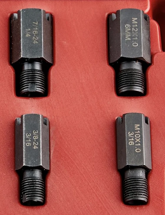

You can try cleaning up threads with a threads chase. Try chase (by hand only) on good flare nut, for fitment. If only damaged first few threads in master. Then you've a chance it will hold torque, once master threads chased. But it sound like you ran all the way in, likely damaging to many threads. Which you can not run a chase in all the way, do to male flare tip (cone) within.
If threads of flare nut are damaged. Replace that brake line pipe. It may also be possible, to replace just that flare nut. But make sure to use a metric flaring kit.
I have never done a flare capture thread repair. But it is possible. Google it. You'll see a flare insert.

If you do use a tap to chase the threads, grind out a relief in the end of the tap with a dremel and small round stone or diamond tip for clearance of the internal flare cone in the bore. This will gain you a little more tap depth.
Thank you @badlander! Makes sense. I was looking and they’re wondering how to handle that😅
Or blunt tip thread chase.
